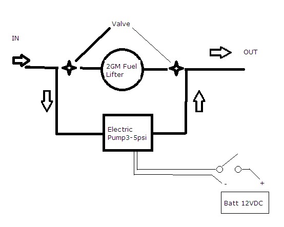

Electrical fuel pumps! First I recommend you determine the output from your existing fuel pumps flow(PSI) rate is before adding an electric fuel pump in. If the fuel pump calls for 5PSI then the pump should be rated 5PSI and not less then. Problem is, that most pumps have a range of 3-5PSI and some 4-6psi and etc. at a minimum you want what Yanmar specs call for as a PSI pressure for the engine. So this means you can not just put in a 10psi and hope this works properly and will not oversupply fuel to the high pressure pump for injectors. So really the fuel LIFTER is as it states.. Just making sure the fuel is there and available at LOW pressure for the high pressure pumps. Hope this helps! Capt. Rob
352
Pearson P303 #221 RockPort Maine
i have the electric pump too....i only run it when i am bleeding the system....reason why is if you break the diafram in the mechanical pump it will pull fuel in the the crank case and could cause a runaway ...the mechanical pump will pull the fuel through the electric just fine
Woodster! Good idea, What is the pump your using for this? Type, Brand, PSI rate, costs etc.. Thanks Capt Rob

Are there any other reasons (beside facilitating bleeding the system) to install an electric pump for a 3GM30F Yanmar. I have a friend with a new-to-him boat that has one, and he was told to run the electric fuel pump all the time.
If you ran the electric pump all the time while running the engine, and it blew the diaphragm in the lift pump on the engine, what would the symptoms be (if any) during engine operation?
you could have a runaway engine if it pumped enough fuel in the crankcase
