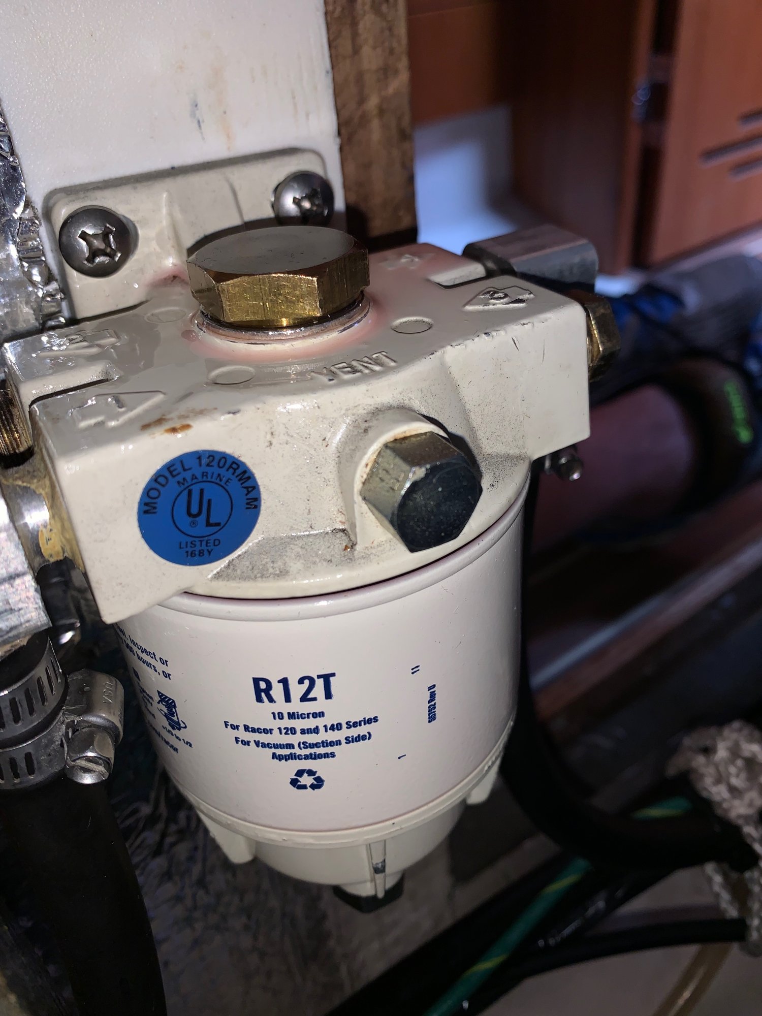

Went back to the primary, which is a Racor 120RMAM with a R12T screwed into it. There's a little puddle under it, which maybe I didn't clean up when I changed the filter? Wait: there's fuel on top of the filter around the "head bolt" which screws into the filter:
I wiped this down (I think I did last time, but...) and it keeps seeping out. Did it a few times: still seeping. You can see the red in the photo. So at this point, I'm thinking: if fuel is getting out, air is getting in. Here's the head bolt:

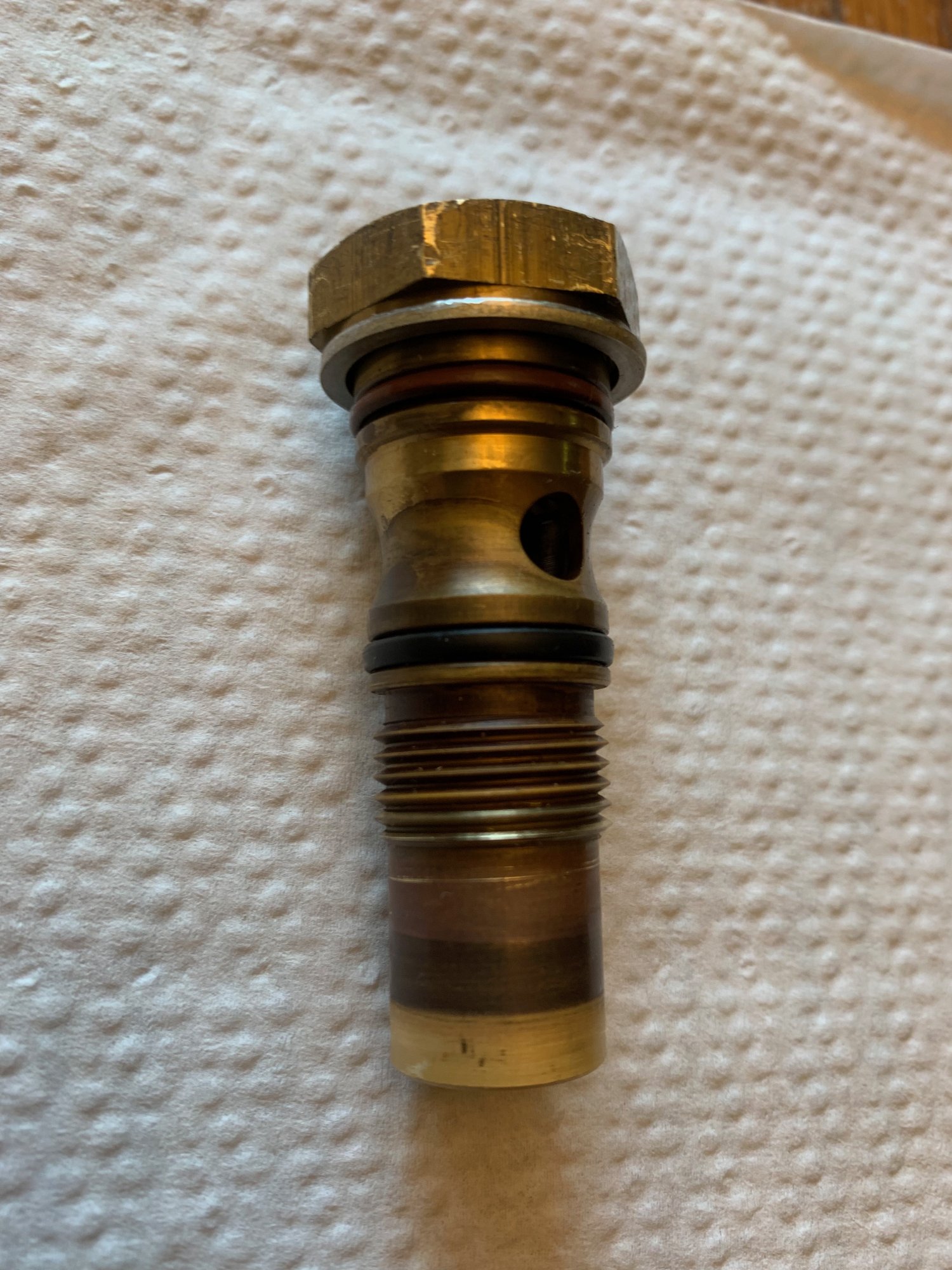

So it's got a couple of o-rings and a metal washer, none of which are spec'd by Racor separately. I ordered a kit that I think (?) will contain these, but not from Racor.

Your filter body doesn't match the Racor 120RMAM series.
But that aside, any time you find an external fuel leak, it's a good chance for air to enter and the centre bolt looks to be a good source of air with the flattened O rings.
Can't really see what purpose the bolt serves other than being a R12T filter by-pass in a tight situation. I imagine the head of the bolt has an arrow on it ?

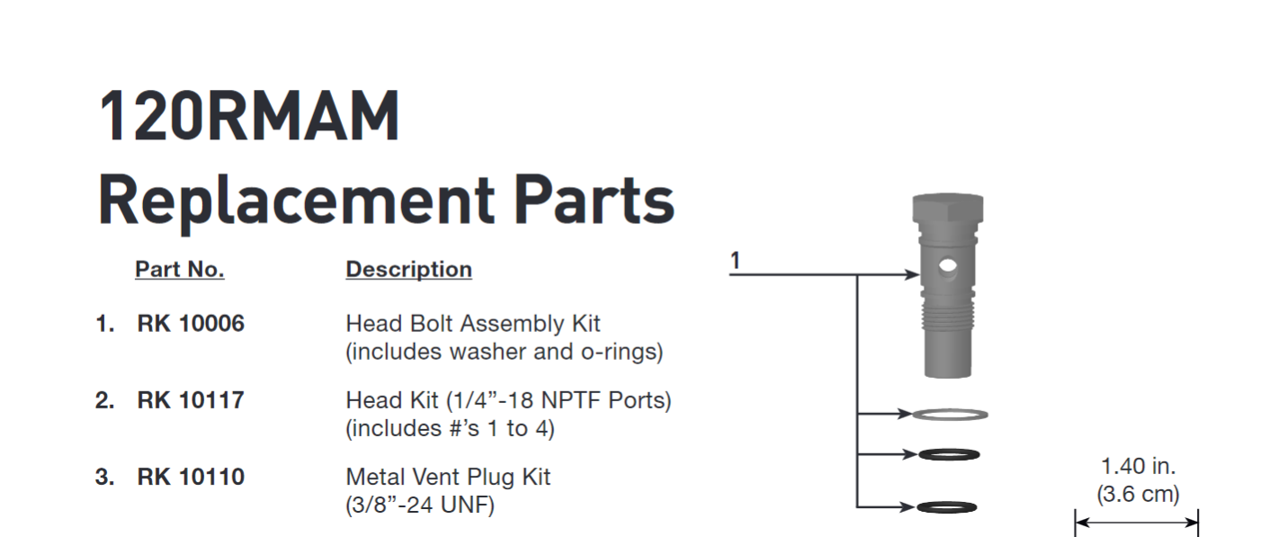

Ralph, I think (by what I'm seeing online) that the 120RMAM was replaced by the 120RMAM2, which no longer has the bolt. That's probably what they mean by "series". The part we have seems to agree well with the one at this link:
I suspect the main point of the bolt is that it makes it easier to get the filter off (vs. just spinning it off the top part). Clearly, they've done away with it in later models, maybe b/c it's another point of failure. Although it's worked perfectly for 18 years, so no complaint from me. No arrow on the bolt. I think the holes don't have to line up with anything.
It actually looks like the kit I ordered
is probably a Racor product.

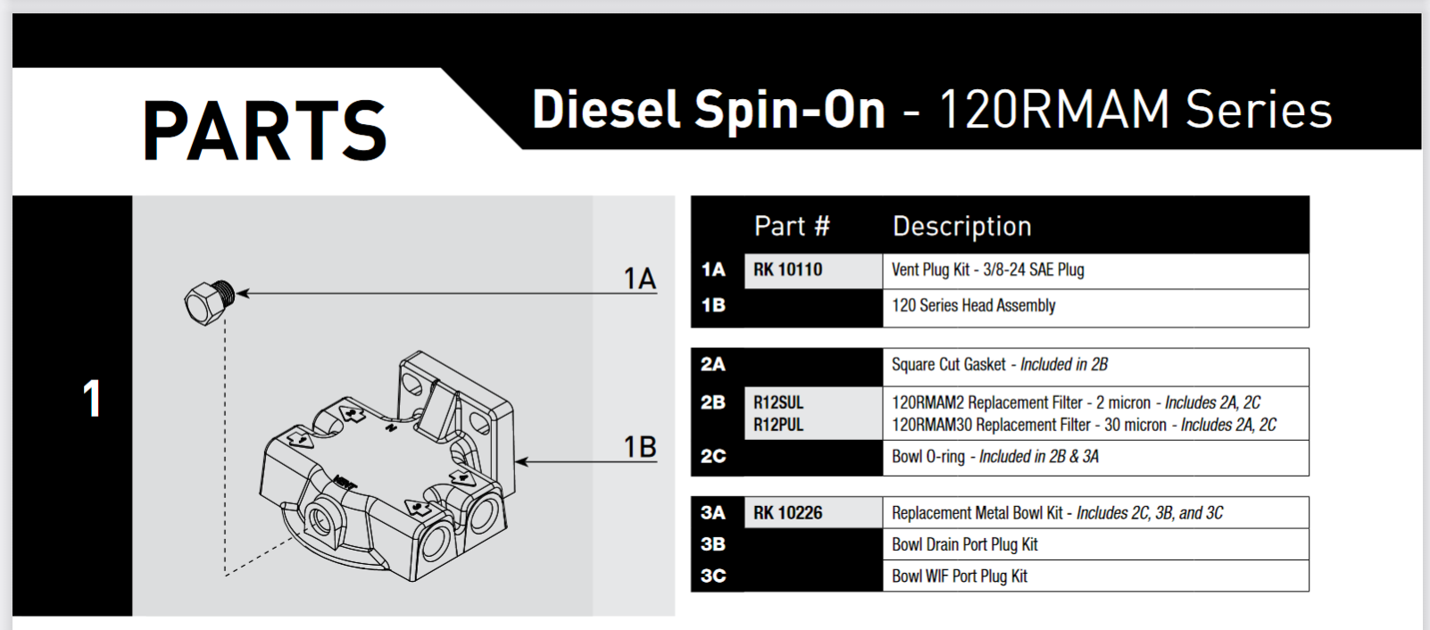

I'm with you so far but I've got to know the purpose of the through hole in the bolt. As you say, no arrow on the bolt and if it IS a filter bypass, you could easily be passing dirty fuel on to your primary fuel filter without knowing it.
When looking at the above drawing, I become even more confused as there's no 120RMAM2 just the original 120RMAM. The centre bolt makes no sense other than it's purpose is to catch the centre threads of the spin on R12T fuel filter. The hole through the centre bolt must have a use, but it remains a mystery to me.
I seethe steel washer is shown in the Racor drawing so I guess it best to replace it when the kit arrives.
In the end, all that's important is that this thing filters the fuel and doesn't leak. One can only ignore the why's and how's of how the filter works. It's not for us mere mortals to know.

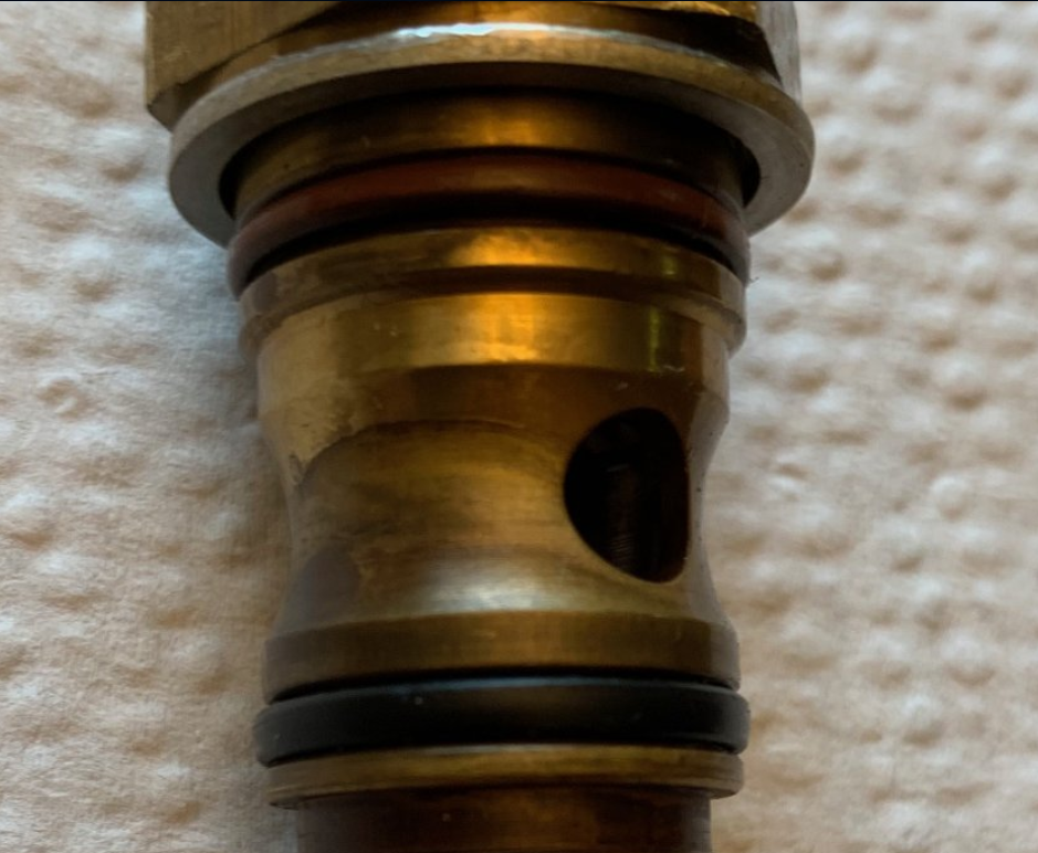

As for the hole in the "head bolt": it seems pretty clear that the top cap is divided into 2 chambers. The inlet chamber diverts fuel from the tank to the outside of the filter and to the bowl on the bottom (to let water settle and separate), while the outlet chamber has to have a way to get fuel from the center of the R12T filter. The hollow head bolt is that path: it screws into the center of the filter and guides fuel up and through the holes (that have been bothering you), where the fuel flow passes into the outlet chamber and on to the outlet fuel hose. In the re-designed Racor 120RMAM-2, I would imagine this bolt has been replaced by a hollow tube that serves the same purpose. I'm guessing the only difference is that in the new design, you have to spin the filter (with attached bowl) onto this tube just as you would with the bolt, except that you can't screw the bolt down right at the end. They probably made the change to save money in the manufacturing, and to avoid the possibility of leaks around the bolt.

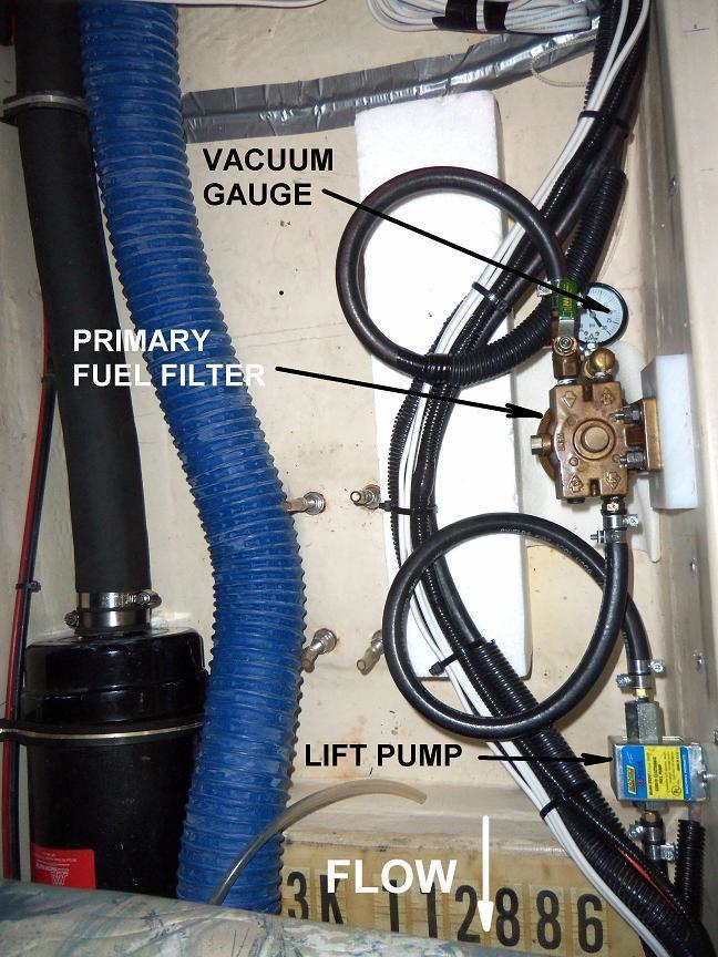

Not such a big deal, mine is a 24 YO boat. I changed out the fuel lines in the Nike shoe box about 5 years ago:
It gets bloody hot in there after the engine shuts down because the engine housing cooling fan shuts down at the same time. The hoses in there were hard and next they would be cracking. The hoses outside the Nike shoe box were in perfect condition because they were always cold as they lay on he hull. The only reason they were changed is because I was always looking for a better way to route them and change the filter to a more convenient location for a filter change.
