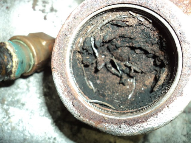

Our 2006 yanmar has about 500 hours on it and it suddenly has reduced power, can't get more than about 2000rpm , in the past a fouled prop has caused similar effect but the prop is clean.
We have checked the fuel filter on the engine and it looks clean. Are there any other filters hidden away ?
Any ideas out there please ...?
Oct 30, 2011
24
Catalina 309 Fort Myers
Mine did the same thing. The exhaust elbow got clogged with soot, probably due to idling a lot. Before you bother the valves, go to the exhaust port on the stern and feel the exhaust force with your hands. As someone increases throttle, you won't feel a lot more exhaust, indicating the engine is being restricted. I believe we just cleaned the elbow, but we may have replaced it.

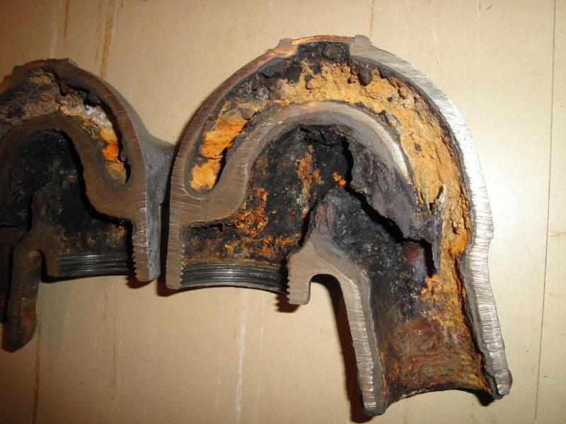

Yes. it is almost certainly the exhaust elbow. It make the valves rattle but this will go away as soon as you replace the exhaust elbow. Don't bother cleaning it - it will be totally fouled and full of rust. I got a new one and excellent advice from Minnards diesel people in Sydney. Make sure you get the bent elbow system as the engine is below the waterline. It is a little bit dirty but quite doable yourself - I did it recently.

Thanks for all the feed back , new elbow on order.
Is it normal for the problem to be sudden, I would of thought it would be a gradual thing as the outlet became more restricted over time .

Yes, mine also pretty suddenly clogged up. I also noticed black soot in the exhaust - particularly when I tried to add more power.
The diesel mechanic suggested that a major cause is lack of use.
By just idling out of the marina, and then the advantage of in-mast furling, we have sails up quickly and away. The reverse at the end of the day.
He reckons this very light use at relatively low revs encourages a build up in the diesel motor. He recommended a long relatively high speed long trip every month or so. But I have not done this - if you are on the boat - then sail it.
Also the 'bent elbow' system used on the Catalina looks like it encourages build up. I bought the wrong Yanmar outlet first up - it is a straight, slightly bent piece of stainless with a water inlet. It seems a much more efficient way to exhaust and would not clog up, also nice smooth stainless. However, the correct part for below waterline motors is a clunky thing of cast metal which you fit with a range of threaded fittings. All in all not a smooth removal of exhaust gas.

Well it was definitely the exhaust elbow, apparently they clog up in Sydney after about 6 years but as little as 3 years in warmer water.
The new one is still on order but just cleaning this one has got our revs back to 3500 rpm
