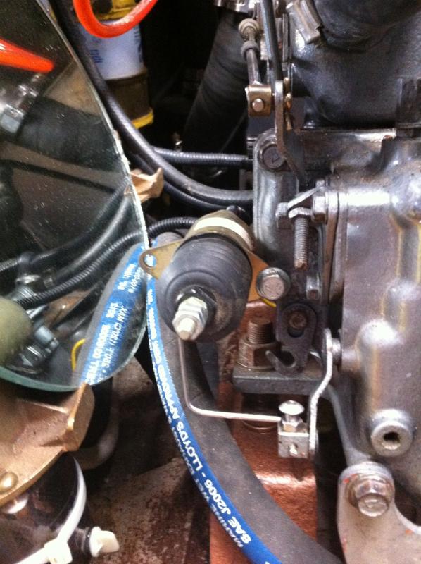

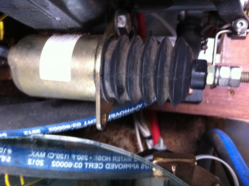

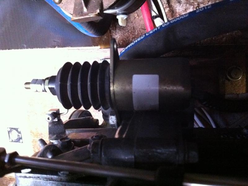

As promised......
google trombetta solenoid and you will find several models to choose from i dont have the model number of mine now but will try and get it some time to day and post it and also some pics of my set up
ok its a Trombetta model# P610-B5V12
and here are some pics...
i had to make a connecting wire link out of some 3/32 ss welding rod and bend it from the plunger to the fuel shut off lever and wire the system in to my electrical system going back to the engine panel ...the with wire is 10 ga....the red and black wire are 16ga...the red is live when you turn on the ignition switch...the white wire is hot only when you hit the stop button..and the black wire is a ground wire.....it works great

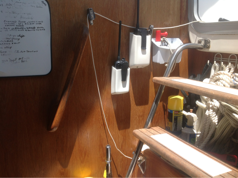

Here is a simple solution.sure helps when you are single handing.
Aug 6, 2006
49
Hunter Legend 37 Severna Park, MD
Sorry about leaving out the rest of the info. I tied a cord to the knob, ran it throu a block and took the cord out into the cockpit.this way anyone cap pull the cord when I need to stop the engine.
