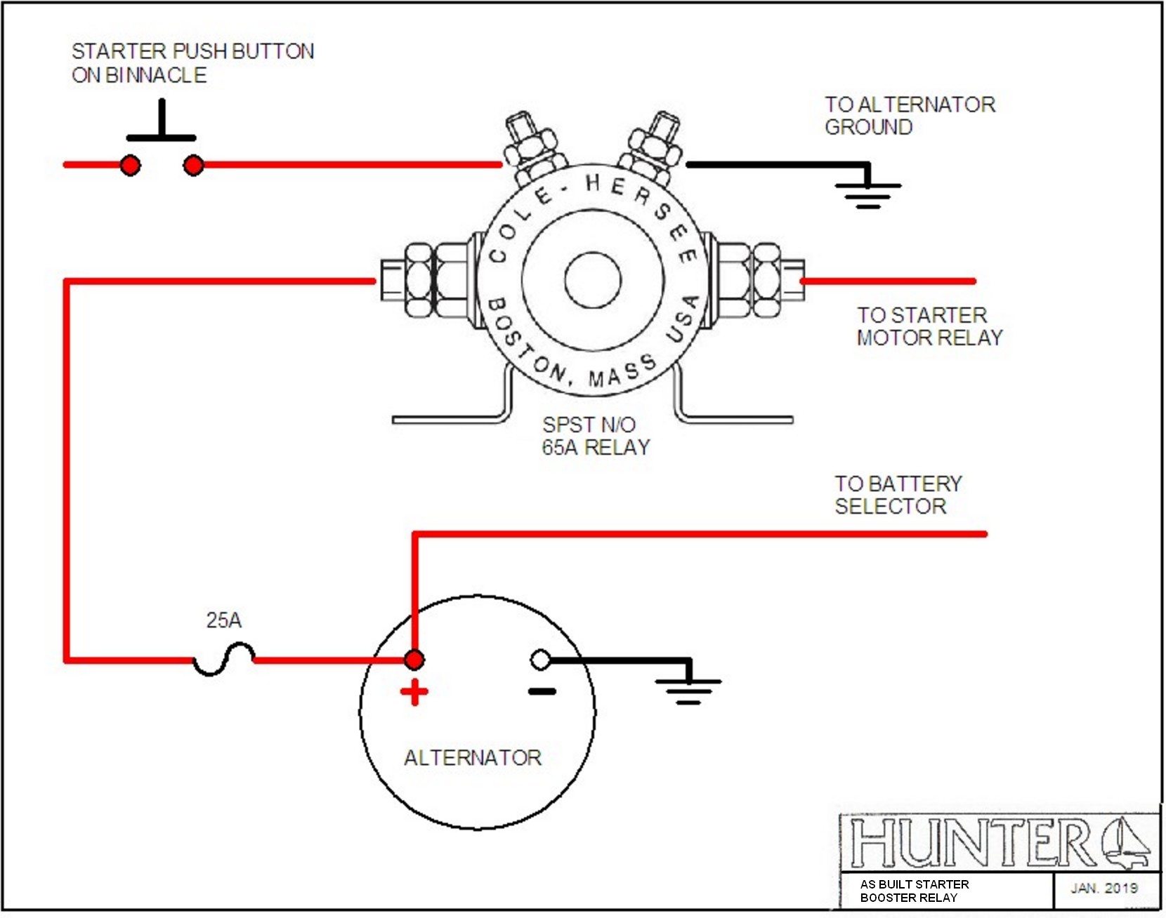

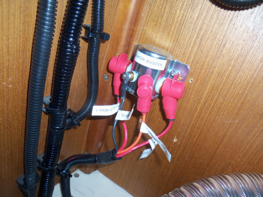

Like others have said this problem is well documented and easily fixed. you can start by cleaning all contacts but ultimately you really want to either install an additional relay like others have said/done, or upsize and upgrade the red wire and the white wire that go to and from the button and key switch to the starter motor. I did a Youtube video on what I did here:

Quick fix to Yanmar engine starting issue is the cable loom connectors. Clean the contacts with Contact Cleaner.
Longer term, wire an Emergency Start Button with shorter but beefer wires within the cabin, incorporating that relay unit shown by R.Johnstone. That's what I did for mine.
