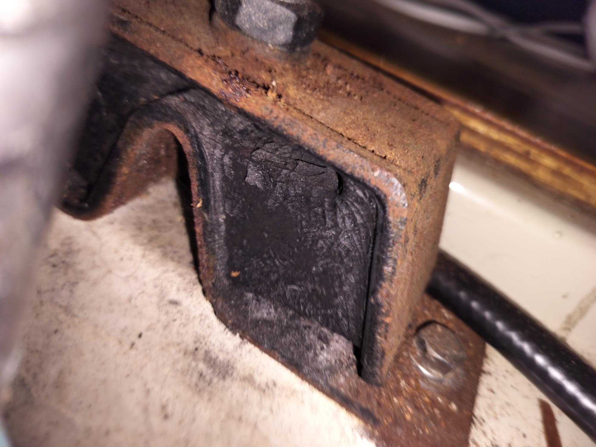

1994 Hunter Legend 40.5. All this got me looking at my Yanmar 4JH2E mounts. Obviously need to replace these. I have no vibration at either idle or at higher rpms, but they have obviously seen better days.
Looking closely at the stainless steel bolts that hold the mount to the stringer, what do those bolts thread into? Is there an embedded plate inside the stringer. I don't see any holes or access to insid the stringer to access a nut. Appreciate anyone with insights before starting this project. Will be ordering the kit from Ellebogen with 150# on one side and 200# on the other side.
I assume it is okay to replace these mounts while waterborne. Can they be replaced without disconnecting the I have a PSS if that makes any difference. Any precautions related to that aspect would be appreciated.

- To Smokey 73: Ellebogen has a video showing replacement while in the water. You could check it out on their website (Blog EN - Ellebogen). As for the bolts holding the mount to the stringer, I seem to recall that on my boat they were 4 & 1/2 inch lagscrews. It's been 15 years so I'm not 100% sure. One thing for sure, there are no holes on the sides of the stringer to install nuts and washers if they are machine screws. Last but not least yes you have to disconnect the shaft from the tranny so as to ensure proper alignment once the new mounts have settled into place. Once disconnected, the shaft has to be supported so that it stays pretty much in the middle of the stern tube. I don't know that the PSS makes any difference and I don't know if the shaft can be pushed back with a PSS install like it can with a regular packing gland.

@Claude L.-Auger Thanks for the rapid response. I figured you had to disconnect but wanted to check. I figure I can relax the tension on the bellows of the PSS as long as I keep control so as not to let water in. It seals with a moderate amount of bellows compression and I can hold the carbon ring against the collar until I get the shaft moved back and secured. I'll probably need to have some way to secure the shaft not only radially to stay in the middle of the stern tube but also to keep it from moving in or out so that the bellows exert enough pressure to maintain the seal. I can plan that out pretty well. I imagine I only need an inch or less of moving it aft? Does that sound like a plan? Anyone with experience on doing this on a shaft with a PSS please chime in.
Also, anyone with knowledge if the attachment from the mount to the stringer is a bolt or a lag screw please chime in too. If it is a bolt or machine screw there must be an embedded plate inside the stringer. If it is a lag screw then I imagine it is some sort of wood or other material that will hold a lag screw inside the stringer since fiberglass isn't very good at holding a lag screw.

@smokey73 - Once you have the shaft coupling parted, you only need to move the shaft back 7mm or so (which the PSS bellows can easily accommodate) to clear the centering boss between the coupling halves so you can raise the aft end of the engine to replace the rear mounts. When I aligned the engine on my previous boat (with a PSS seal), I made a jig that sat over the shaft just ahead of the PSS SS collar so I could determine the side-to-side and up-and-down range of the shaft in the stern tube/log and thus arrive at a reasonably centered shaft location in which to support the shaft while getting the engine side of the coupling to line up with this.
On my h380, I replaced the engine mounts and shaft seal before launch, and 3D printed a split shaft support that fastened around the shaft log with a hose clamp to center the shaft in the log. As I recall, the engine mounts are fastened to the stringers with lag bolts, so I assume there are hardwood stringers encapsulated in the fiberglass engine pan/support structure for the lag screws to screw into.

If you watch the Ellobogen video on changing the mounts, it is not necessary to raise the engine, just block it up so it doesn't drop and disconnect the shaft from the transmission, then one by one remove the old mount by disconnecting the bracket from the engine and then installing the new mount on the bracket and attaching the unit to the engine.

Thanks all. I like the idea of a jig to keep the shaft position relatively stable while I replace the mounts. @dlochner I saw the video and checked my Yanmar and, sure enough, it looks just like the video shows so should be easier to remove the bolts from block than the nuts from the mount itself. The nuts on a couple of the engine mounts are rusted do to a small seawater leak but they don't need to come off since the mount and bracket come off as one piece. Thanks for the confirmation that they are lag bolts @Jan_H
