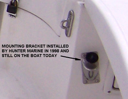

Got my replacement at my Yanmar dealer for $87.12 back in 2020. You can also probabaly find it at an automotive shop as well.
Teleflex TFXTreme suitable to my mounting equipment in place at the time. Pull out your "entire" cable and all mounting hardware and take it with you.
