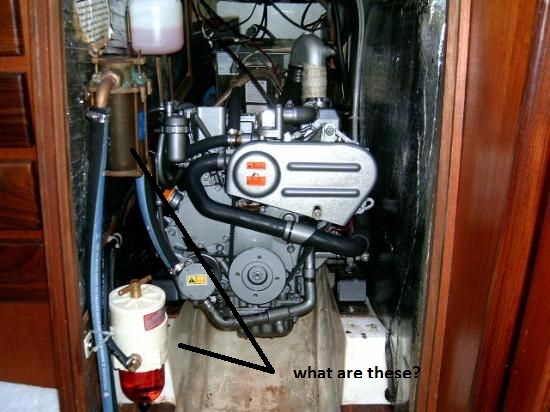

The top one is an inlet raw water strainer. A good one.
The bottom one is a diesel fuel filter.

seriously? Top one is the sea water strainer, the bottom is the primary fuel filter. Both require periodic maintenance.
10,204
MJ mercer.. That re-power is really good looking .. Looks like the previous owner had his head on correctly when he put the sea water strainer and Racor diesel filter where they could be serviced .. That new Yanmar looks great in there.

FYI: From the picture it looks like the Racor filter is missing a metal heat guard on the translucent bowl which I believe is required if the filter is located in the same space as the engine.

I also have a racor 500 with the plastic bowl in the engine compartment. It seems that a metal bowl is required by the Coast Guard on commercial vessels but not pleasure vessels, if located in the engine room. The ABYC addresses the amount of allowable fuel that can potentially leak from a filter. Maybe Maine Sail can elaborate on the subject.
Mine are swapped in position. Much easier to drain off the water in the bottom of the fuel bowl and to pop the lid on the strainer. At least, I seem to make less of a mess this way, especially when I have had to address both in a seaway.

My 37c water strainer is on the bottom-left.
when I launched the boat in the spring, my bilge pump went off, and I heard some gurgling noise then saw water pouring underneath the grate at the bottom of the steps.
I forgot to fully tighten the top of that water strainer :doh:. Having it high up is not a bad thing.
