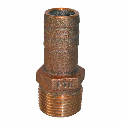

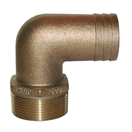

As mentioned, in order of preference, Bronze, Stainless, Brass.
You are looking for a Barbed nipple. Either straight or as an elbow.The barb accepts the hose and the screw end screws into the exhaust.
Bronze straight
Bronze elbow.
