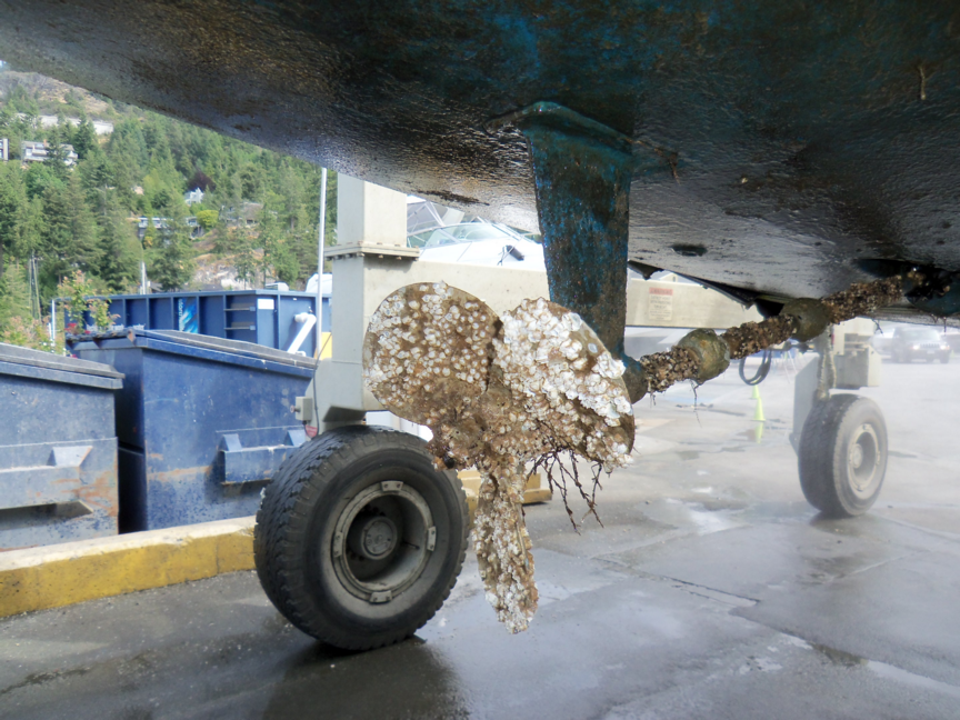

The cleanliness of the prop is another consideration. This allowed me a max. of 2000 RPM BUT with much attending black smoke.
If your 2500 RPM was due to excessive load, regardless of what caused it, you'd expect black smoke. Possible the PO limited the governor control (AKA throttle) to a max. of 2500 RPM.
Definitely needs repair before proceeding any further with the inspection.
