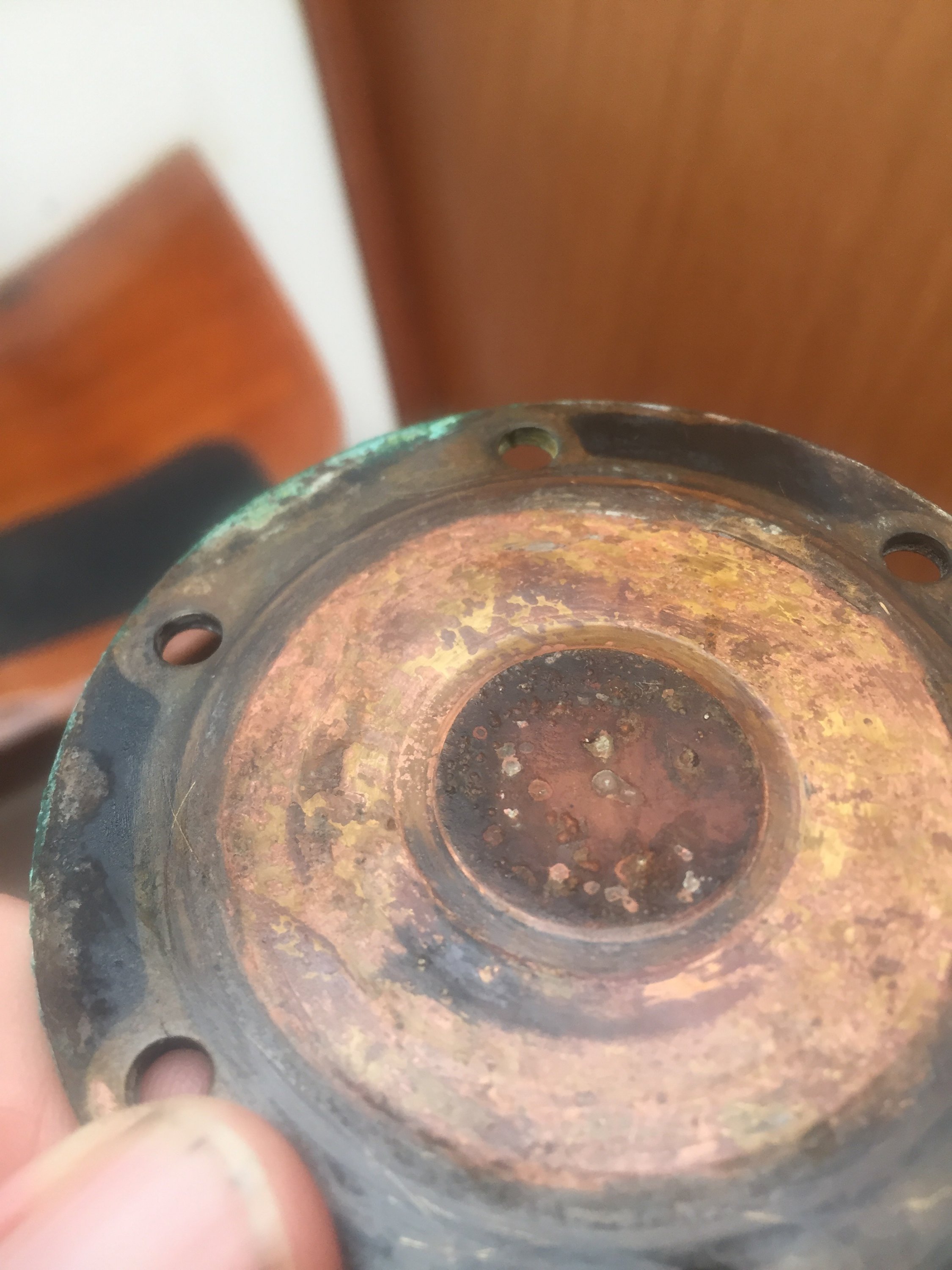

faceplate is smooth. You may have to sand it some. If you can see grooves, that could be your issue. Your troubleshooting work was very good. You have identified it as AT the pump, water TO pump, impeller spins, no water OUT. So...??? Good luck.

Stu: It is pretty smooth but there is the slightest groove visible. Here's a picture but not sure how well you'll be able to ascertain the depth of the groove. Do you think that could be the problem? I can't imagine why that slight groove would make a difference, however you are the third source of that groove info today so I'm going to sand it smooth and see if it helps! Thanks!

A friend suggested turning the cover plate inside out.....I mention that because if it works, it could be a good temporary fix out on the water. My plate has lettering stamped into the outside, so I don't know if that lettering would have the same negative effect as grooves do.

Strange.. That faceplate does not look to be touching the sides of the impeller blades/vanes..?? Usually the inside of a properly fitted plate will be shiny across except for the middle. Methinks the gasket is too thick or there are two in place? The impeller blades/vanes must touch both sides and the tips should be in contact with the case all the way around.. bent a lot more on the cam, but bent back a little opposite the cam.. If the impeller sides or tips don't contact the case, it will not pump nor will it even try to prime.
Could be a wrong impeller too.. If the impeller is ten thousandths of an inch too narrow, it won't work. one quick way to check is to push the impeller all the way in the case then put a good straight edge across the case face.. If that straight edge does not touch the impeller, the impeller is too narrow.

Looks like you have the "beloved" Sherwood pump. According to your posts, by removing the pump output hose you have eliminated any issues with everything downstream of the pump, so don't worry about that stuff. I agree with Newport Bob that you could have an air leak at the strainer, but you could test that by running a line direct from intake to pump. To refresh the cover plate may I suggest you place a sheet of wet-or-dry sandpaper on a sheet of plate glass and sand down the inside face of the pump cover. Working in a sink with water running will lubricate, flush and yield a nice finish. I used 400 grit. Sand in a circular or figure-8 motion until the surface is smooth and free of ridges.

It's pumping water now!
Not sure which change did the trick:
1. turned the impeller face plate around, with copious amounts of vaseline on the o-ring;
2. turned the o-ring in the cap of the seawater strainer around...noticed it was flattened somewhat on one side...so by turning it around a more rounded, "new" surface would create the seal. Also put more petroleum jelly on that seal, and tightened it a little tighter than my previous practice;
3. primed it by filling both hoses to the impeller with soapy water, with the thru-hull closed, then started the engine and opened the thru hull a few seconds afterward.

It was most likely the vaseline that did it? The 3YM30 has the Johnson pump. The groove in the face plate is for the O-ring which is in the face of the pump and should be changed when you change the impeller. The impellers used to come with a small packet of lubrication, but no longer. I would trun your face plate back around and install a new O-ring.
