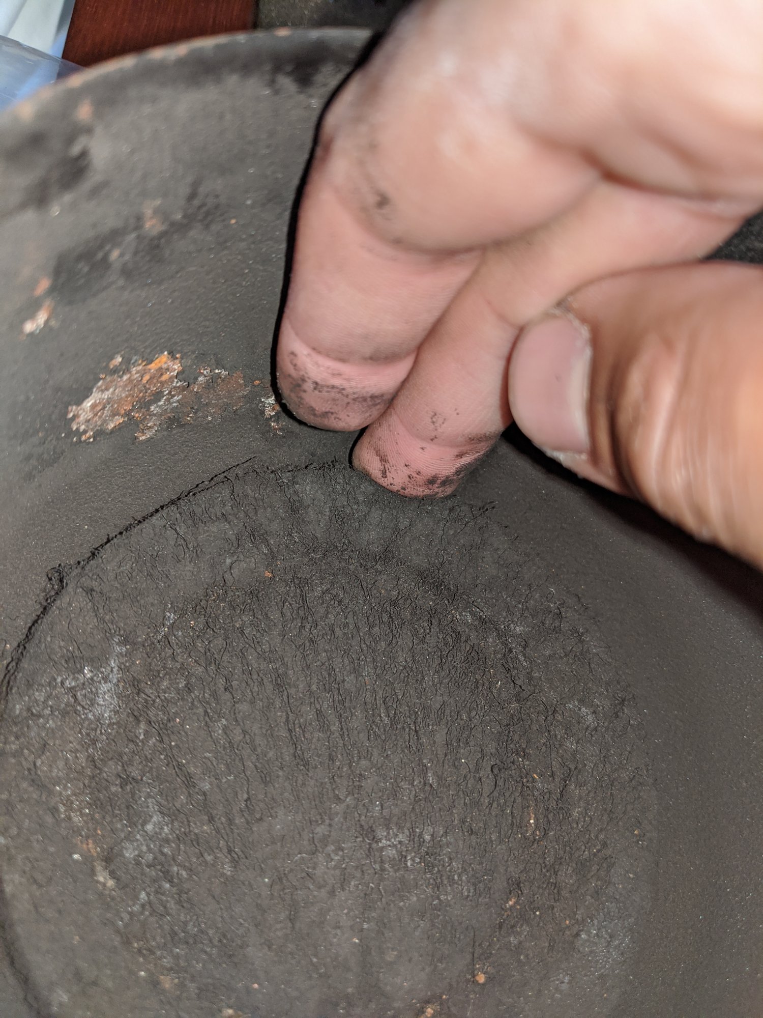

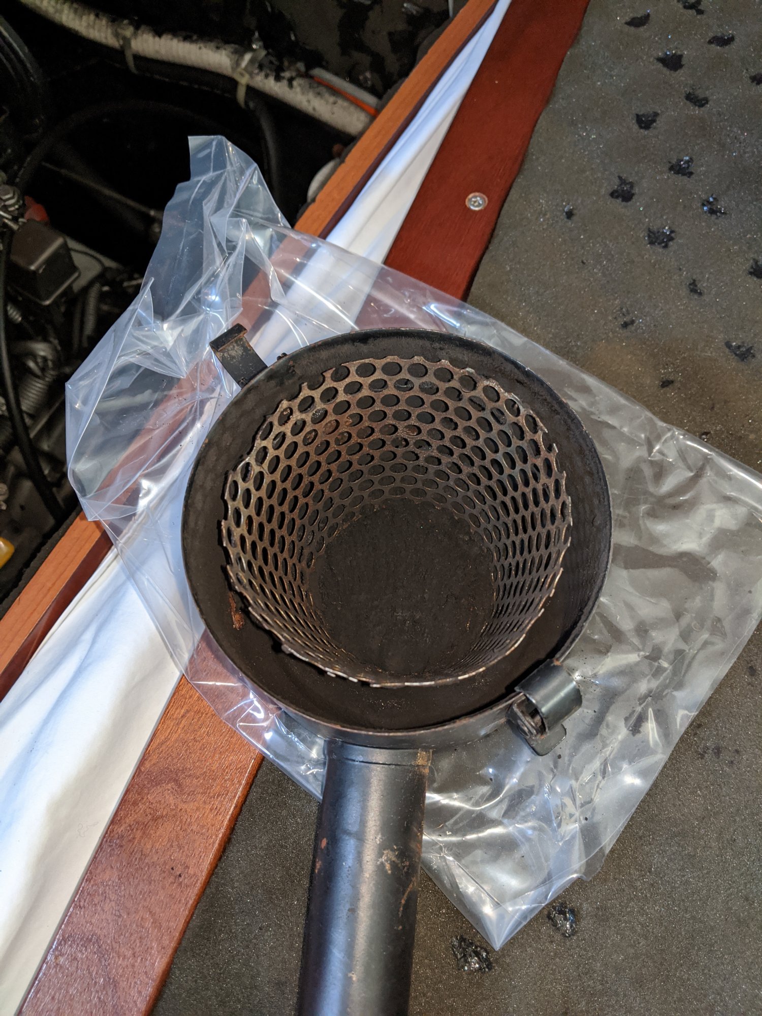

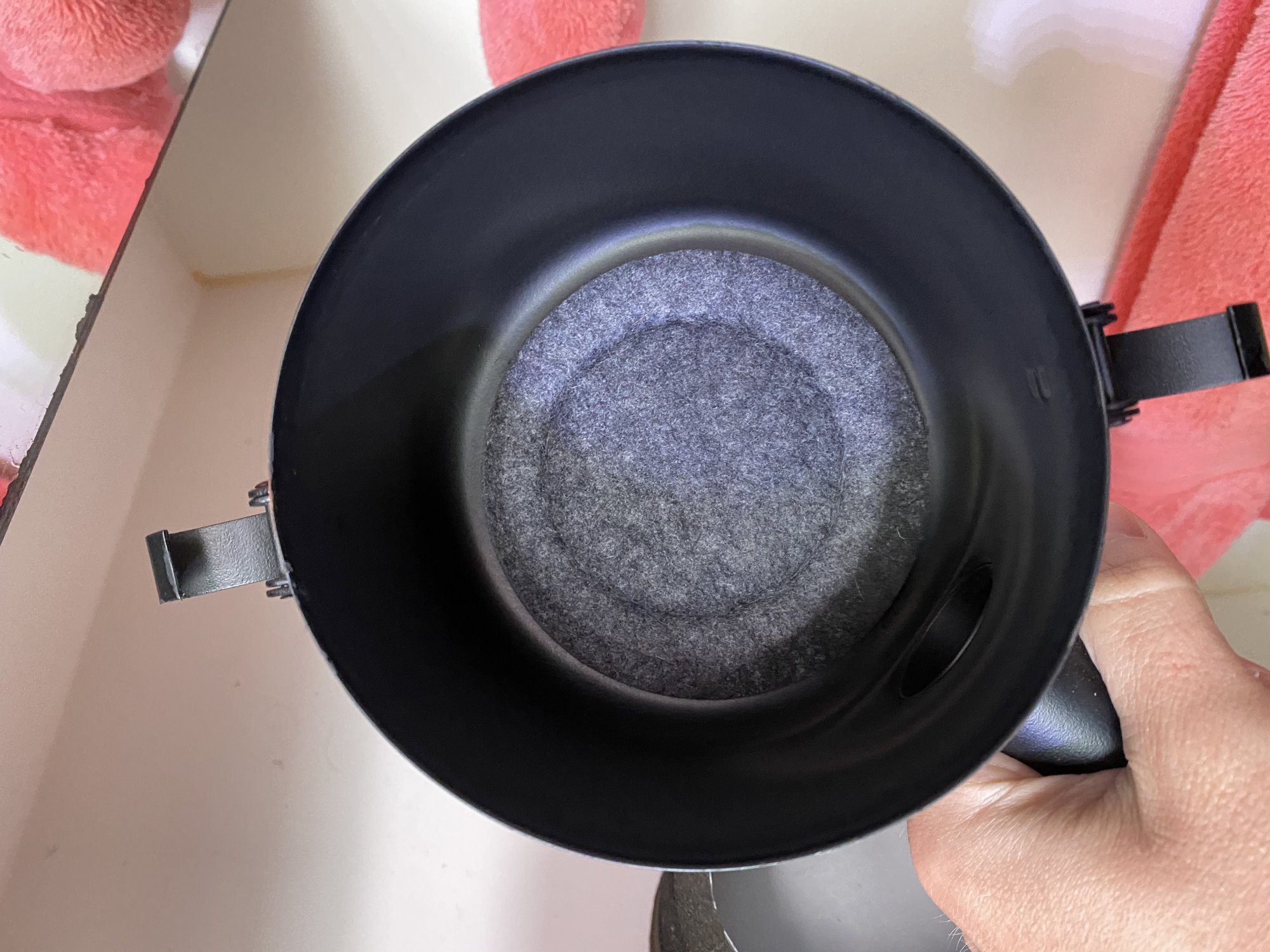

As suggested by others I decided to inspect my air intake element on my Yanmar 3YM30. The foam was entirely missing, so I replaced it with a new one. I'm going to add this inspection to my annual list.

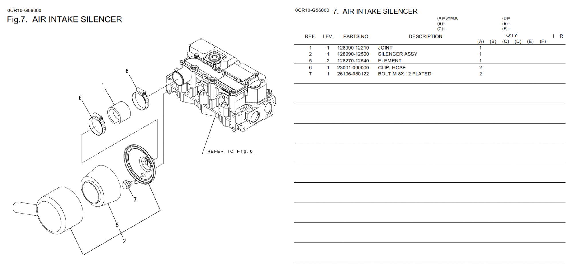

I noticed a very dirty piece of felt or something stuck to the end of the intake silencer. It peels off if you pull it. It was so dirty and cruddy that replacing it seems to make sense, but I can't find the part number and wouldn't know what to replace it with. The parts catalogue attached doesn't seem to be of help either.
Should I:
  1. Remove this and just use the air intake silencer without this piece,
  2. leave it in, or
  3. replace it?
Thanks for any insight you guys can give!
Do you have a picture of this "piece of felt" ? Nothing like that on a 2GM 20F and nothing in the manual either.
Also, anything unusual going on in your engine compartment ? I see the interior of the filter support is corroded. It's galvanized and SHOULDN'T be showing any signs of corrosion. Mine is 21 years old and clean after 3,000+ hours. Have only replaced the filter once (at 15 yrs.) out of an abundance of caution as it still seemed in reasonable condition.
It was attached to my original message: link. It's hard to tell what it is, because it's black as soot! I can't find anything in the manual or parts catalogue either.
Perhaps. The boat is new to me. Is that small amount of corrosion a concern, or more an indication of something else going wrong?
OMG ...................... I hadn't realized what that was. Don't touch it again. Now go wash your hands :yikes: ! After you've done that, go wash your hands again :yikes: !
I couldn't tell you what that is ................... I couldn't even come up with a BS answer as to what that is. It's most likely something the previous owner applied. Whatever it is, you don't want anything like that even getting NEAR you engine. Deep six it.
It in itself is not a problem. However, it indicates something UNUSUAL is going on.

The "felt thing" is most likely just residue from the disappearing filter and soot...quit feeling it:yikes: Some people do away with the filter entirely; cleaning up the wire frame and reinstalling will keep large debris from entering the intake.

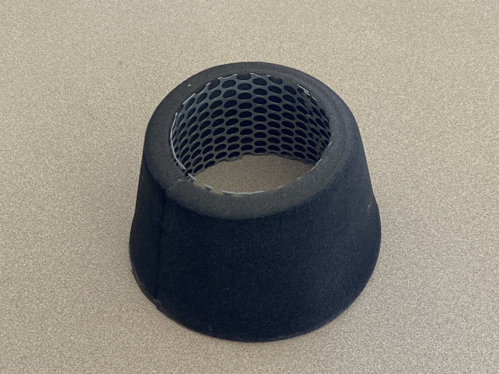

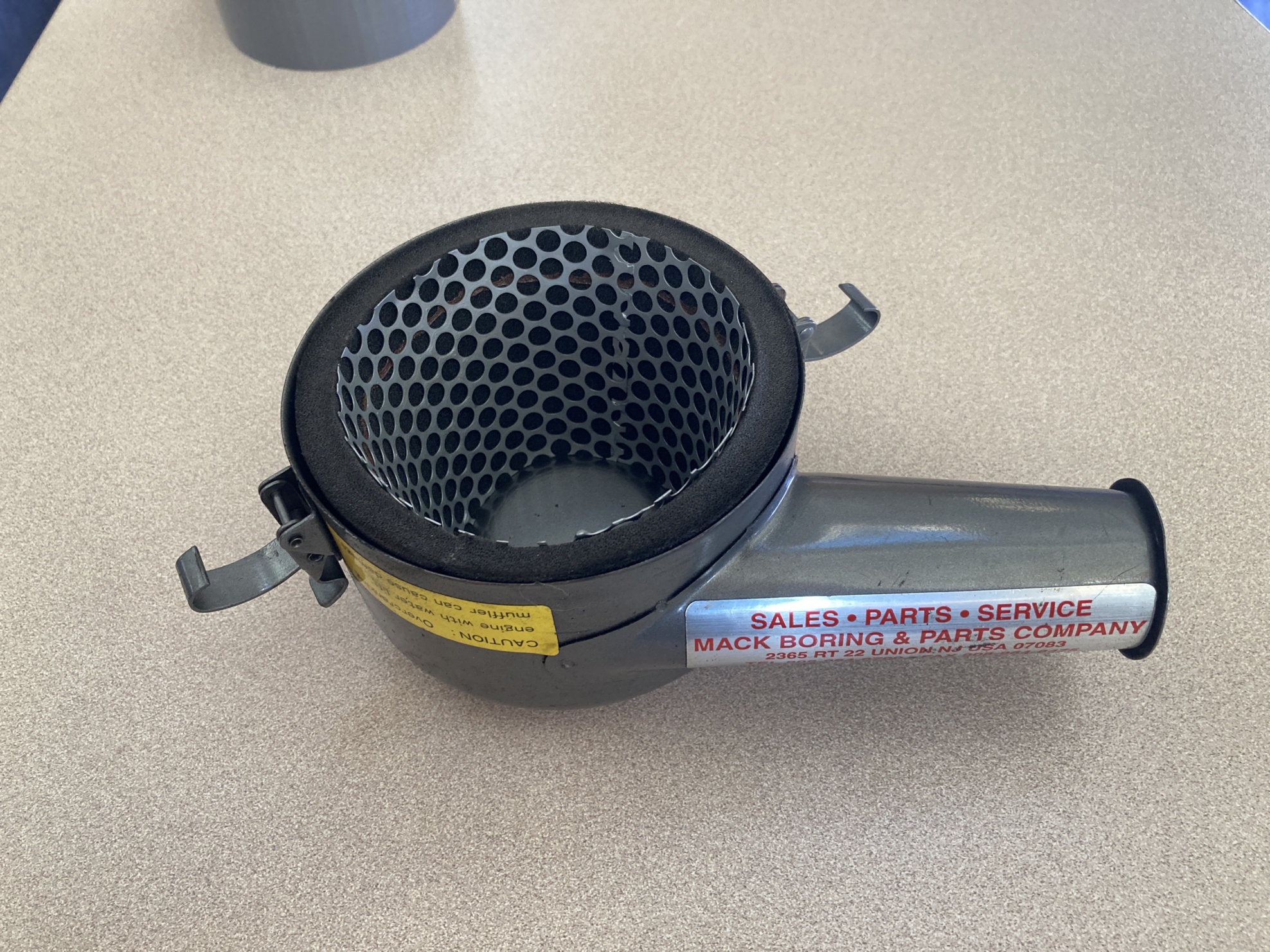

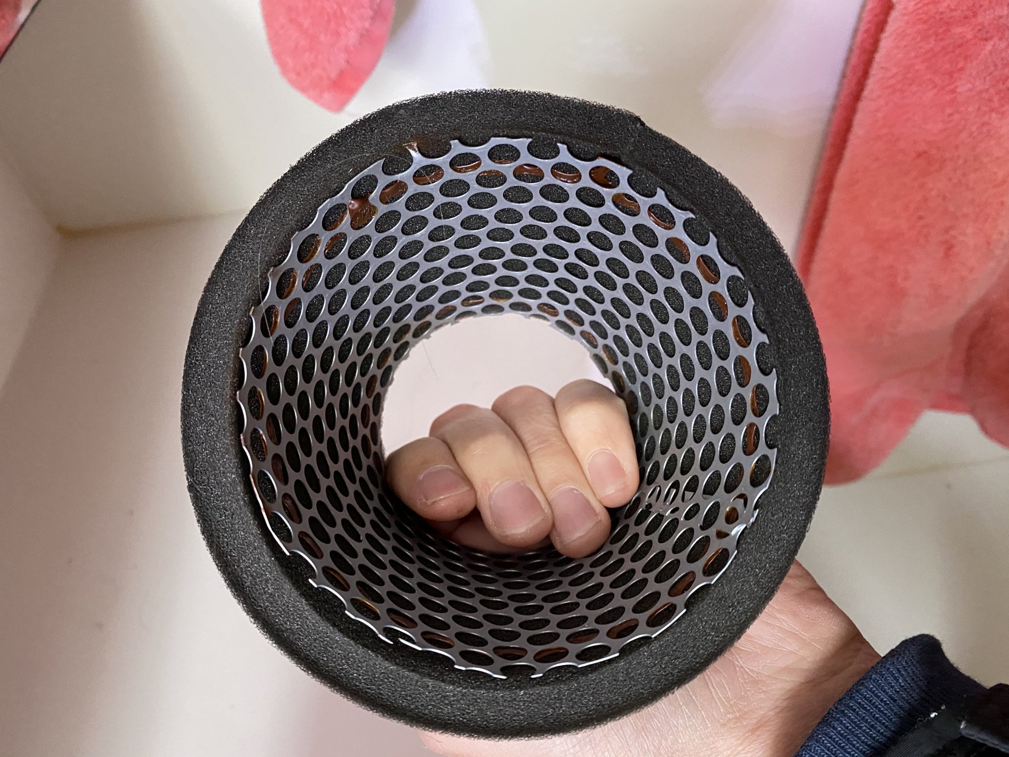

Picked up a few pictures yesterday of the current air filter after 5 years and 400 operating hours.
Interior metal backing and foam rubber in as new condition. No explanation other than maybe the engine doesn't use air o_O !
Welcome to "Sailing in the Twilight Zone :yikes:"

Hey guys, that piece of felt is there to force the airflow through the filter media. Otherwise it will flow through the open end of the cone. It also does minimize metal to metal contact.

I think, maybe, that's what happens when you treat or clean the filter element with something that's incompatible with the material that it's made of. The crud on the felt seal or gasket is probably all that's left of the foam. Since the boat is new to you, who knows how long it's been like that or how long it took to disintegrate.
You might be able to make your own felt "seal" for the inside of the cover.

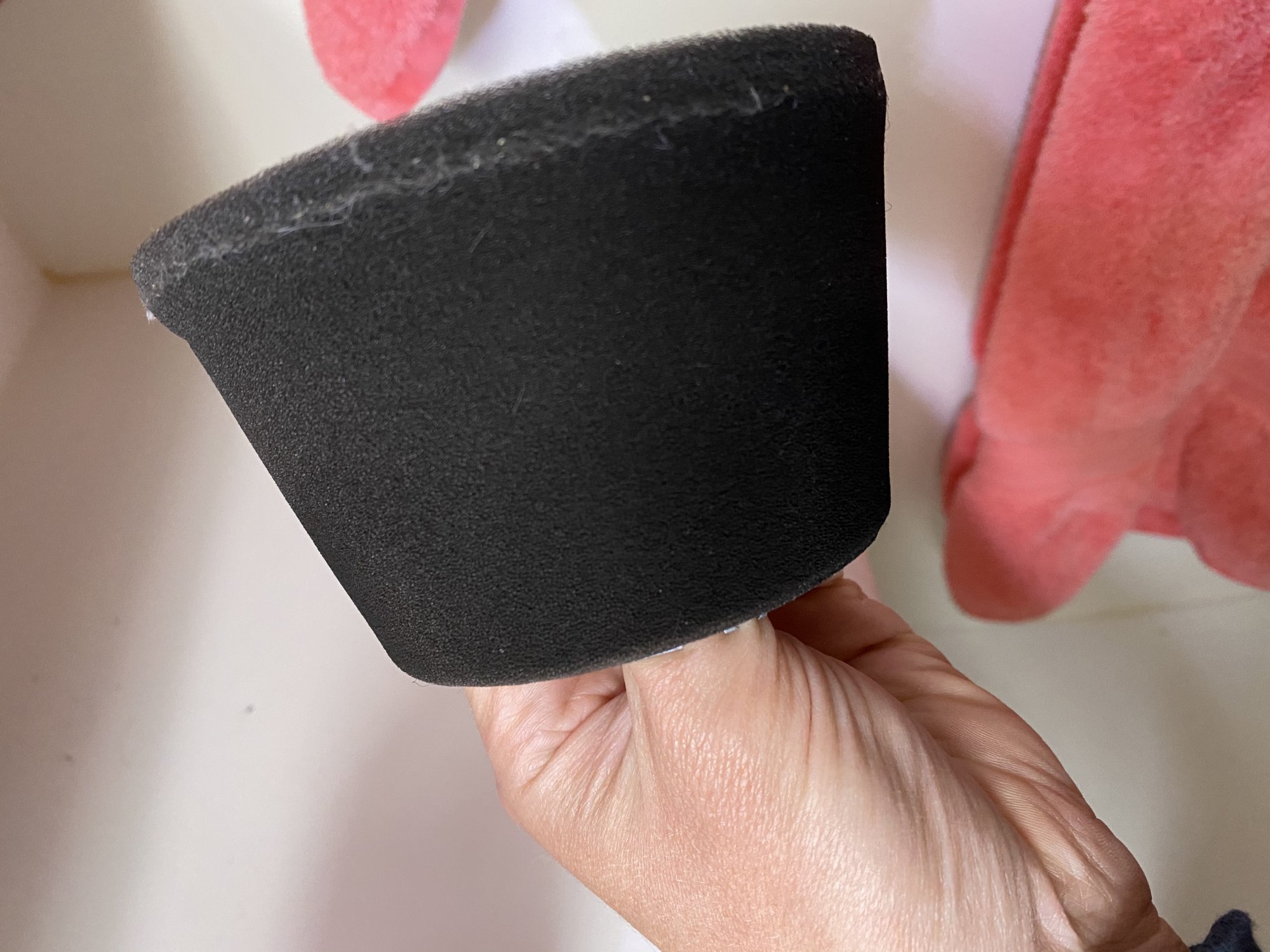

As another data point, this is my air filter after 7 seasons and 410 hours -
The lighting isn’t great in the picture, but in person I could see slightly dirty sections aligned with where I’ve had the intake pipe positioned. The rest of the filter material is pretty much pristine.
And this is the felt inside the housing -
