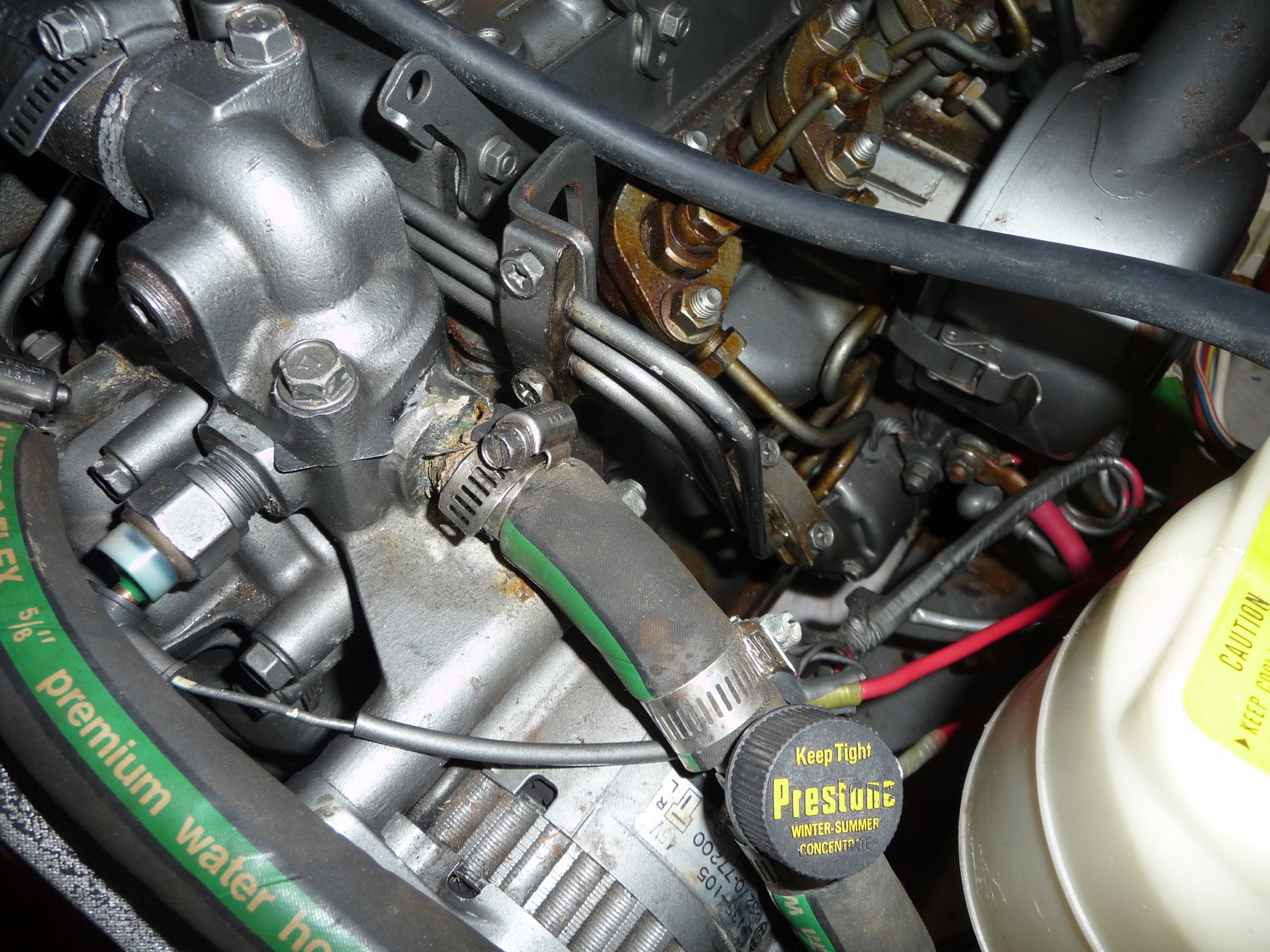

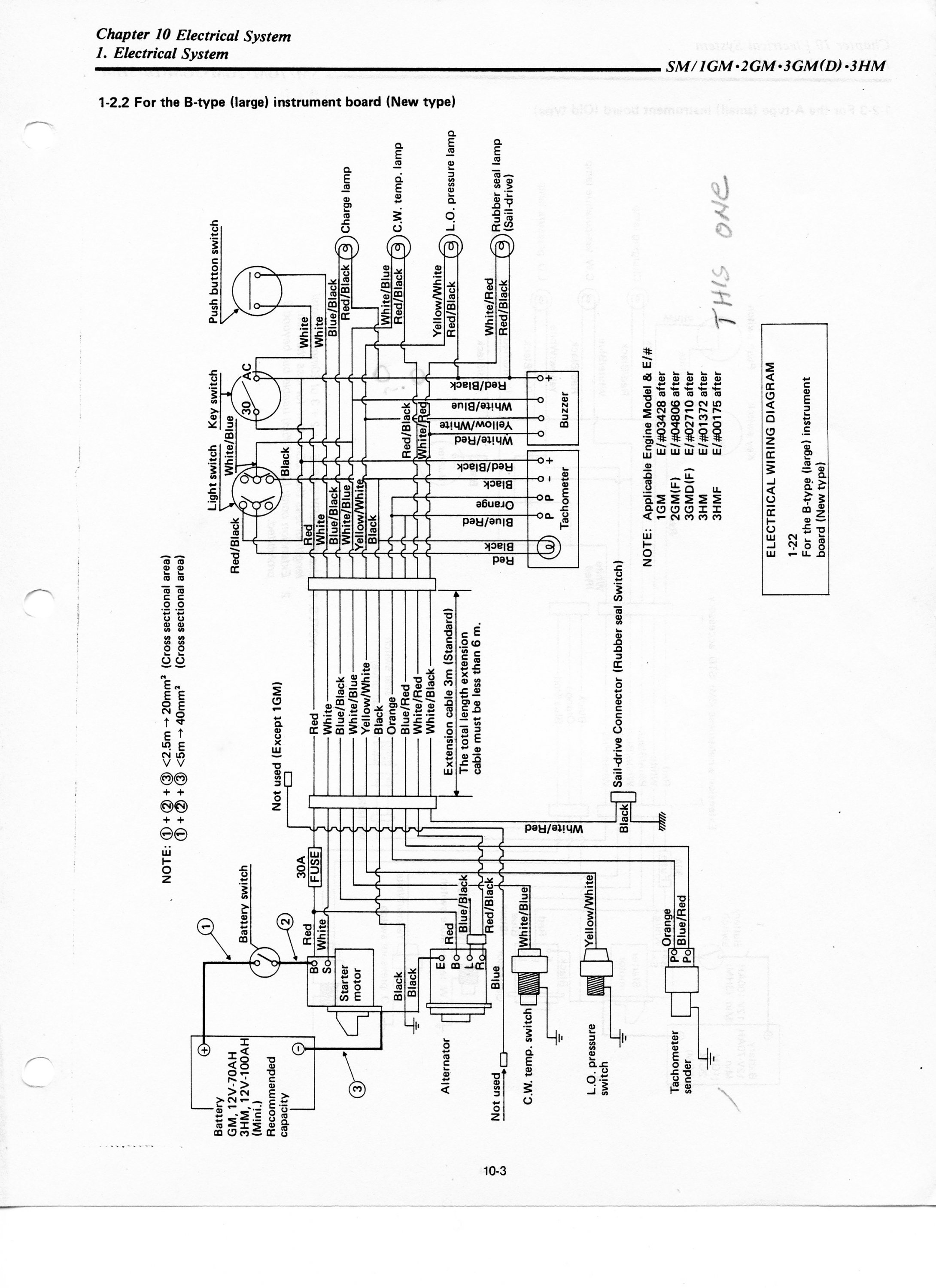

The "official" Yanmar wiring does not have a green wire and no gauge, only an over-temp warning lamp.. Attached is the 3GMF wiring.
It would be kinda normal to have a temperature sender for a gauge in the coolant outlet/thermostat housing. Shown here the "C.W. Temp Switch" in the diagram .. the green topped switch right by where the hose has "5/8" written on it..

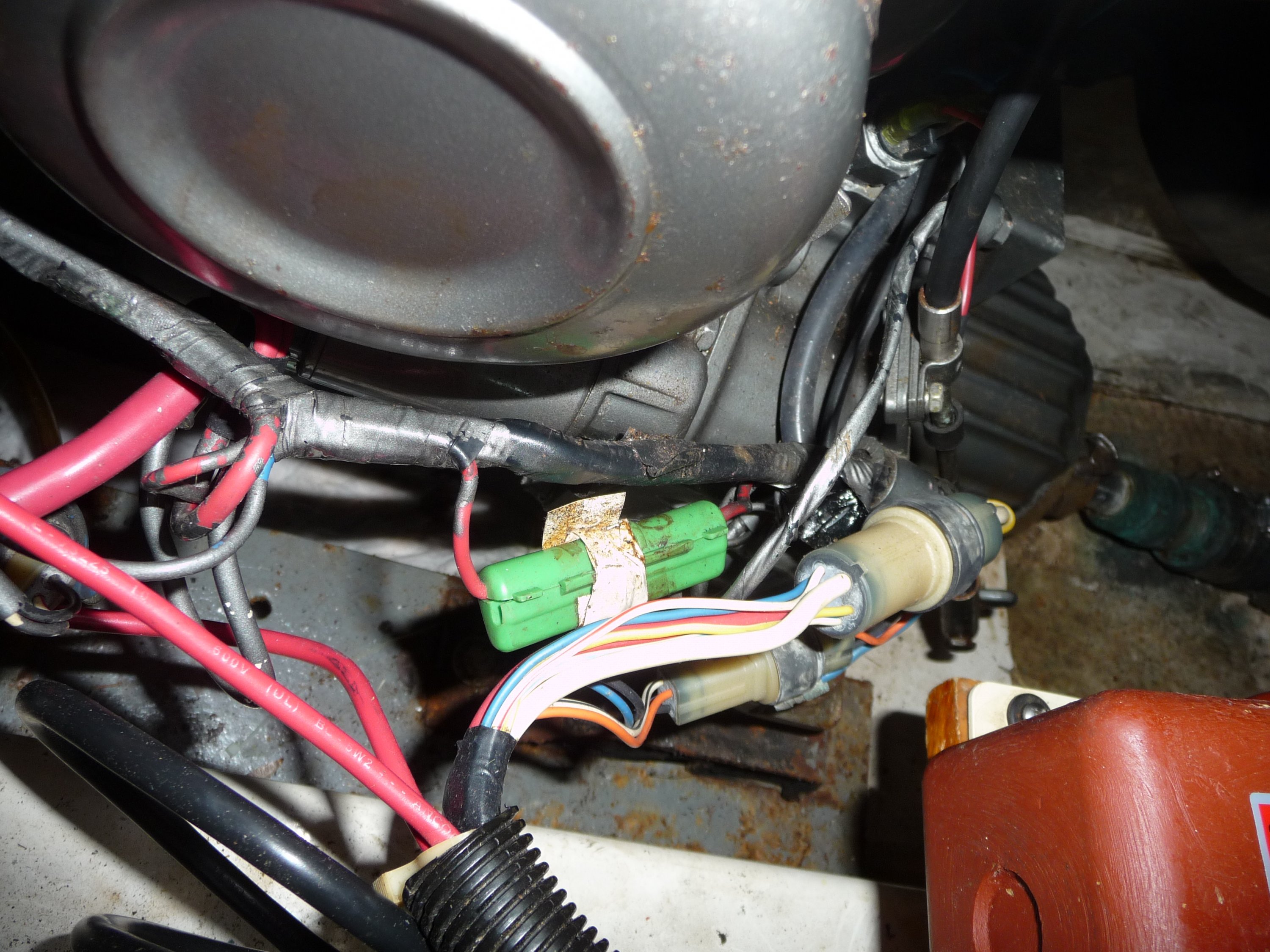

Thanks for the quick reply .. I meant the sensor has a green color end code .. Have the diagram but having trouble with the trace ..I was seeing maybe goes to the water temp gauge .. Perhaps by way of the Hanes "connector " where
-as I see an open hole in the connector ?
Thanks
10,048
Dunno, the White/Blue wire goes through two connectors.. One is on the engine. usually, aft port side.. the other close to the panel.. The white/blue goes to the temp warning lamp in the panel. Picture is the connector at the engine. The whiteish thing to the right of the green fuse holder..
