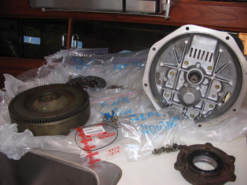

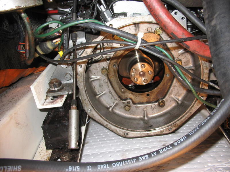

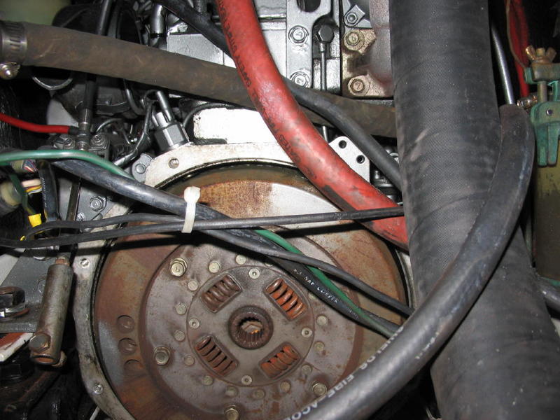

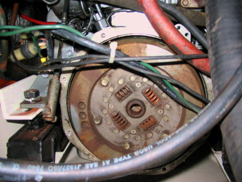

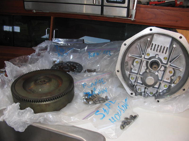

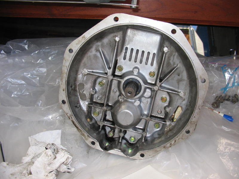

I removed mine on a mooring...by myself. I even removed the flywheel and clutch plate. You'll need someone's help to re-install it because of the engine angle and the cramped space provided by the access in the stern cabin. As mentioned, undo the coupling and slide the shaft back. Fairly simple job to remove but you'll feel like a pretzel when doing it. Hope the pics help. Good luck.

Interesting.. Claude, how did you get it out? the access hole aft of the engine?
Two other "hi-jack the thread" questions: What is the canister with water hose to port of the engine bay? what are the angle iron "runners" just above the flex engine mounts?
Joe, Note tthat Claude pulled and replaced the rear main seal on the engine.. While you are in there, that is probably a great thing to do too.
Yes and put it back through the same access hole. But as mentioned I needed help to support the weight from the top of the engine.
When I bought the boat it had dual refrigeration systems: 110V and an engine driven compressor. What you see is the heat exchanger for the engine driven system. Seawater went through that before going to the engine. This has now been removed.
What are the angle iron "runners" just above the flex engine mounts? The engine driven compressor was mounted on the port side and had a hefty iron support bolted to an angle iron mounted on the engine mounts. I always thought the starboard side angle iron was there only to facilitate engine / shaft alignment by making the height even with the port side.
