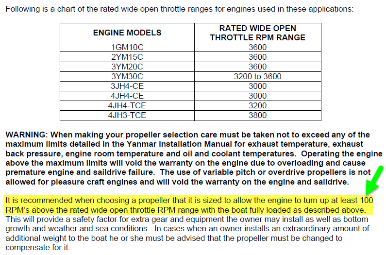

Sounds over propped. This is one of the most common sizing issues we see on boats.. The exhaust elbow could also be at play, but if you can't reach max rated RPM + 100 (see below), and never could, this is an indication the engine is over-propped.
Running these engines over propped can also lead to plugging the exhaust elbow sooner and actually voids the warranty on new engines.. Being over propped is kind of like trying to drive a Toyota Tercel, up Pikes Peak, in 4th gear.....

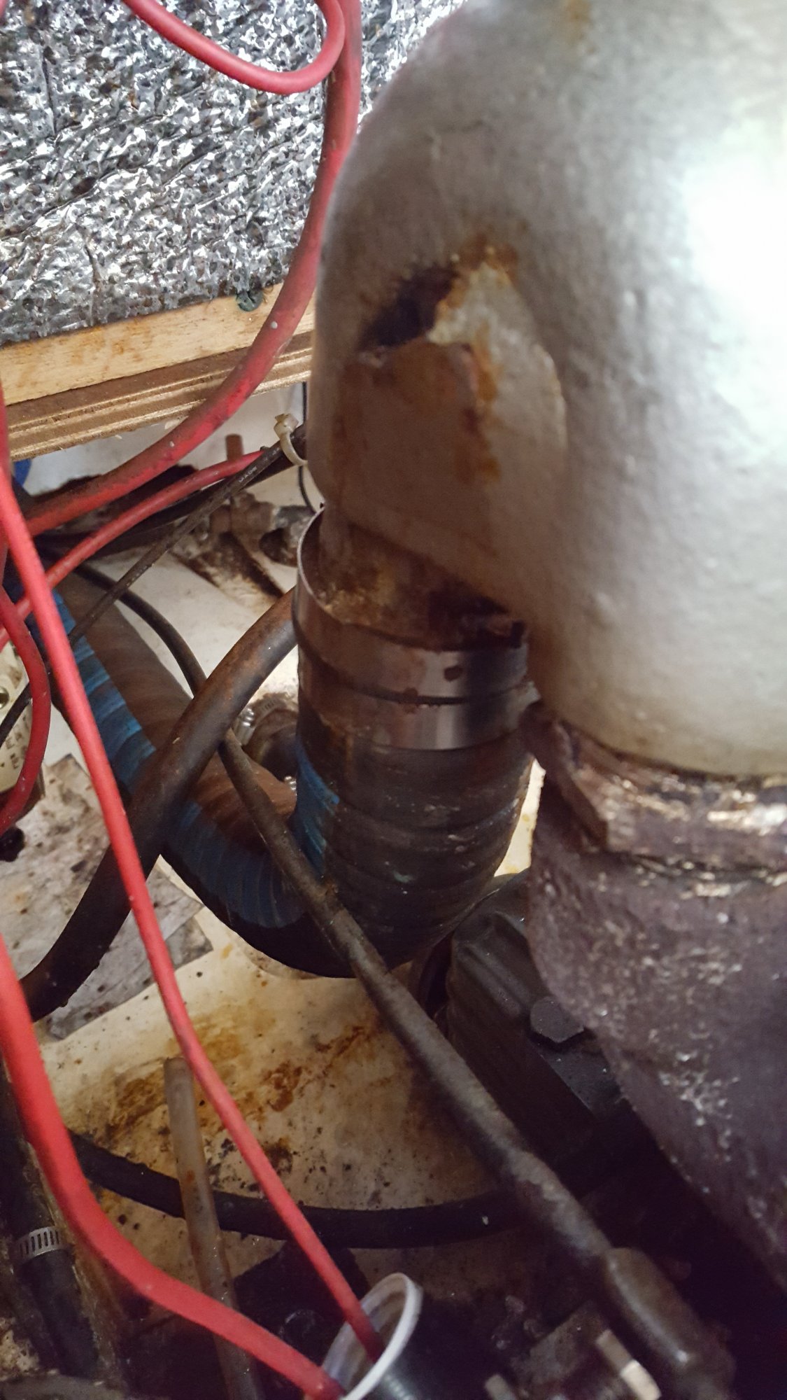

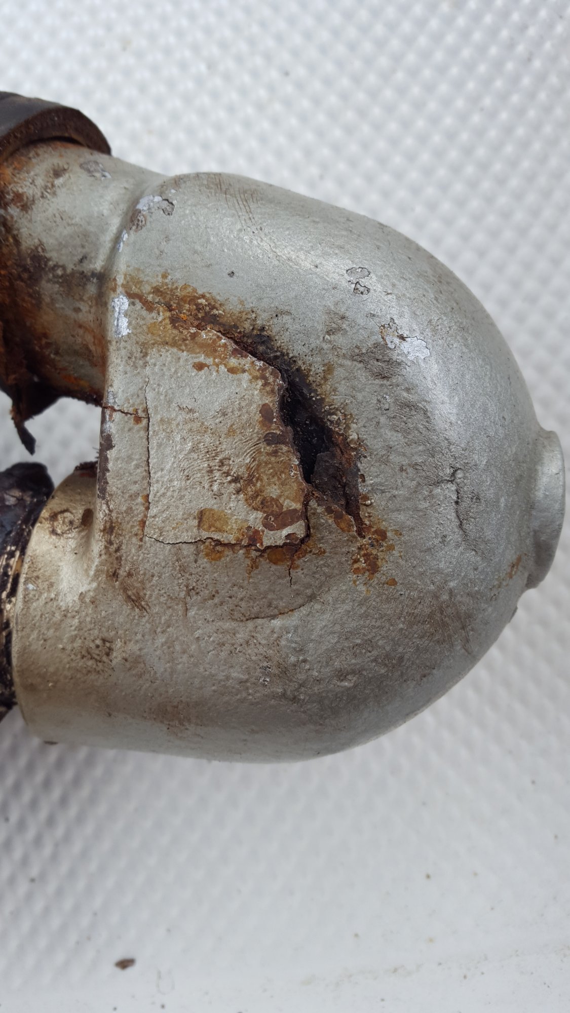

May 17, 2010
25
Hunter 1983 - 34' Port of Everett
Thank you all for your input and good advice. I am confident that fuel system is OK. I have found that exhaust/cooling elbow had sign of expansion corrosion that was almost breaking through the external wall of the elbow with potential leaking of exhaust into engine space and cabin (see attached jpg). Flushing the cooling port with water did not show any sign of obstruction or communication between the exhaust and water ports and totally irrelevant at this point since I obviously have to replaced the manifold extension and cooling elbow and, while at it, I pulled muffler out for inspection. The muffler had no sign of corrosion or internal collapse so I returned it to service. I installed new header extension and cooling elbow and started her up. I was able to see some improvement in exhaust cooling water splash, so there must have been some level of obstruction in the old unit. There was no sign of blue or dark exhaust when starting and warming up. I can easily rev the RPM up to manufacturer's recommended 36+K while in neutral without any significant change in exhaust color. However, when I engage forward gear the RPM can not exceed 27k. This leads me to the next great advice mentioned above regarding prop pitch. I did have 3 blade installed several years ago and really found great improvement in back-down and tight space maneuvering. Since the prop and shaft were installed by professional who at the time assured me the pitch was appropriate for my engine I didn't give it a second thought, since I felt I appeared to be achieving hull speed at around 25K and since some literature by marine diesel owners seem to say normal cruising RPM was typically in the range of 25-27k I never seemed to have purpose to push it harder. I'm planning to haul the boat out to get the bottom repainted, and will see if prop is properly matched at that time. Thanks again everyone for your insight.
