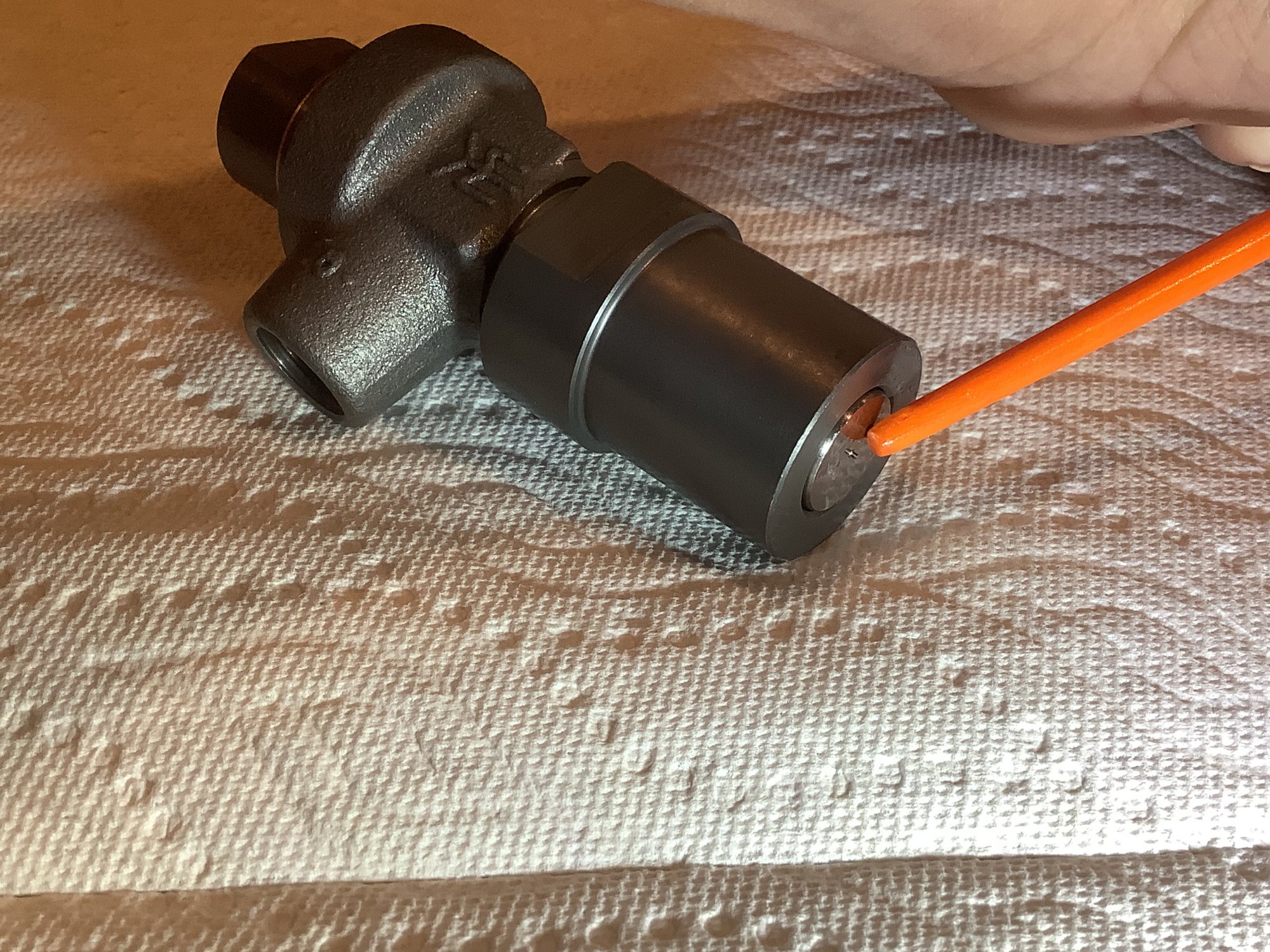

I bought 3 brand new injectors genuine Yanmar part 728170-5300 and all the necessary parts to replace the old ones per Mac boring technician
I have never replaced them and it appears to be pretty straight forward job.
I opened one new box to be sure it looks correct before I start taking everything apart. The injector doesn’t appear to have a tiny hole in it like everything I have seen on YouTube. It has what appears to be a tiny pin protruding from it.
Is this normal?
I believe that inside the injector there is a spring that will allow this pin to operate and allow fuel to spray from it.
Is this correct?
I don’t want to open another box to check if the rest of the injectors are the same. After i open the package they are mine and they aren’t cheap. I’m hoping that they sent me the correct part. Again I’ve never pulled out an injector before and I don’t have the old one out yet to compare it to.
I’m trying to save about two thousand in labor by replacing them myself, this is most likely the next course of action that the marina technician is going to do without really getting into the engine. So far I’m into this for about $900 in parts and materials which is not to bad considering everything that I have replaced so far is 35 years old, original equipment, and needed to be replaced anyway. Unfortunately the other items on the list of possible causes are beyond my mechanical comfort level. If replacing these injectors resolves the issue, great, problem solved. If not I’m still ahead of the game as they really don’t owe me anything after thirty eight years.

I think the pin you see is an internal part protruding. I'd go ahead and replace the injectors. Mske sure that you purge ALL air from the fuel system.

Firstly, excellent write up and photo of the problem. This is a real pleasure to follow. Just sorry it's your problem :wahwah: .
I would definitely follow up with @Davidasailor26 's recommendation on the optical tach before tearing anything apart. $20.00 from Amazon. Maybe cheaper from HF.
Since you're eventually going to pull the old one(s), pull out an old one now to check for the presense of a pin. Please send pics for comparison.
