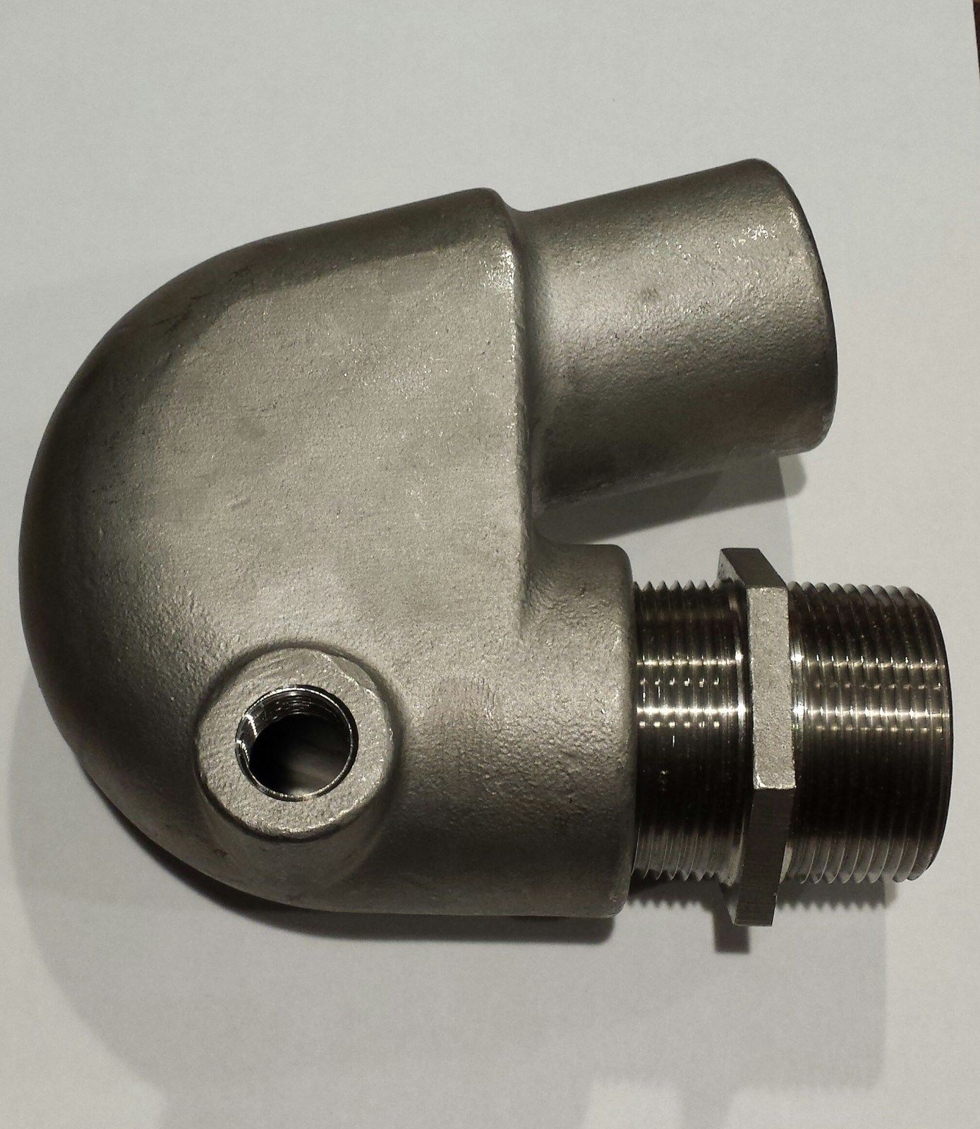

There is a stainless elbow (a Yanmar clone) with stainless threaded coupler available from HDI Marine in Vancouver, Wa. It is $155 for both. Shipping is $13.
If you are interested PM me for his address.
Charles

I not sure pretty sure I paid same price fromYanmar bur foget how much more for the stainless maybe $25 I think.
Nick
