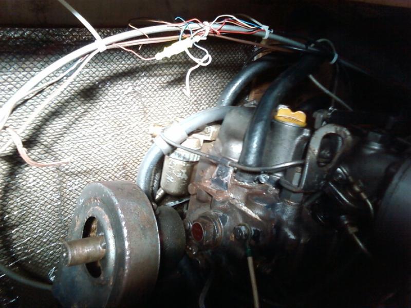

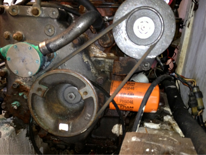

I think there is a nameplate on the front of the engine with type and serial number.. same on the transmission.. ya might have to use a mirror to see the transmission plate.. Sometimes hard to read.. ?? I have attached pictures of a 3 GM F and a 2 QM 20.. A 3 gm30 would look like my 3 gmf.. a 3QM30 would look like the 2 qm20..A quick way to tell is the position of the high pressure injection pump.. on the 3GM's it is forward of and just below the top of the cylinder head.. The plungers are vertical.. On the QM's the pump is horizontally mounted on the starboard side of the engine block..
The shot with the sheet metal chain guard and crank sprocket is the QM the one showing the 3 front pulleys is the GM..
Another forum guy owns the boat "Lone Star" Not too far from ya..
OTHER NOTES: EDIT: The QM's were made in the 1976-1980 times.. The GM's were kinda in the 1983-2003 years.. If the boat was not re-powered, it is probably a 3QM30.. But the plate on the front of the engine will tell the tale..
