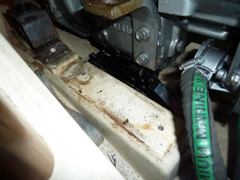

Pic of my mounts

I will keep you informed as I progress.
One suggestion in my quest for info from a GO2MARINE was to change to another type of mount. WHich I may do as it may be cheaper and easier to do.

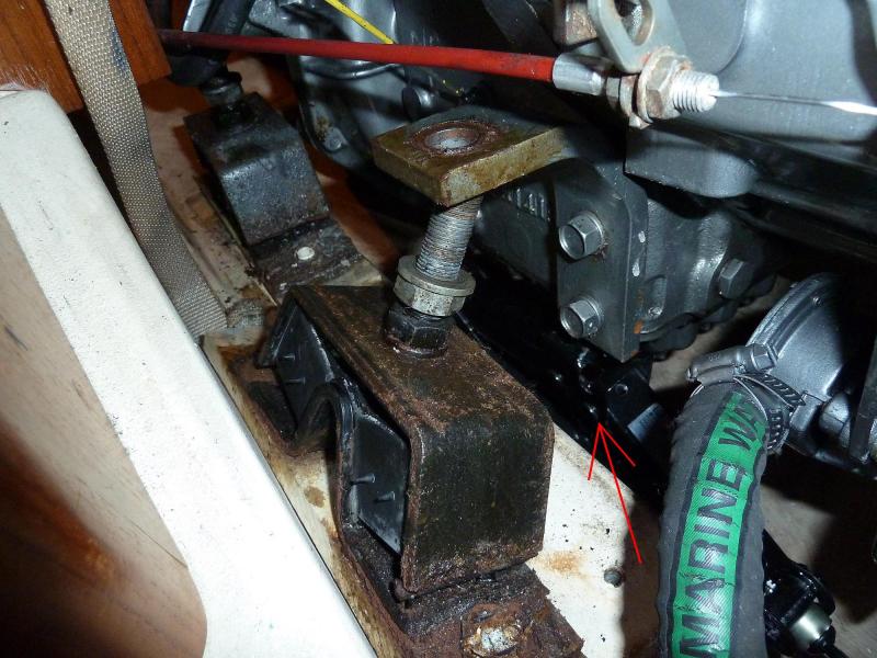

This is my current mount.
I did not find a loop on top of my engine to raise it up with a block and tackle. Any thoughts ?

Not a clue. However, I an very interested in the alternate mounts, as they all need to be changed at the same time and that's almost a boat buck when you look at replacing the cutless bearing, strut, etc, might as well when you are doing all that engine movement...

When took out my 2GM20F mounts for reconditioning, I decouple the shaft coupling and loosen all the Top nuts of the 4 mounts before using a car scissor jack to raise the engine just enough to take the mount out and put wooden blocks in place of the missing mounts.
