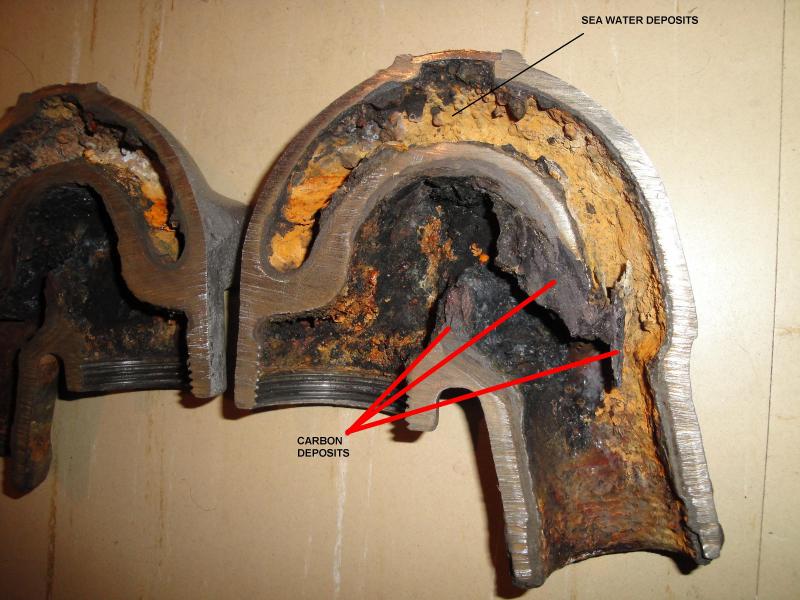

I would investigate the mixer elbow at this point. Good luck with your search!

I would also say mixer with restricted flow, the small elbow will carbon/coke up. How much water are you getting out of the exhaust? The restricted flow will not cool down the exhasust gases then you get steam.

I have a 3gmF and I went through a very similar scenario just last month. Rebuilt the sea water pump, cleaned the heat exchanger, checked fresh water system. It still overheated after about 30 min. Turned out to be a clogged mixer elbow. VERY IMPORTANT, if you flush the system with a hose make sure the engine is running otherwise it will backflow through the exhaust manifold and fill the engine with water. It's a long day of getting the water out of the engine after that.

Could be as simple as the exhaust manifold beginning to fail .... slabs of rust in the 'bottom' of the water side of the exhaust manifold becoming 'agitated' (moved off the bottom by the water flow) and partly blocking the flow at the exit of the manifold. Usually when this happens and you stop the engine and let it cool, the 'slabs' fall back to the bottom of the manifold, there to remain until 'next time'.
Your engine should be delivering cooling water out the exhaust at about 3 gallons per minute when the engine is @ 2000 rpm. So, first verify the flow with a bucket and stopwatch when the engine is cold, and then again when you note the 'overheat' condition. Also, note the outlet temperature of the water in both cases. Any restriction in the raw cooling circuit will show up (when at the reference 2000 rpm) ... with a bucket and stopwatch. If no flow restriction (worn pump casing, broken vanes in the piping, bad T'stat, collapsed (internal) hosing, etc. etc.) then look at the condition of fouling in the Heat Exchanger, restricted injection elbow. Such problems are usually: not enough cooling water or inlet cooling water too hot, lugging engine (over-propped or too tight stuffing box, failing exhaust manifold), blocked injection elbow.
