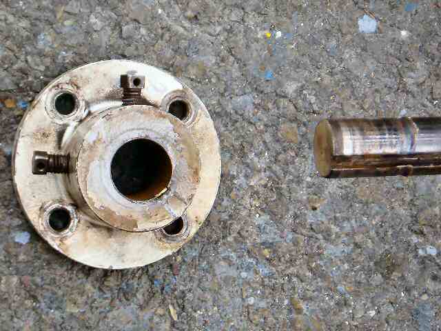

What comes to my mind is you might have picked up a plastic bag in the prop. As you sailed in it managed to drop off. If the problem does not come back, that was most likely it.
The other option might be a failing drift pin in the transmission to shaft coupling. It that is it, it will come back soon. But you most likely would not get the black soot in the exhaust water.

Jose,
Sorry for the confusion. The pin I am speaking of is a pin or key that fits in a grove on the prop shaft and in the transmission coupling. It makes the shaft turn with the transmission.
I have had one shear due to an out of alignment condition.
Once this pin shears, the engine sounds like everything is fine, but the prop no longer turns. But it might stick a bit and seem OK, until it's pushed a bit hard.
Just an idea.
Greg
