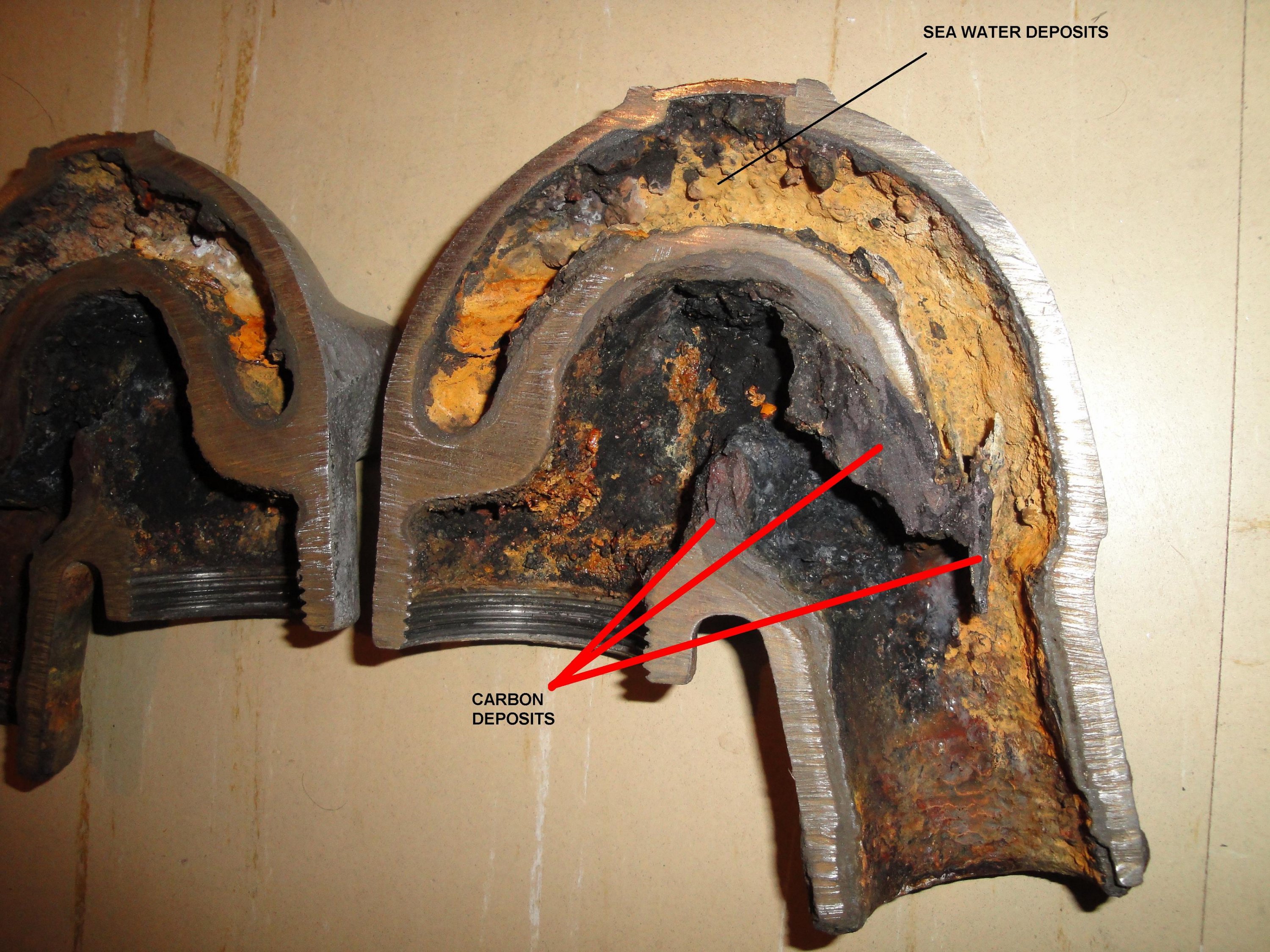

One of the overheating causes that may accompany a loss of RPM is a clogged exhaust mixing elbow. It will restrict raw water cooling flow and engine combustion exhaust restricting RPM. There is always the possibility of a compound fault, drain the water separator and replace the primary and secondary fuel filter elements. Do replace the raw water impeller.

Would a clogged elbow reduce RPMs to about 1500... only when running in gear? I have no problems when in neutral .....revs up to 3300 and very responsive.
When in neutral, it takes very little fuel to goose the engine up to 3,300 RPM as there's minimum resistance.
When in gear, there's much more resistance so much more fuel is injected to try to get up to speed. That fuel produces much more carbon dioxide which causes back pressure in the mixing elbow hence less RPM.
