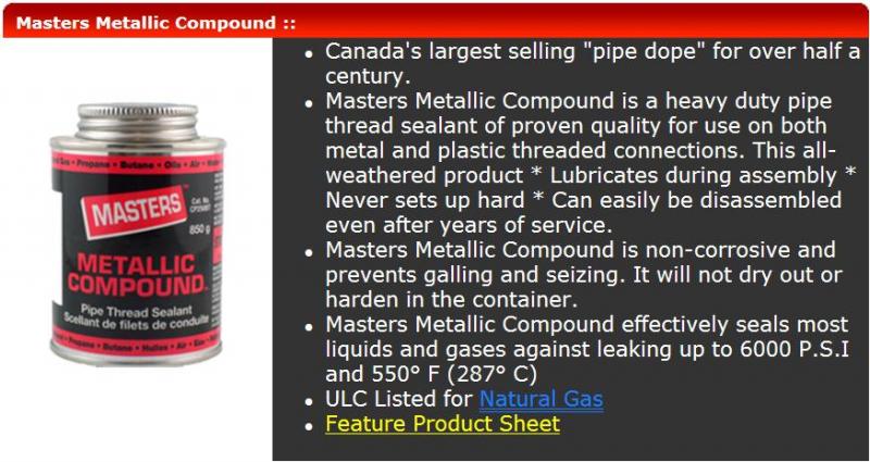

My question is should I be applying a sealant to the threads of the connecting piece. If so what type do you suggest?
Yes ............... you should definitely be applying pipe dope to the threads. Not for sealing at these low pressures but to remove the mixing elbow the next time you want to inspect it. No torching required.
This is one of many sealants that will do the job when used properly and safely. It's mostly lead.
