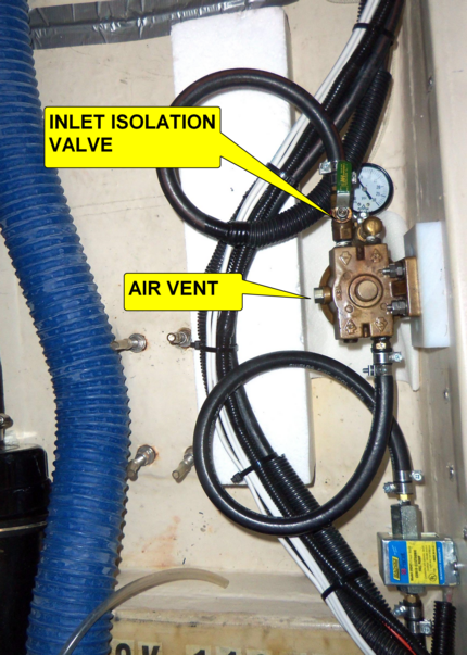

There's really no worry about purging air from your primary filter if has a local inlet valve as shown :
After changing the filter element, the casing is full of air. Crack open the inlet valve, open the air vent and fuel will slowly fill the body while forcing the air out. Close the vent when all of the air is gone. Maybe best to change the element when your fuel tank is full to ensure you've got a head above the filter body.
Same goes for the secondary filter.
It's a good location to accumulate and periodically vent air.

I second Ralph Johnstone’s suggestion to add an isolation valve, an in-line shutoff, at the primary filter inlet. It minimizes how much air you have to bleed from your lines. I added one when I moved my primary filter to a more accessible location in front of the engine. I still kept the fuel shut off at the tank in case I ever need it. Both the added valve and the more accessible filter location make things a lot easier.
