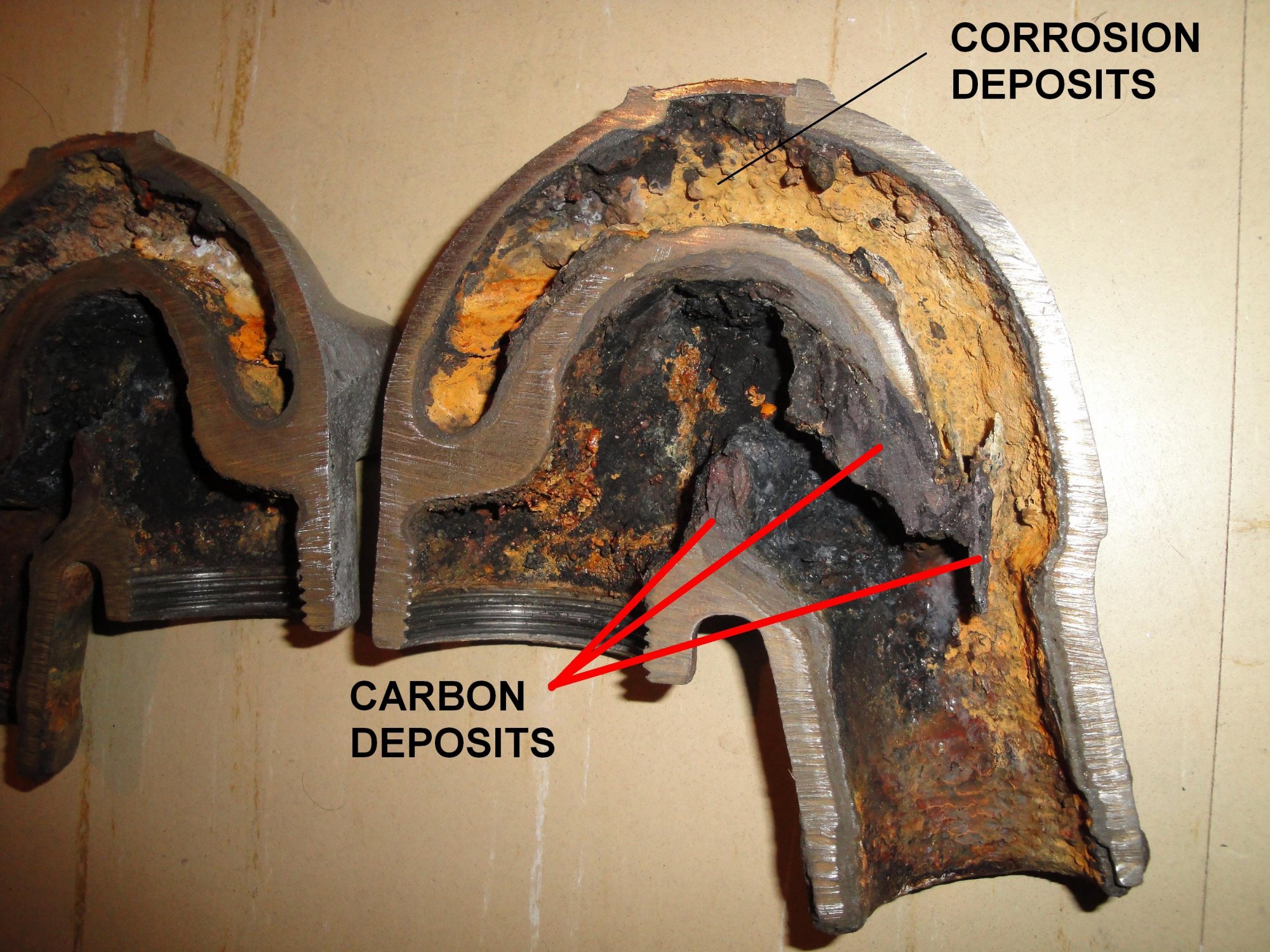

Although I don't have a Yanmar in my boat, the symptoms you describe are eerily similar to the symptoms I had when my mixing elbow got partially blocked.
Jan 4, 2006
7,223
With the right prop, cruise at 5 kts at 2800 RPM. Don't buy a new mixing elbow until you inspect the old one.
This was a mess but hadn't caused any noticeable problems YET.
