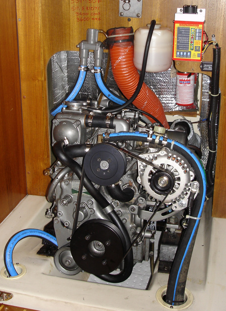

I just did this on my 3GM30F engine. I drained the coolant using the small valves on the engine.
I removed the thermostat.
Using a fresh water hose I reverse flushed the raw water cooling system going in at the back of the heat ex-changer and coming out the hose from the raw water pump. I then reverse flushed the fresh water side of the block going in at the connection for the water heater return hose and coming out at the water heater supply hose.
I then reverse flushed the heater circuit.
I did not use any chemicals to clean the engine.
I replaced the thermostat, and drained all the water.
\ added the long life coolant I bought from the Yanmar dealer, a new mixing elbow and exhaust manifold, all new rubber hoses. A Lifeseal raw water pump back, a new impeller, and a new belt.
I hope this will be good for the next few years, Bob
