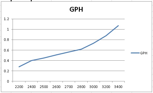

This is a fuel consumption graph of a 2GM20F. To hit 1/2 Gal/Hr, I always do 2600 RPM. If you were just doing 2000 RPM, it is conceivable to get your reported fuels consumption. Remember, it is only just a 16-18 HP engine.

I agree with Benny - we use .5 gph when estimating but actual is .4 @ 2,800-3,000 rpm. The graph above is interesting but not at all what I have seen from my 2gm20f over the past 3.5 years.
