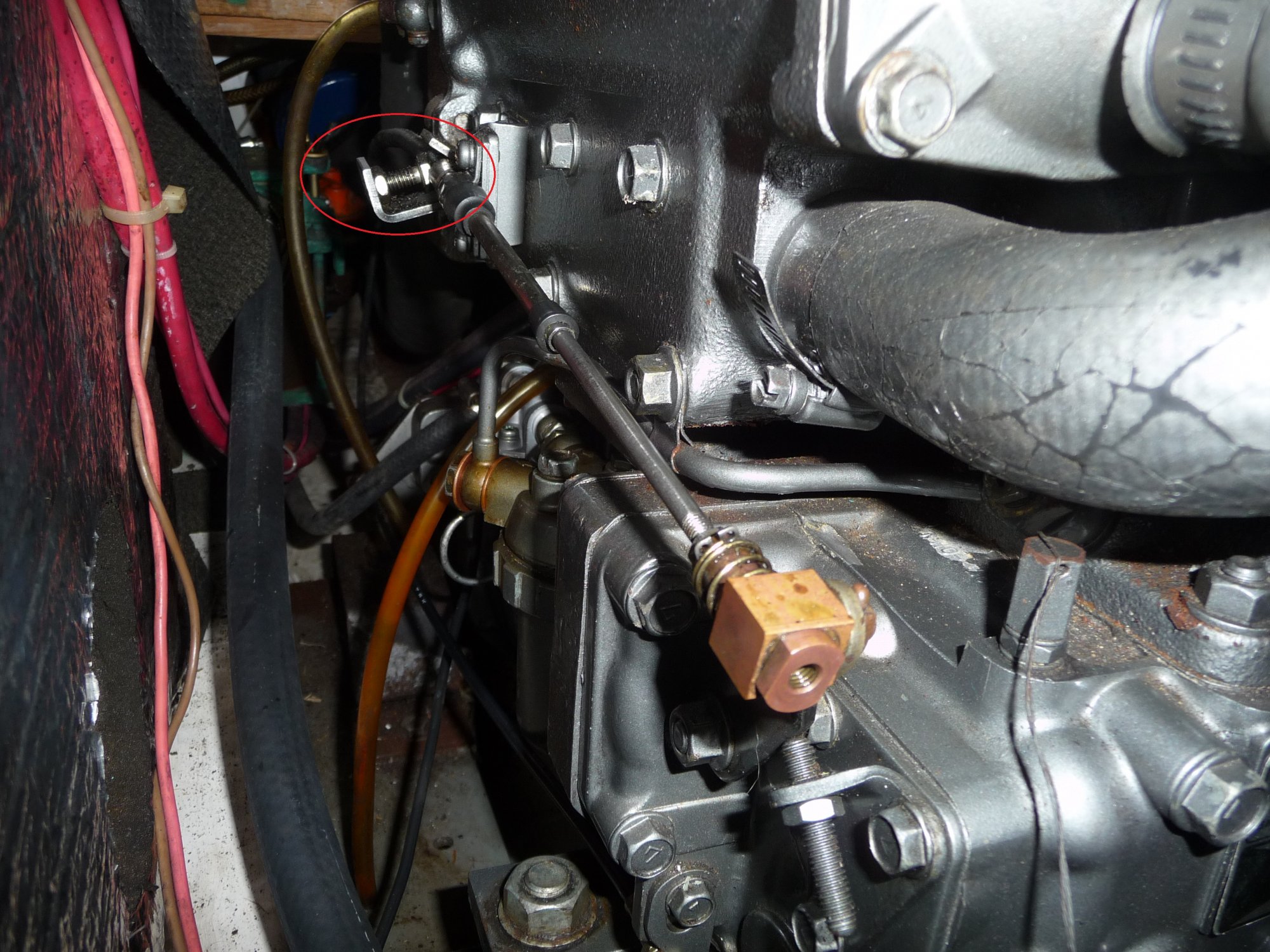

A little stumped here, my yanmar 2gmf13 is running well and strong, however I cannot get it below 1500 rpms, even when I throttle all the way down until lever will not move anymore, it won't go passed 1500, also resistance on the lever when I throttle up, but still works. I happened to notice this the first sail after changing the secondary fuel filter, can't see how this can be a fuel issue but thought I would mention it. Could it just be a loose connection somewhere along the throttle cable?

Check that the speed control lever is going all the way to the mechanical stop. If the throttle cable casing slips in the clamp, it could not let the lever go all the way to the stop.. A drop of diesel may have lubricated the clamp enough to let it move just a smidge.. In this picture, the screw/nut just below the brass block is the idle stop screw. The lever that the brass block connects to should touch that screw at idle. If the lever is not touching, the cable housing clamp (screws right below the red oval drawn in) has probably slipped aft and needs to be repositioned forward so that the lever touches the screw. Loosen the clamp a little, reposition, then retighten. the clamp. This is on a 3 GM, but your 2GM is identical.
It may have slipped at the clamp under the compass but since you were working in the area of the throttle, I suspect it may be the engine side.. Sounds like you may need a new cable or at least some lube to make it move more freely?
