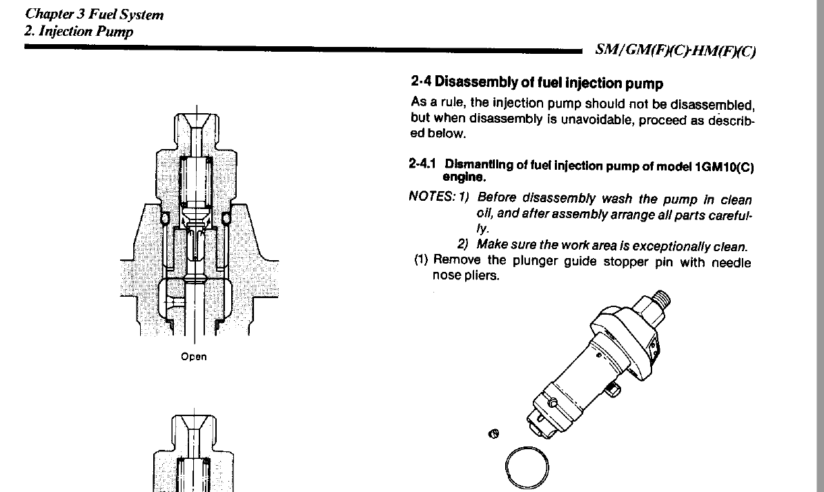

The shop manual I have is for Yanmar mechanics and advises them against disassembling the injector pump.
However, they do advise Yanmar mechanics how to overhaul the pumps if disassembly is unavoidable.

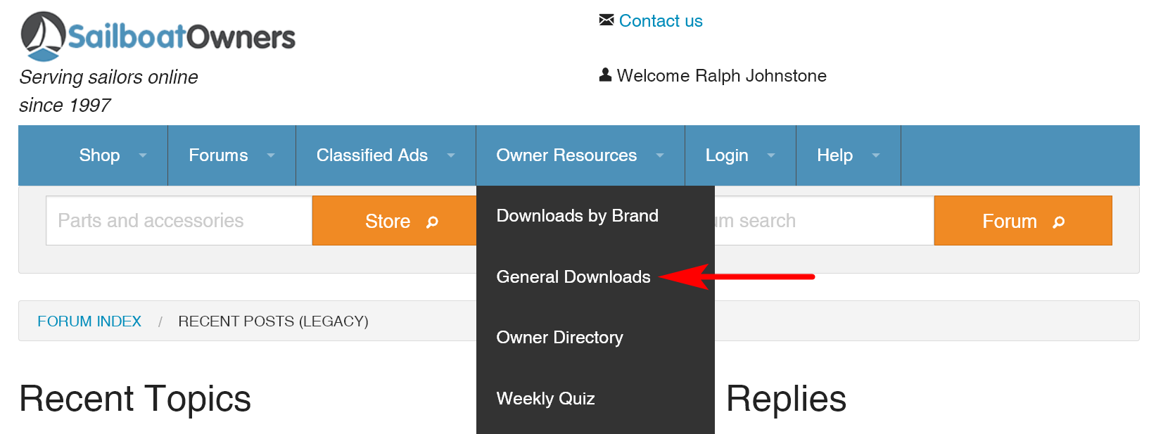

There may be a glimmer of hope yet. I know that I would not be touching the pump but given your situation, you may find some words of inspiration in the Yanmar Service manuals which can be found in Owner Resources/General Downloads :
