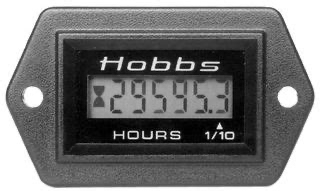

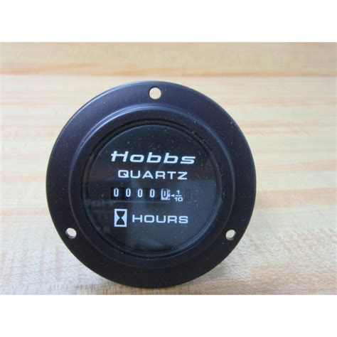

23,792
I do not have an hour gauge on my Hunter
This is an easy fix. Wire a clock (Hobbs meter) to the key switch. Every time you turn on the engine the clock will run giving you feed back when your memory gets foggy.
They come available in digital or analog. I prefer the analog version.
If your 2012 Hunter is like the car owned by the "Little Old Lady from Pasadena" who only took her hot rod out on Sundays to go to church, 11 years X 60 days a year of sailing and 3 hours on average of engine run time would be just shy of 2,000 hours. Your usage could vary.

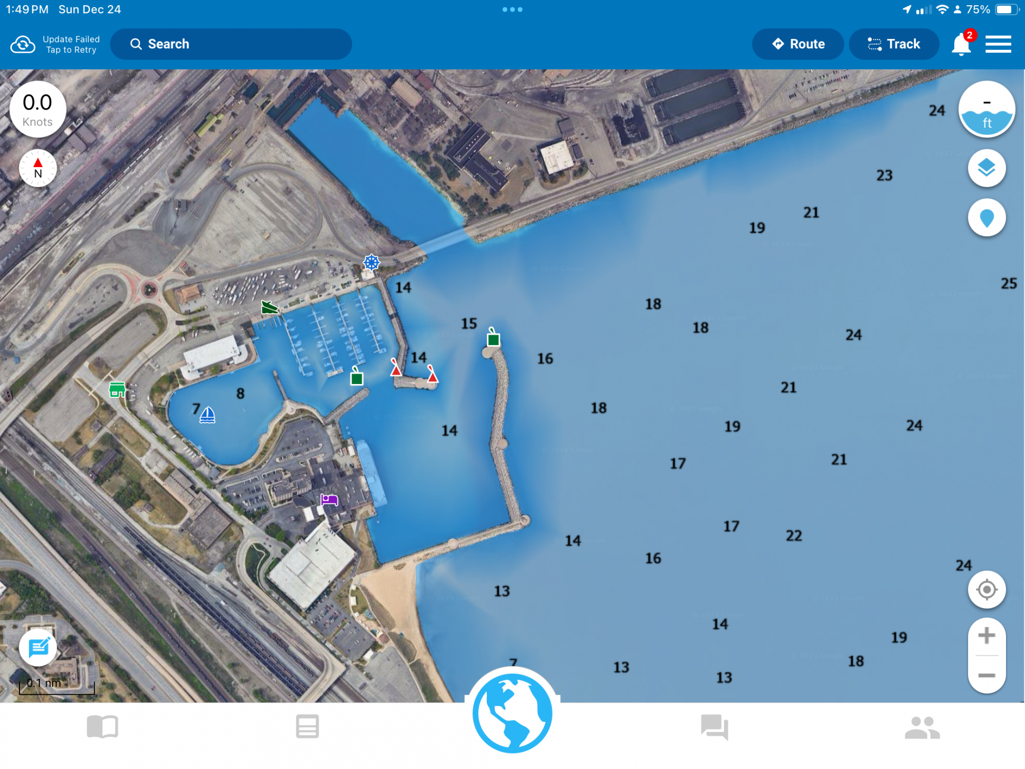

Oday 322 East Chicago, IN
3 hours an outing seems like a lot (at least to me)… I have never seen Lake Lanier, but I assume you can push off and set sail.
My marina location on Lake Michigan requires me to motor out of the marina and set sails in about 15 minutes or less. Same coming back in…
Occasionally I have been stranded out when the wind died or a storm blew in… but 3 hours of motoring still sounds like a lot on an inland lake.
