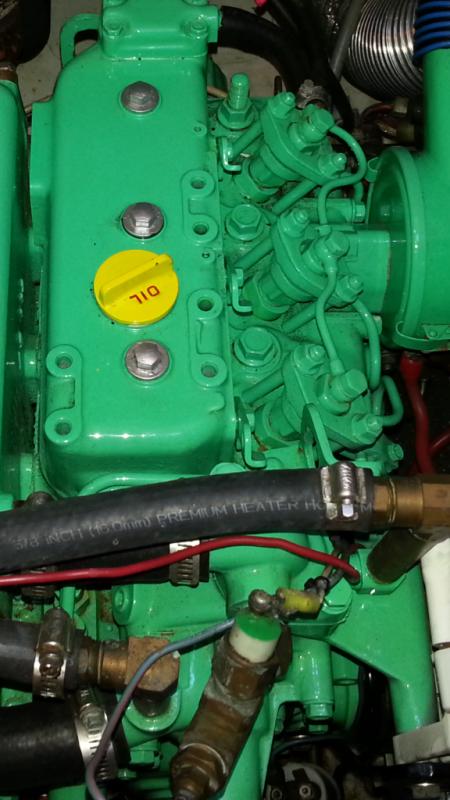

Just an update on this project. I have the engine mostly back together (there's a mixing elbow issue I'll start a separate thread on) with proper marine heater hose running from the FWP to the water heater. All seems to be functioning as intended, although the engine started at 47° and the water temp in the James River was 52°, so tied to the dock I was just able to get the water in the tank up to warmish. I had a temporary section of transparent hose in the water heater loop so I could see when all the air was out of the system. I was very pleased to see how much more water I was seeing come out the exhaust, compared to the old, restricted mixing elbow's output.
Thanks to all for their help and support.
