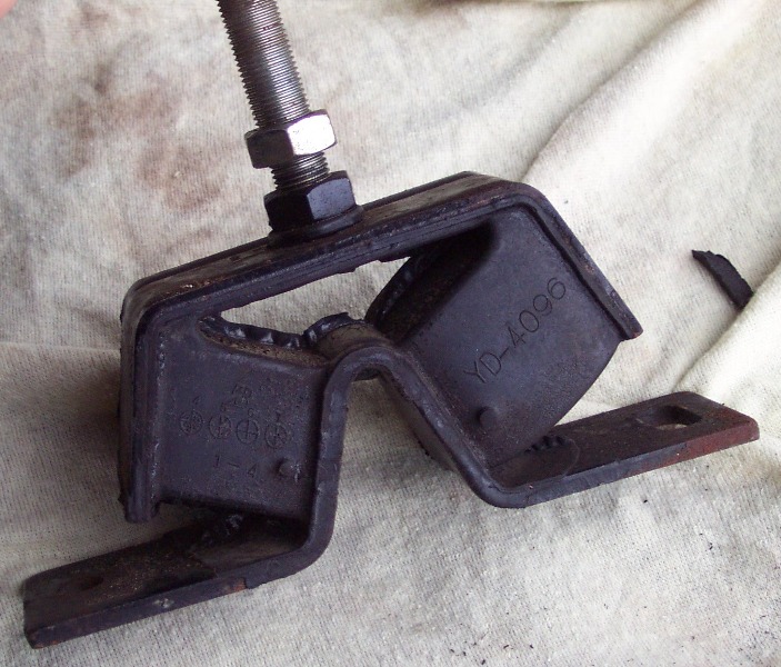

The good news is mounts are available, through Yanmar or elsewhere. You should do some research to make sure you are getting the right ones, don't just replace with same.
The attached picture shows a mount that has bulged one side and needed to be replaced although it was not split or cracked.

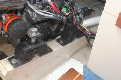

Very interesting....I did some "looking" on the web site suggested for engine parts for Yanmar and the mounts I have do not look similar. I'll have to dig a bit deeper but thanks! Don
1,666
Hunter 34 Alameda CA
Can you post a picture of your current mounts? It could help us figure out what you have.

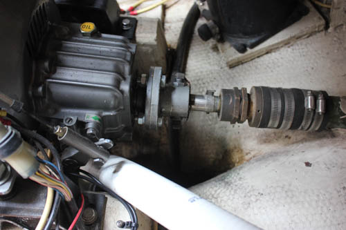

Photos of Yanmar mounts and shaft output
Hope the photos are attached....have not tried this process before. Checked motor mounts and they are snug and seem in great condition. No looseness and no bulges/cracks.
I do have a folding prop but it has a gear device which requires that the two blades open evenly.
It might be a misalignment problem but the only mechanic around town is very busy and is quitting work to sell boat parts on e-bay!?
So, if I knew how to do alignment via a youtube video or similar, I would attempt checking it. Does anyone know a quick learn video on alignment?

Well, those are Yanmar mounts all right. Can't tell much by looking at them, but eventually they can get soft and its easy to move the engine about.
Here's a description of how to align the shaft.

If you can easily move the engine from side to side by hand they are likely worn. If you can pick up the engine from one support point end and elevate it that mount is split and broken. Nice pictures but cannot tell by their looks. Beware of some cleaning products that tend to deteriorate rubber. The prop might be very well designed to have both blades open simultaneously but have you verified it is properly working? That mechanism can wear down and fail to work as advertised. Everything related to that fault needs to checked, do not make any assumptions.

10,095
