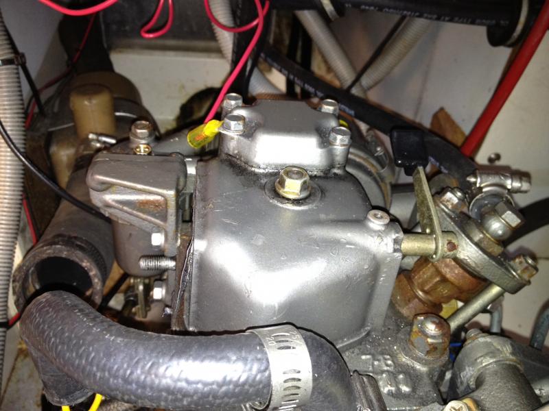

1.) I have a Yanmar 1GH 8hp that has low compression but the valves are working fine (no water in the fuel). Has anyone had this problem?

Pull the valve cover and torque the four head bolts in a cross pattern to 54 ft lbs.. then make sure the valve clearance is around .008" .. check to make sure the decompression peg is fully out of the way. Make sure the injector nuts are tight.. even torque to 15 ft lbs..Those are a longshot, but may get it cranked.. If the rings are a bit gooky, running it a bit.. hard after it warms up for 10 minutes or so.. may get things to be a bit better.. Good luck

Nope, no flags but I'd have to put hands on to feel and listen.. If you aren't comfortable with messing with this, find a friend who is good (not just says he is good, he actually should be good) with engines. This one looks pretty easy to access and the stuff I talked about can happen by undoing that one lonesome nut in the middle of the valve cover, just to the left center of the picture. Get a Yanmar mechanic to look at it otherwise.. BE sure to pull out the fuel cutoff if you are turning the engine over.. The little lever sticking out of the cover on the left is the decompression lever. When it is rotated, it holds open one of the valves and keeps the engine from having compression.
