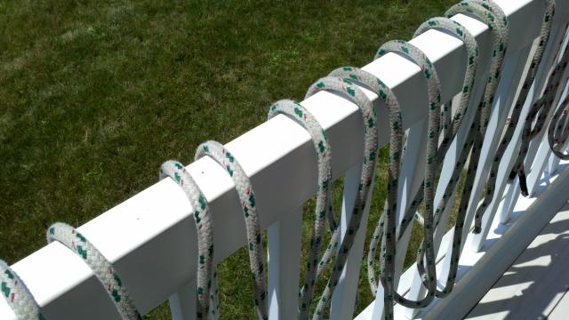

My sheets, pictured drying on the porch, are also New England Sta-Set. I went with two, each 45', one with green fleck the other red. But mine are 1/2".
