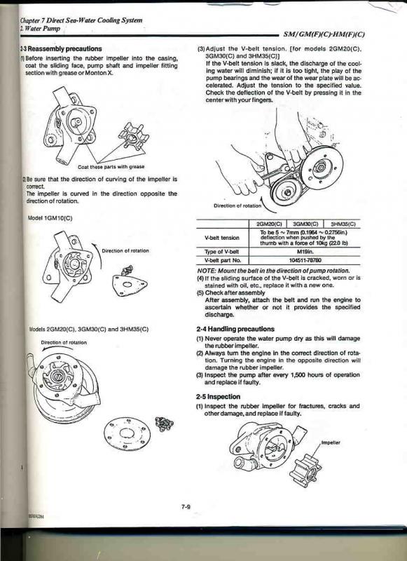

I am about to replace the raw water pump impeller on my Yanmar 4JH4E engine. The prior owner of this boat took immaculate care of her and to his credit marked page 45 in the Yanmar manual, which states: "The seawater pump turns counterclockwise, BUT the impeller must be installed by turning in the clockwise direction . Throw me a bone here, I have been putting raw water pump impellers into marine engines since I was a kid, always with the vanes set to the rotation they would soon follow on engine start; I should do the opposite in my little Yanni?
