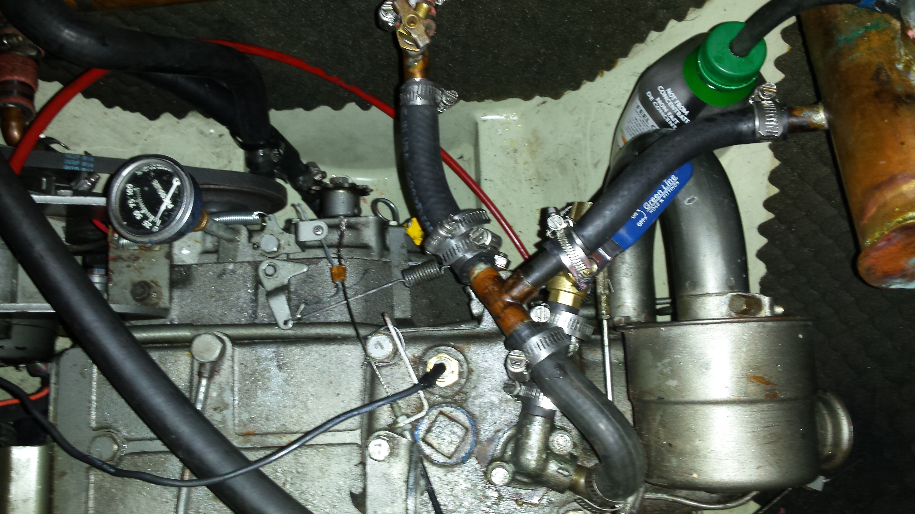

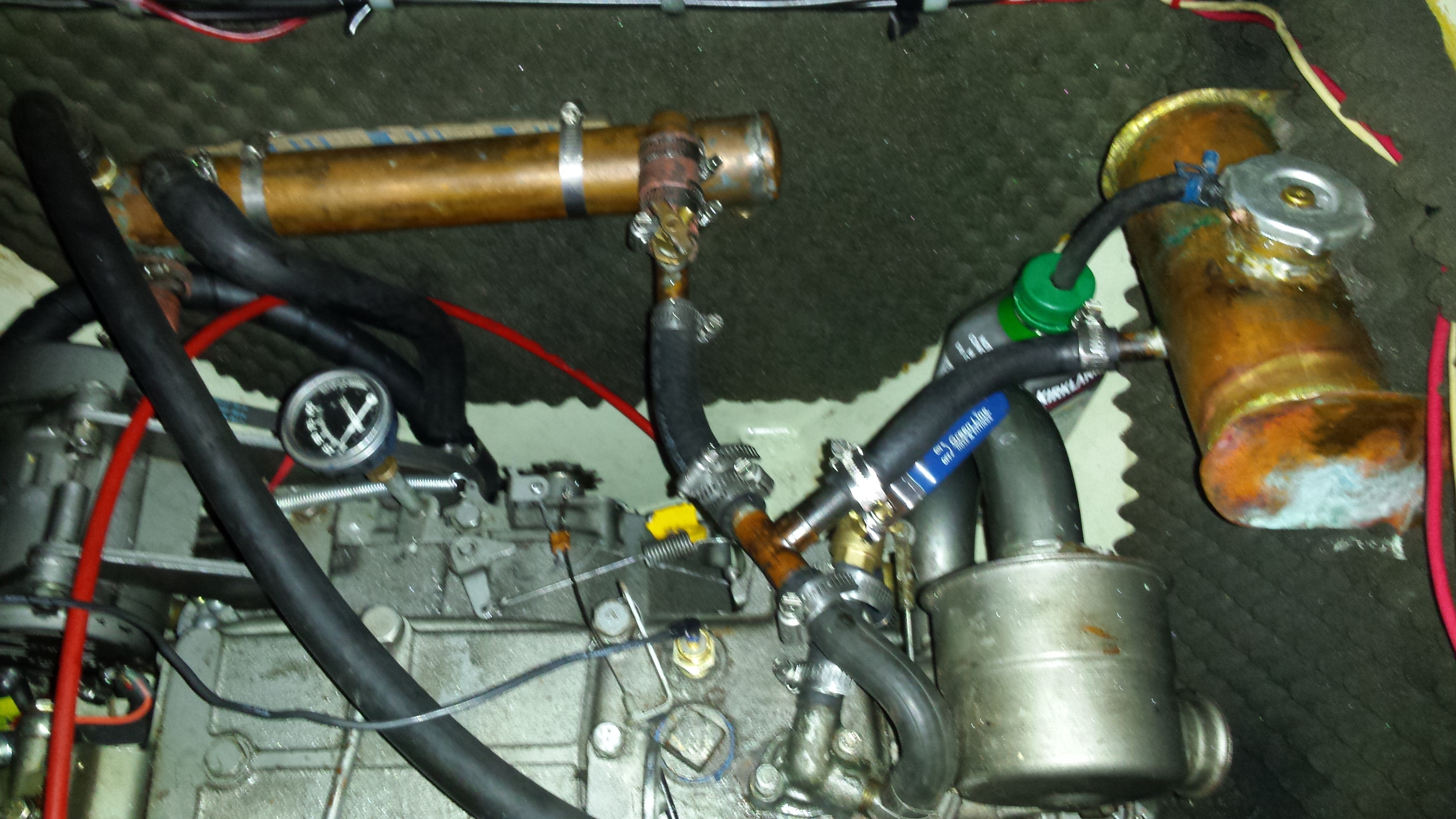

He replaced the raw water pump with a dual water pump. Raw water in, pumped to a heat exchanger (on the forward engine bulkhead), with the coolant pump running the other side of the pump. There is now an expansion tank on the starboard engine bulkhead, with the various hoses doing their thing. I should say that the heat exchanger is only approx 12 inches long by 3 inches in circumference, and the expansion chamber is 4 inches in circumference by 8 inches long, so that fit easily in the engine compartment with plenty of the original working space. Even the hoses are fair to navigate around. I can send photos if you like.
