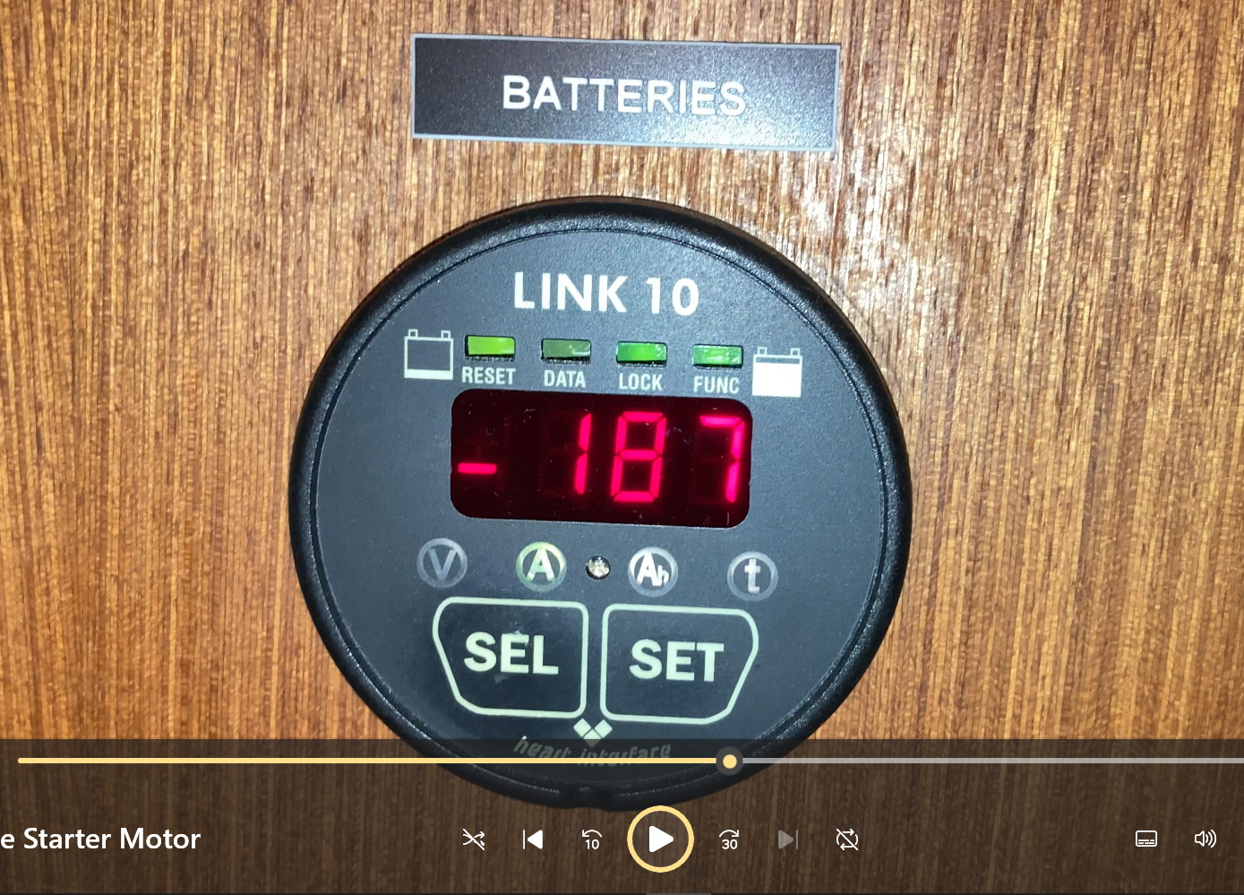

Your 2GM starter relay will pull about 20A when starting. The starter relay and starter motor will pull :
............. when they are cranking.

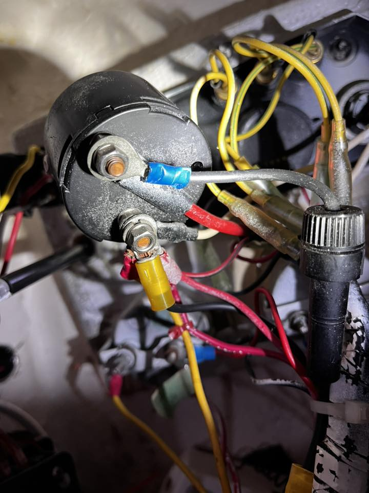

The switch only has to power the starter solenoid which carries the heavy load of the starter.

I dont see a single wire in there that could handle 30A long term. I think I see one 12 guage that would handle the 20A load that you speak of

I replaced mine as well last year.. it kind of crumbled. As some have said, the solenoid relay (little black box on the port wall of the engine room) does all the heavy lifting for load, and I just used a standard ignition switch. Worked just fine. The Yanmars are a bigger diameter that fits the original hole so I'm glad you got an OEM relatively inexpensively. I think it's a better choice.
