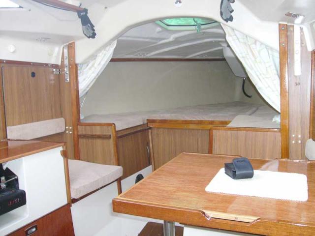

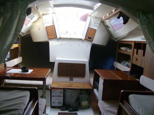

Would like to ask if ok to contact you later in case i need some more specific photos of the interior.
I'm doing renovation now and would be great to have pictures for reference.

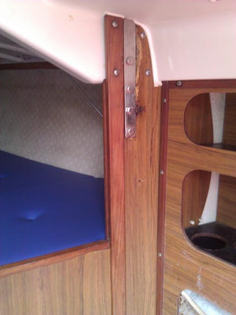

For instance, i need to replace the wood pillar on both starboard and port side. Is it possible to remove it (all the bolts and screws) without being worried with the weight on the cockpit (it seems that area its part of the structure to hold the shape of the boat)?
Thank you

Please feel free to ask me whatever you need.
I am not sure about correct terminology. Do you mean plywood bulkheads near transom under the cockpit? Rear bulkheads does not support cockpit anyhow. My boat came without port side half-bulkhead and cockpit is OK. Starboard half-bulkhead also was removed during boat's restoration and I have not seen any problems with it.

the pillars im talking are the ones, in port and starboard side, near the curtains (in the picture of your boat.

I am not sure, but I think this parts is not critically important in hull's or deck shape supporting. However, you have to remove the mast first if you want to replace this parts because they hold almost all load from shrouds.

Hi and welcome aboard... If you are talking about the bulkhead pieces with the chain plate bolts etc... I would not remove them... I would have to say this is very integral to your boat in many, many ways...
Good luck
