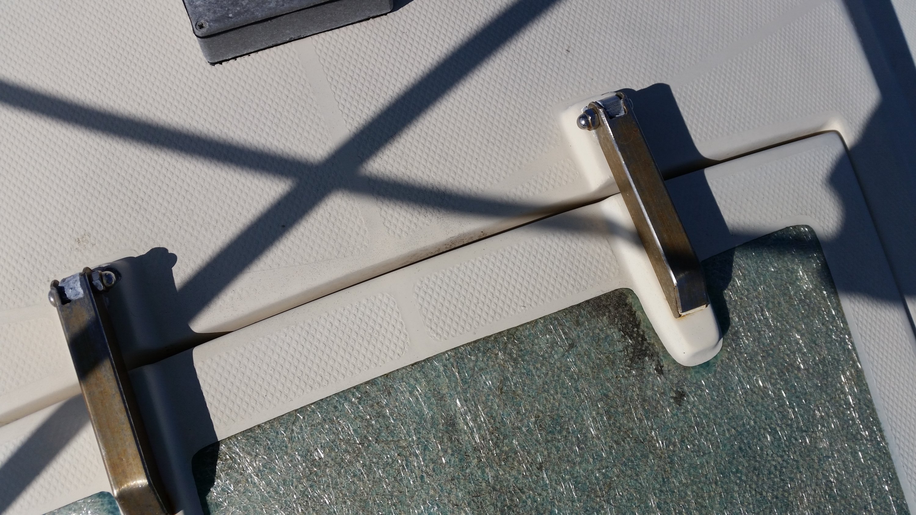

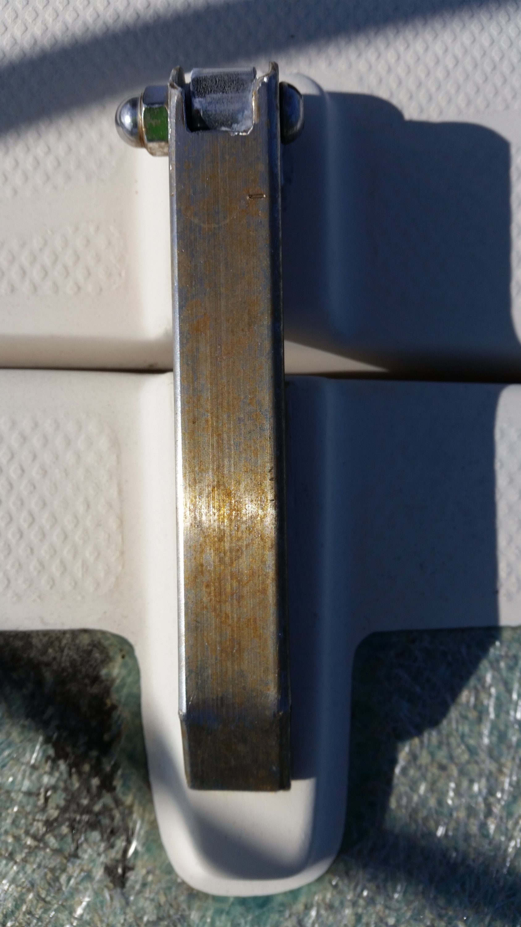

Front hatch hinges,like you, I tried few places and internet and ended up making them myself of 3/4 square pipe and about 1/8 wall thickness.They do not look the best but they do the job
Great solution Furdui!
Mine are hanging in, but the end is easily in sight. Now I see hope for replacement. Whew

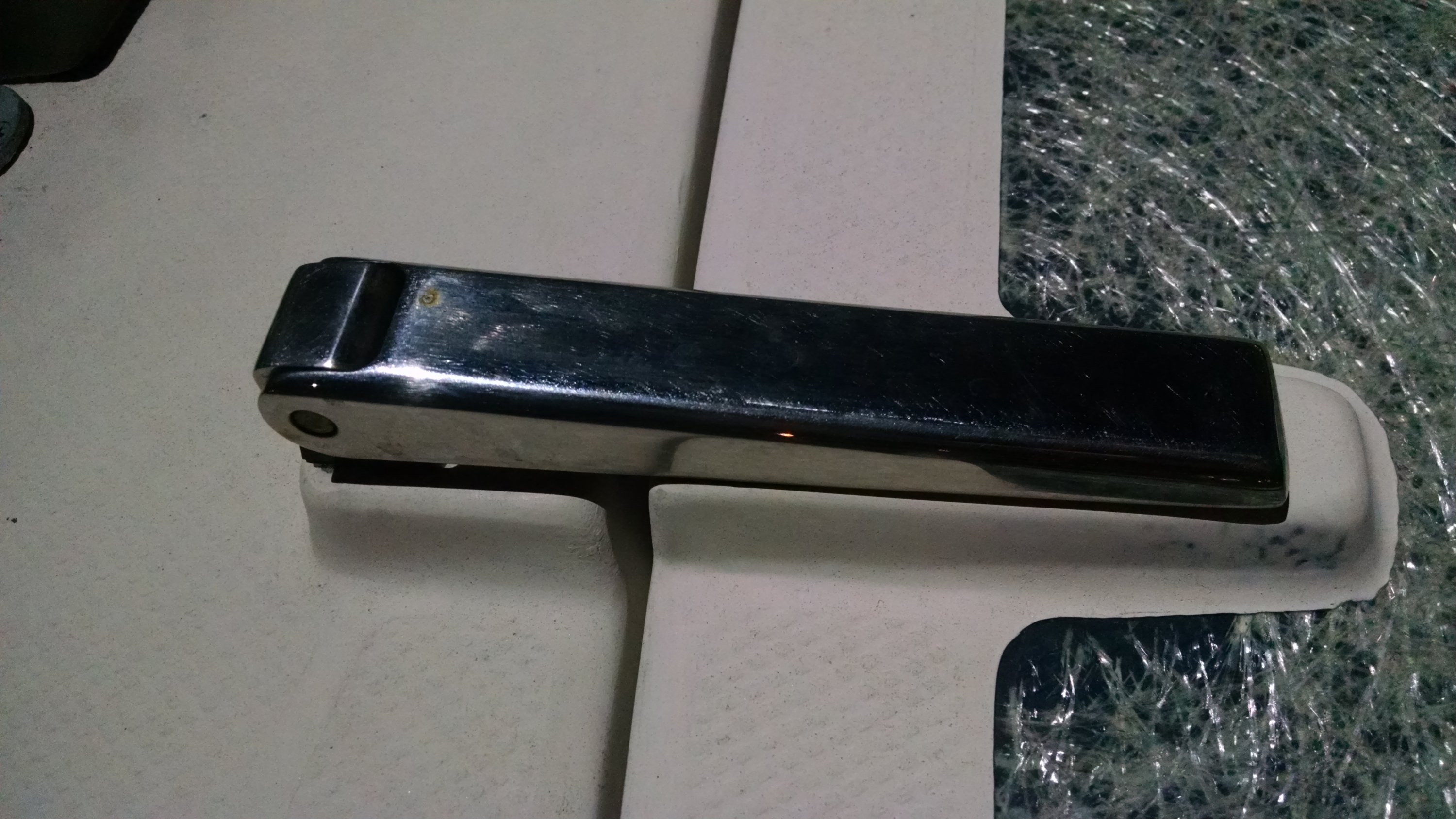

Wow, looks like the world wide solution! My friend ( a welder/fabricator) and I came up with the same idea using 1 inch stainless square tube cut diagonally. Only difference is a whole lot of polishing!!!!
Nice job Furdui!
P.S My friend always believed " if your going to do something - do it to excess !
Nice job Furdui!
P.S My friend always believed " if your going to do something - do it to excess ! View attachment 128185 "
Wow,your friend is a professional!!(or he owes you big time) ,it looks great.
Then the question arises,does'nt he want to make a nice profit by offering them for sale?,I (and possibly others)would be a client.

Unfortunately he passed away a number of years ago, and yes he was a master metal magician. Any good metal fabricator / welder will be able to duplicate the process. It requires two machined bocks be welded in place to accept studs for bolt mounts. Which y25 did you buy? Thought I new all the boats in the area. With a bit of time I can get a drawing done of how it's made. Furdui's design looks the same just not a shiny.... Furdui are your mount points welded in place or did you figure a way to bolt it together?

I've reused the fix part of the old hinge,would be nice to find the tube with inside dim. equal with the width of the holed head bolt,otherwise spacers on each side.
I made them in a hurry in one afternoon with a angle grinder and a cordless drill.First the top end and taper,then have the hatch in position,the hinge connected to the fix part,some weights on top,(I was singlehanded!),marked the fixing holes from underneath,drilled them.With a bit of patience,a flat head screwdriver,position the nuts one by one inside tube and screw tight two 6 mm bolts from underneath.Tapered part is nicer welded and ground.Same silicone inside tube takes care of waterproofing and locks the nuts.
