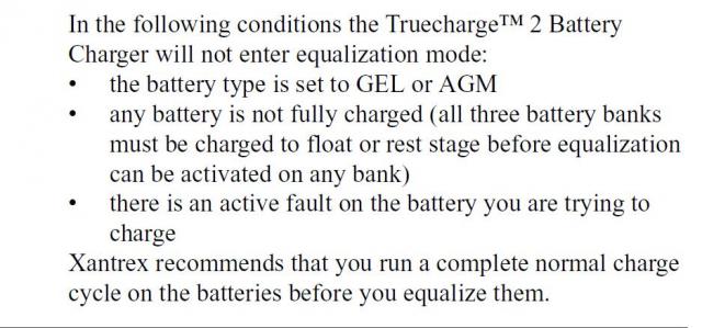

I believe you can manually equalize the batteries with a Xantrex TrueCharge2 charger, which may require setting the charger for flooded. Below from the manual:
