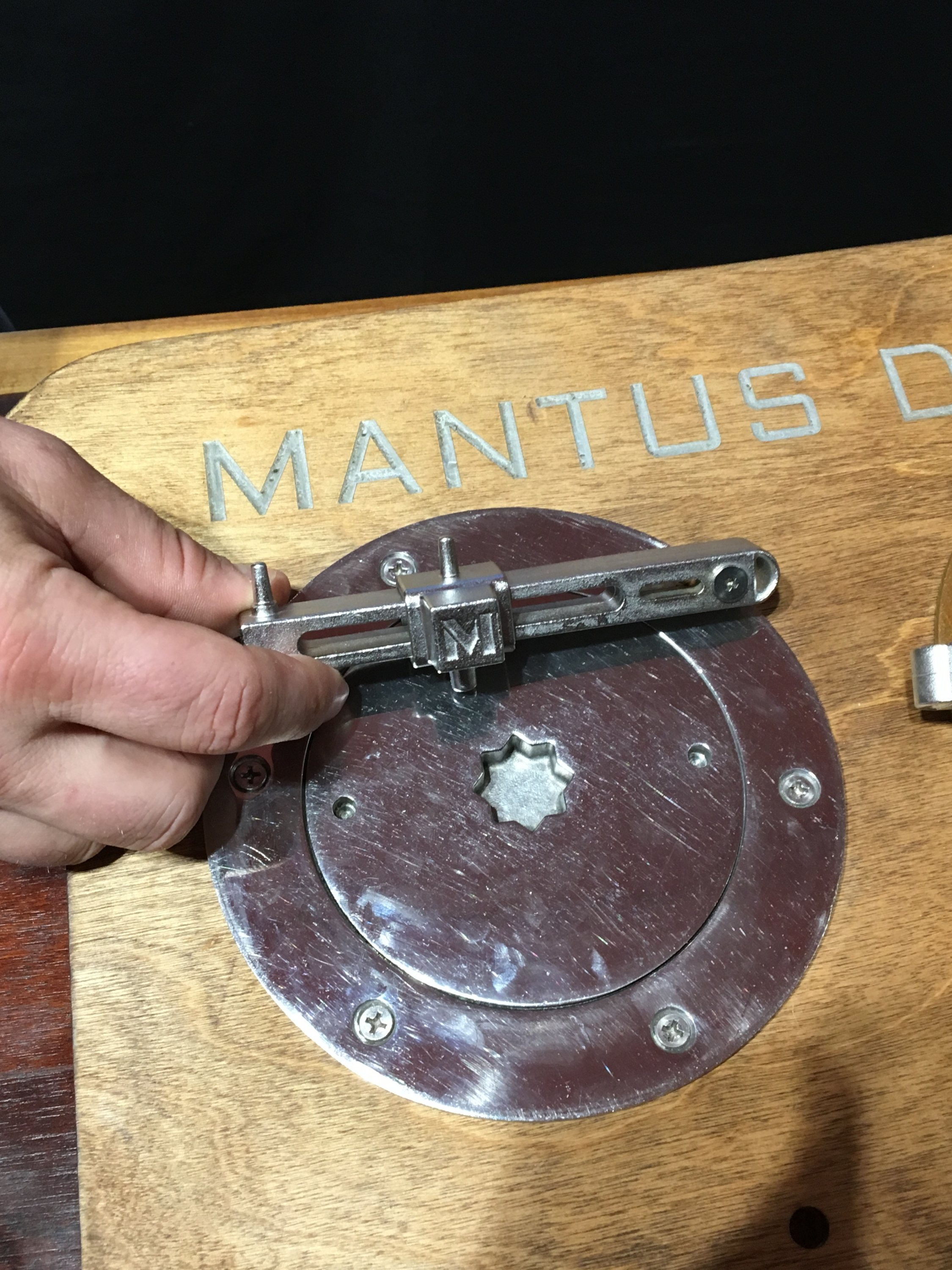

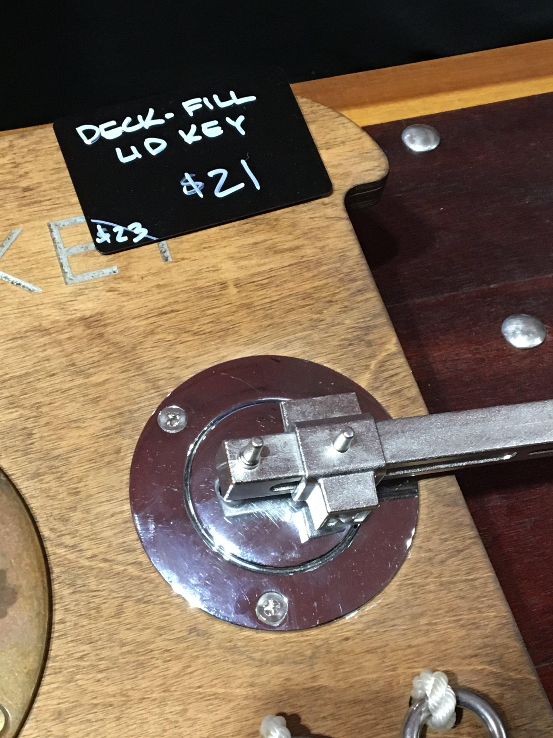

Beneteau USA Parts in Marion, SC sells a double-ended tool. One end is the water/waste fitting, and the other end is the fuel fitting. Last one I bought was <$20.

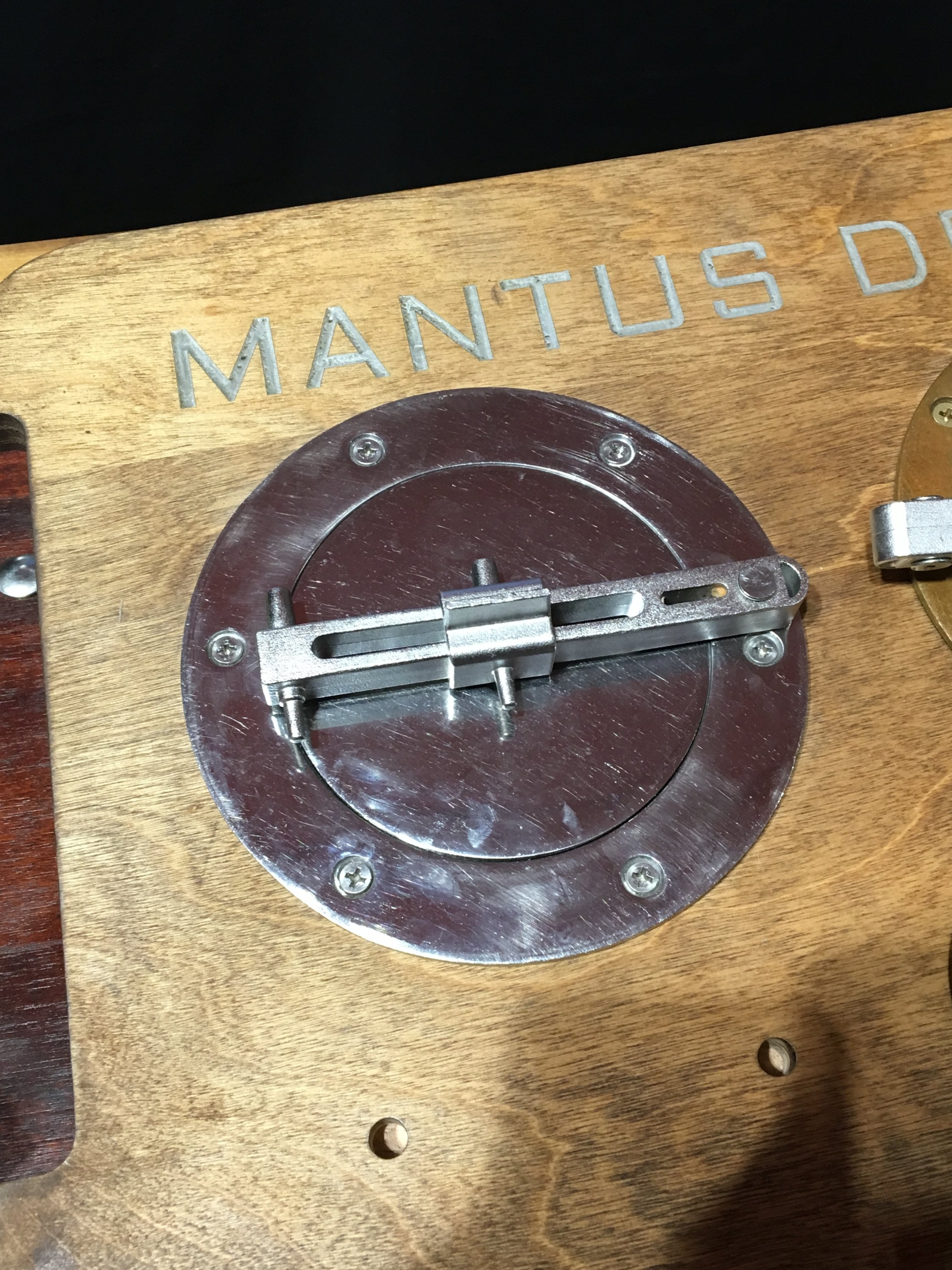

4 functions 1) small pin 2) big pin 3) Star (winch handle) and 4) straight slot.
