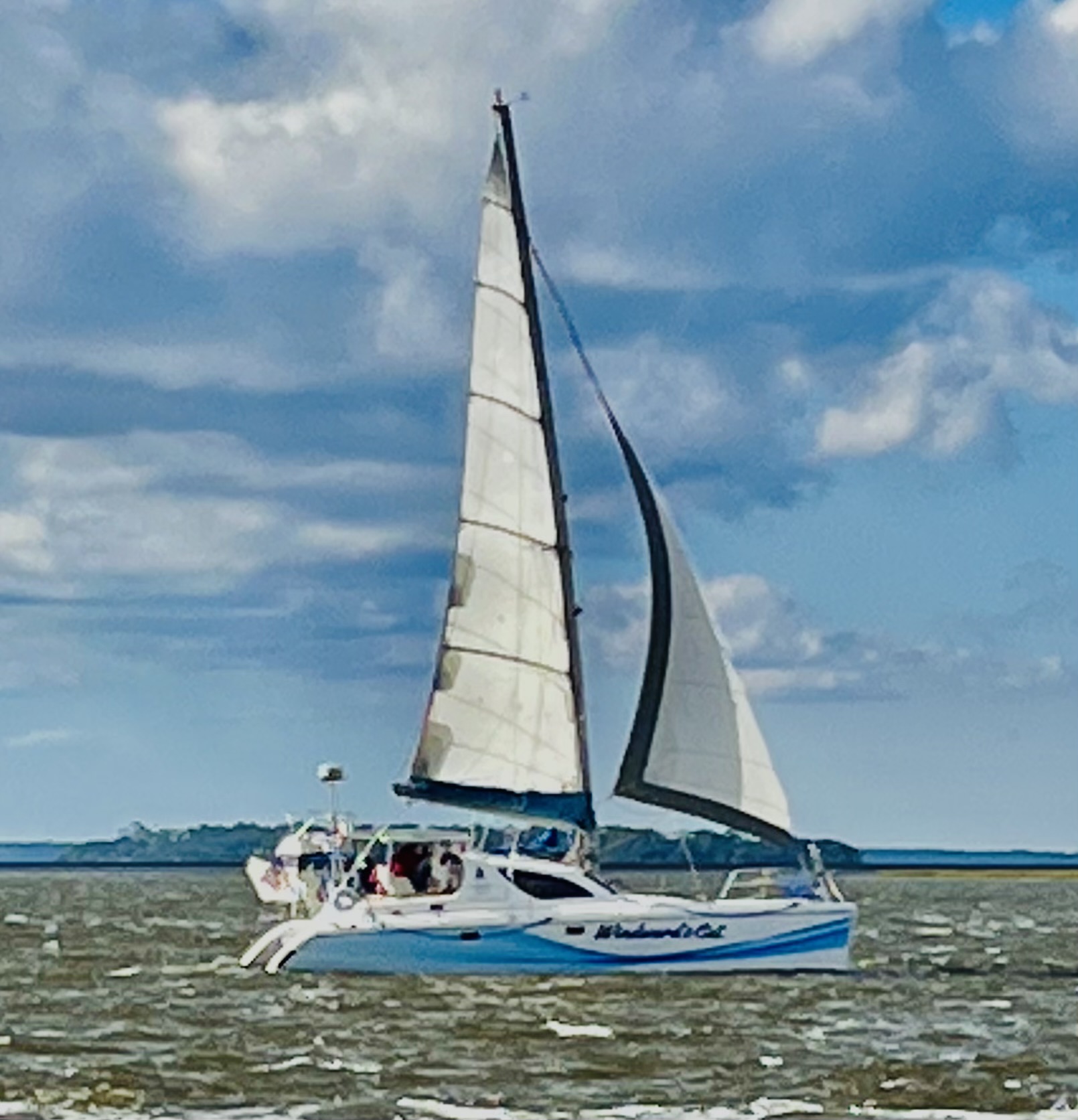

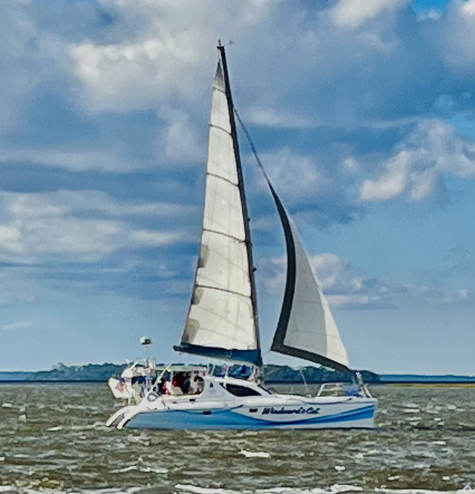

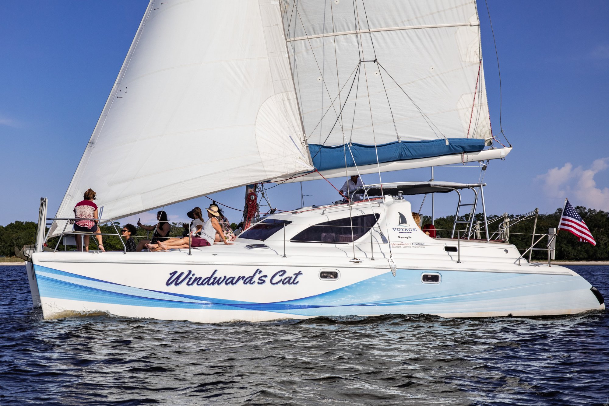

We wrapped our 2000 VOYAGE 37' CAT 3 years ago. It's not a full wrap but does cover 80% of both sides. It updated the looks of the boat by years. Total cost was $1740, including labor. There is very minor dock rash, which happened in a close hurricane. We use velour covered fenders. This is a captained charter boat which is used extensively year-round. The wrap was done in 4 pieces per side, so we can replace any single section as needed. We always dock on starboard, with the helm being there, so the port side is perfect. If you're not great at docking or have rough docks, I would not recommend.

That does look very slick. Definitely sets your boat apart. Have you ever had to remove any sections? If so, how did that go for you?
