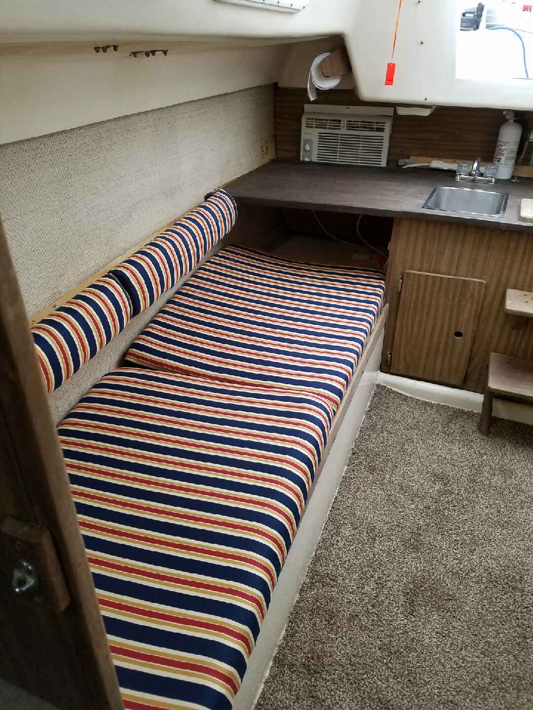

This is what the previous owner did in our O'Day 25, works pretty good. Drains to a bucket to dump overboard each morning. I might try a less make shift drain system and seal up the install a bit better too.
