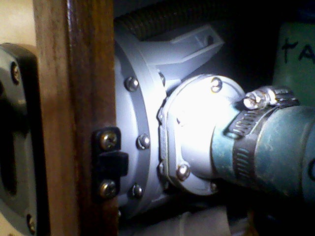

I've attached some pictures of the plumbing system on my Hunter 31. I don't know if this is all OEM or the PO had some work done. I am thinking of replacing many of these hoses with solid pvc to the extent possible based on the notion that they are very old and probably contributing to my head odor. I am going to flush/sanitize as Peggy suggests before I make a final decision.
1. Picture 1 is the pumpout lever, which does not want to move. I don't want to pull to viciously on the extension handle because it is a plastic pump. Is there some secret to this?

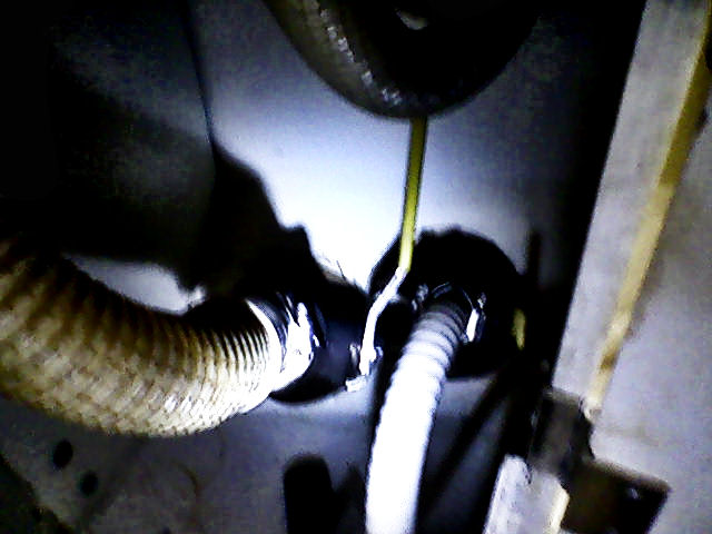

2. In picture 2 there is a handle but I don't know what it does, nor can I get it to turn. Does it press or pull before turning? What does it do.

It has been a while since I messed with this stuff, but photo 3 appears to be the thru hulls. The forward one is the discharge and the aft one is the raw water intake for the head.
This is a complete replumb job. The original from the factory was different but as I remember you could pump directly overboard or pump into the holding tank.
The hose that is being used on this system is NOT sani hose and should be replaced. I suggest that you remove the manual (plastic) pump and install a macerator in it's place. You can probably simplifiy this system with a little work.
