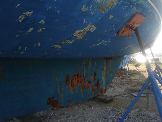

Working on many items. Any idea on where to start on a keel. the glass is in rough shape. Anyone have any idea on ball park price to bring back to life. No leaking in bilge, rust is poking through. thanks jim

The keel came from the factory with a coating that is 1/8 to 1/4 thick that needs to be removed because it is rusty underneath. I used a hammer and chistle to remove it. The only correct way to delay rust is to sand blast the iron and coat it with epoxy within one hour. All the magic chemicals and converters help but you'll see rust back in a year or two. I tried Pedit Rustlok, Rust Converters,and VC Tar after grinding all the rust off and the keel was orange in a year or two in fresh water. Do it right or just paint over the rust every year

Jimmy: Interlux has a system for cleaning, preparing & sealing your cast iron keel. The real key is to get the iron shiny bright and seal it!

I hate the looks of the rust on my 1990 H33.5. *grr Every year I wire brush it down and paint. My question is, what is going to happen down the line by not fixing it the correct way as Daryl says?

I had a long streak of rust originating at the keel joint, in the bilge area both aft and forward of the bilge. It looked much like the one forward in your photo (at least as it appears). I drilled into there and found a large void between the keel and the hull. Water came out of that void when I drilled into it, right at the rust spot. I cut away the whole area and filled it with solid epoxy. If in fact yours is coming from the same place, feel free to email me. I'm currently underway so use this email address: wiltjerpottery@yahoo.com Rusty Wiltjer S/V EarthSpinner Hunter 34
