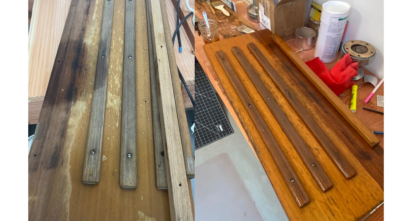

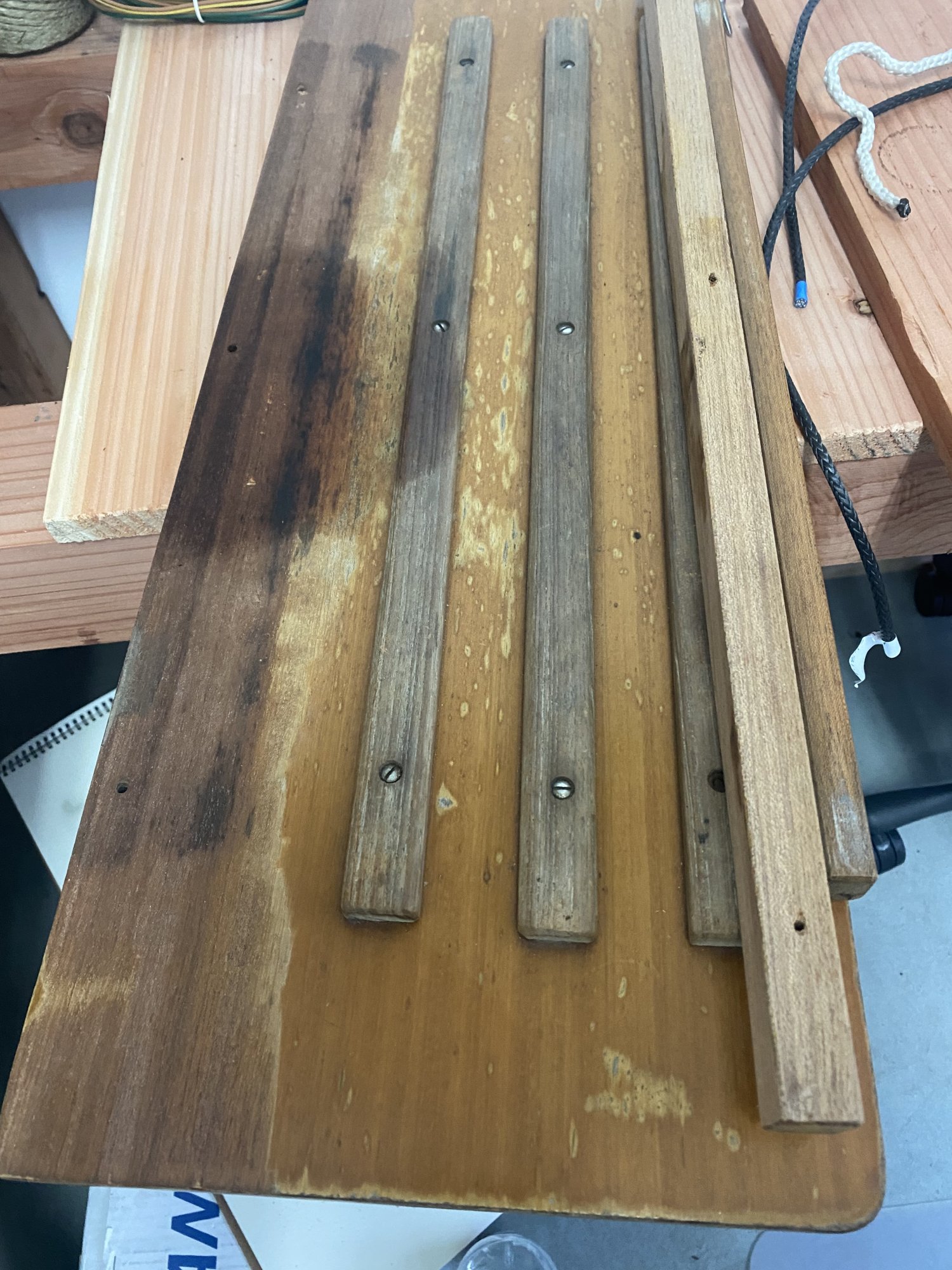

I have a companion way, I was going to replace the worn out sound proof bit of it so I took it out.

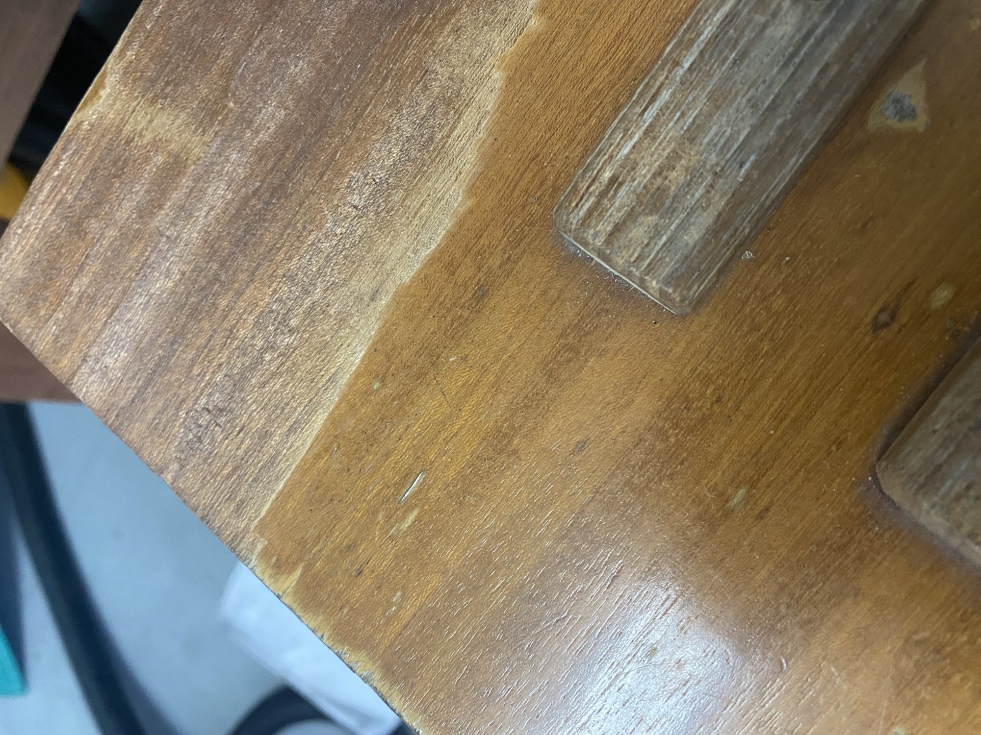

I planed the "dark" area of the step which was damaged, I assume that is the color of the wood.
The light area is what the wood looks like in the boat. I did not sand/plane it.
So my question,
1. Do I have to "stain" the wood to get to that blonde ?
2. What are my chances of matching ?
3. Should I just F&34 it put some varnish and call it a day.
The sailboat is a 1975 Dufour 34 so I am not looking for museum quality here.
Thank you

Sand it all off. Multiple coats of de-waxed blonde shellac then varnish. Make sure to use de-waxed shellac. Best way to get what you want is to buy it in flakes, dissolve it in alcohol to the tint that will best match what you are looking for.
Oct 19, 2017
8,005
You have a little extra wood, so try a couple of samples first to hone in on the best mix.
What you are looking at are weathered wood, sun and grease stains. Try cleaning it up with lacquer thinner or acetone, then sand sand sand.
New wood takes awhile to catch up with old wood, but it should eventually blend right in.
Of course, the varnish will also darken the wood a little.
-Will
Thanks for the Shellac tip.
Looks super nice.
