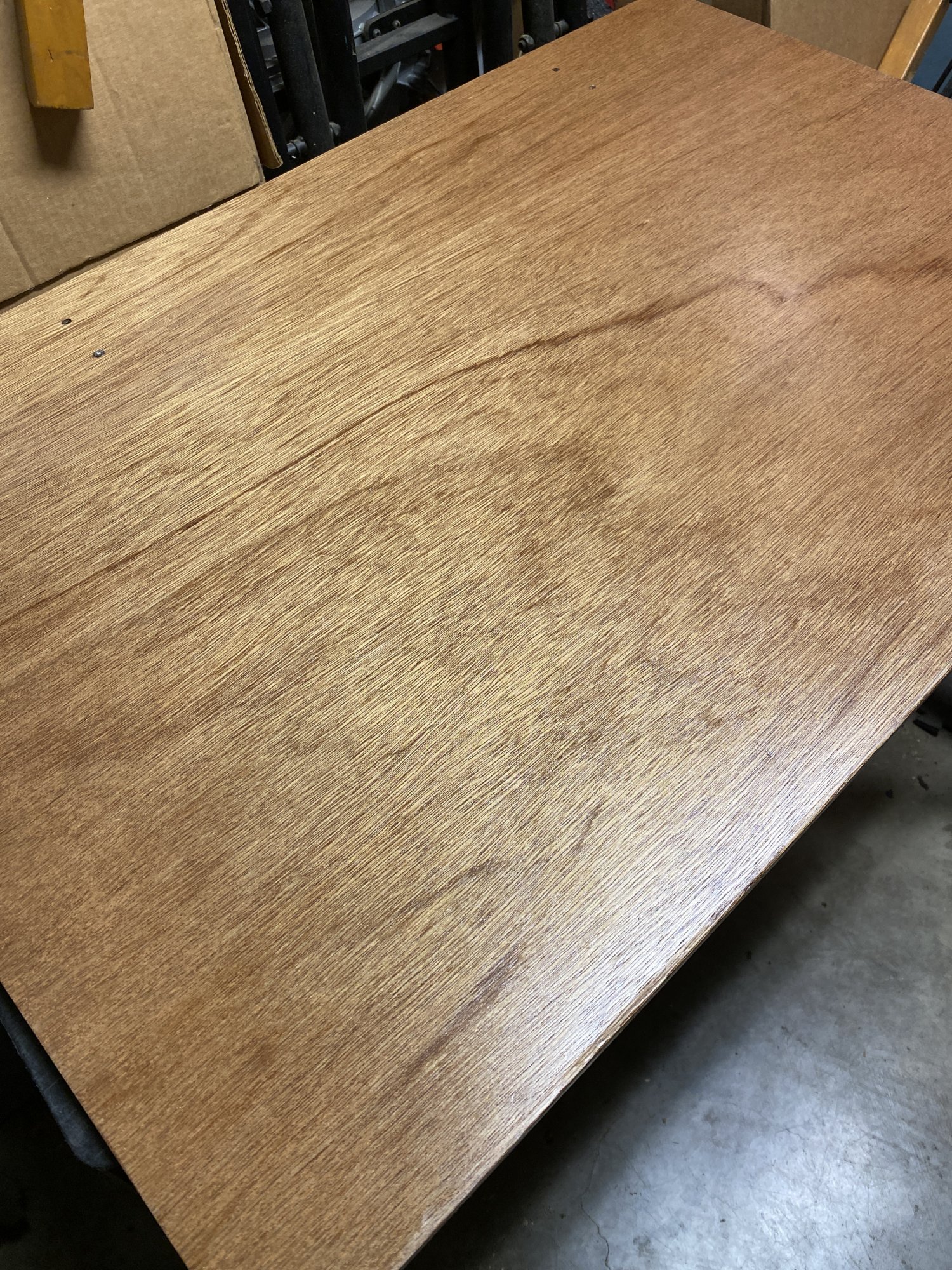

Just completed 8 coats of satin varnish on an engine panel.
It is mostly ok.

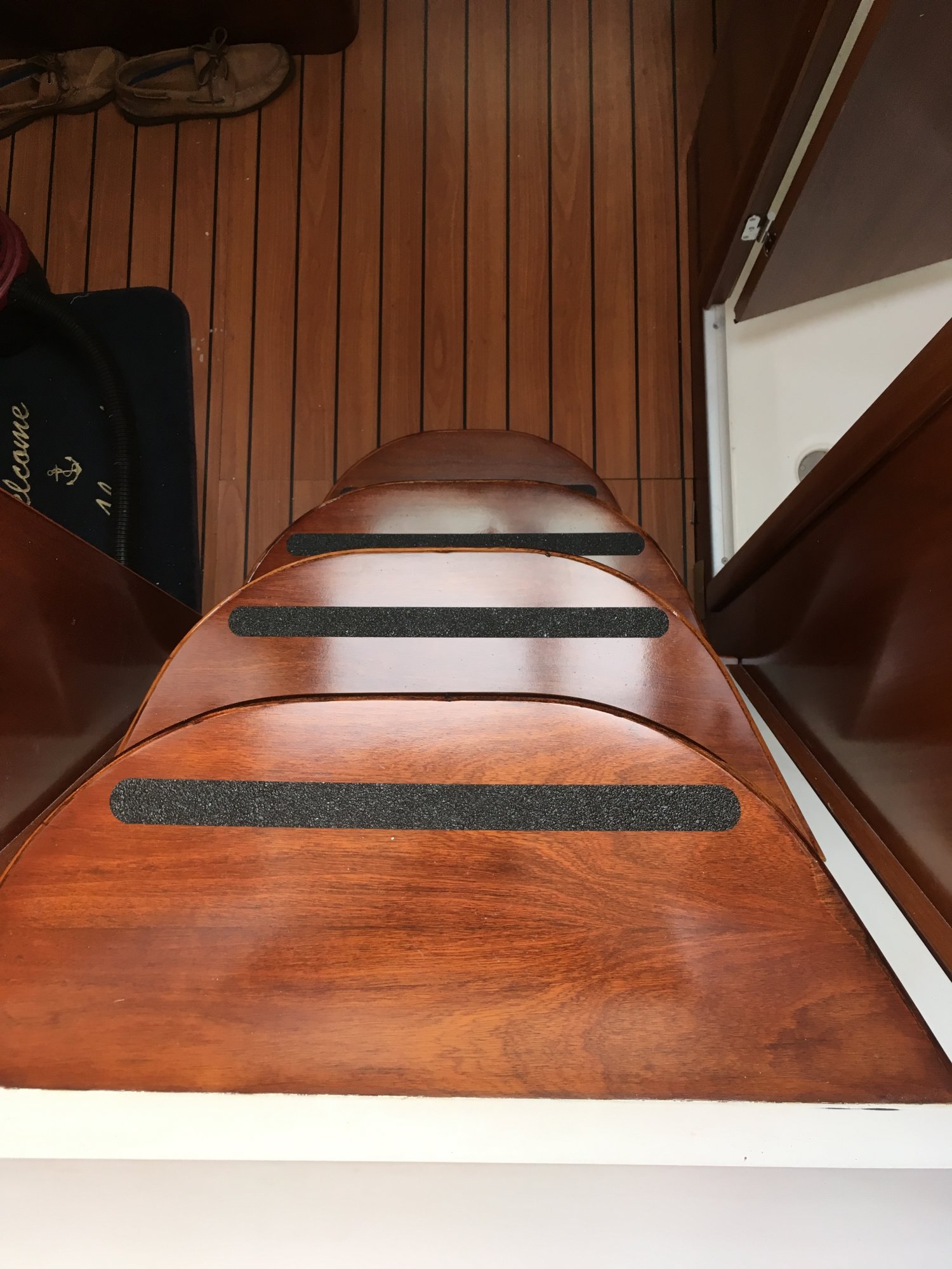

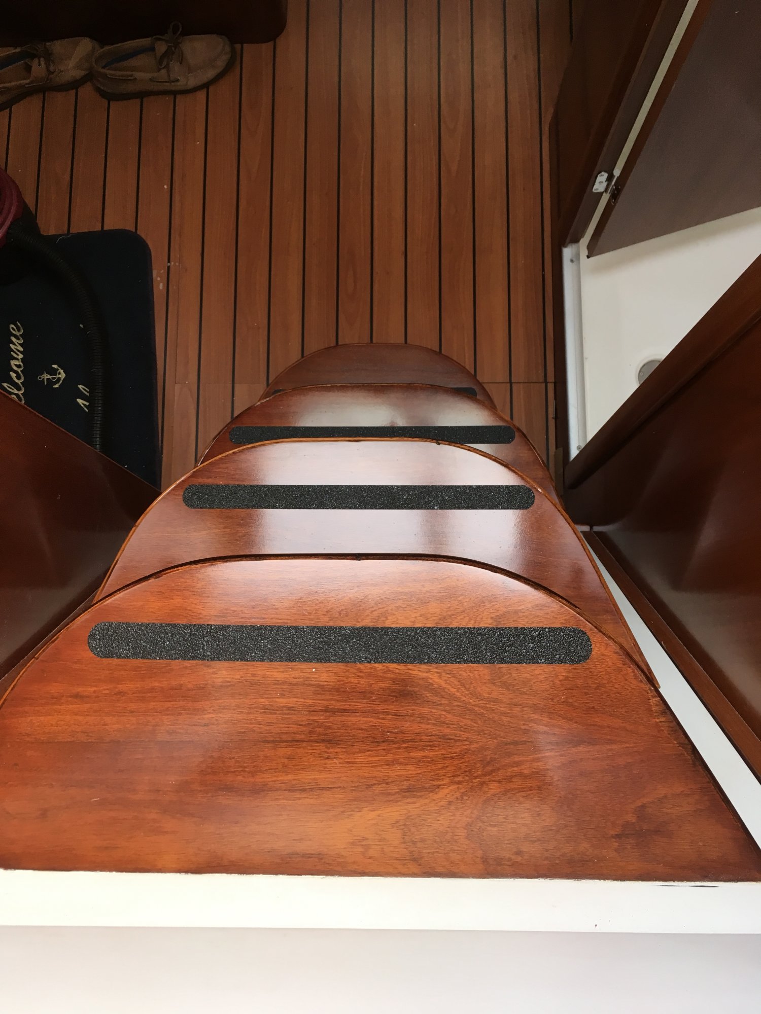

I refinished the companionway ladder a few years ago. After staining, I applied 4 coats of minwax/helmsman spray poly (gloss). Light sanding between coats & very light buff with bronze/steel wool. Final machine buff with aqua buff polishing compound. Result was a deep Semi gloss finish.BAA22A16-AACB-4886-8523-AD72F691D8AE.jpeg

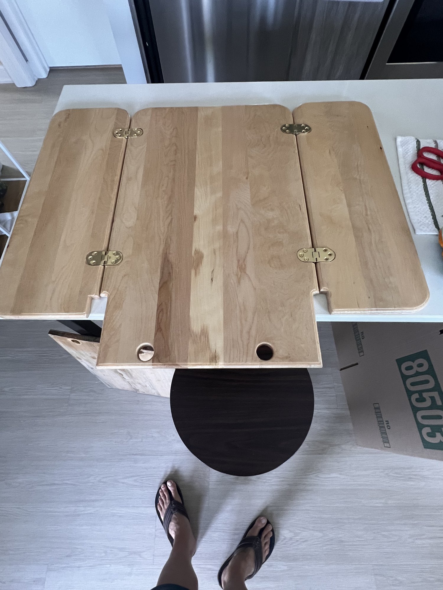

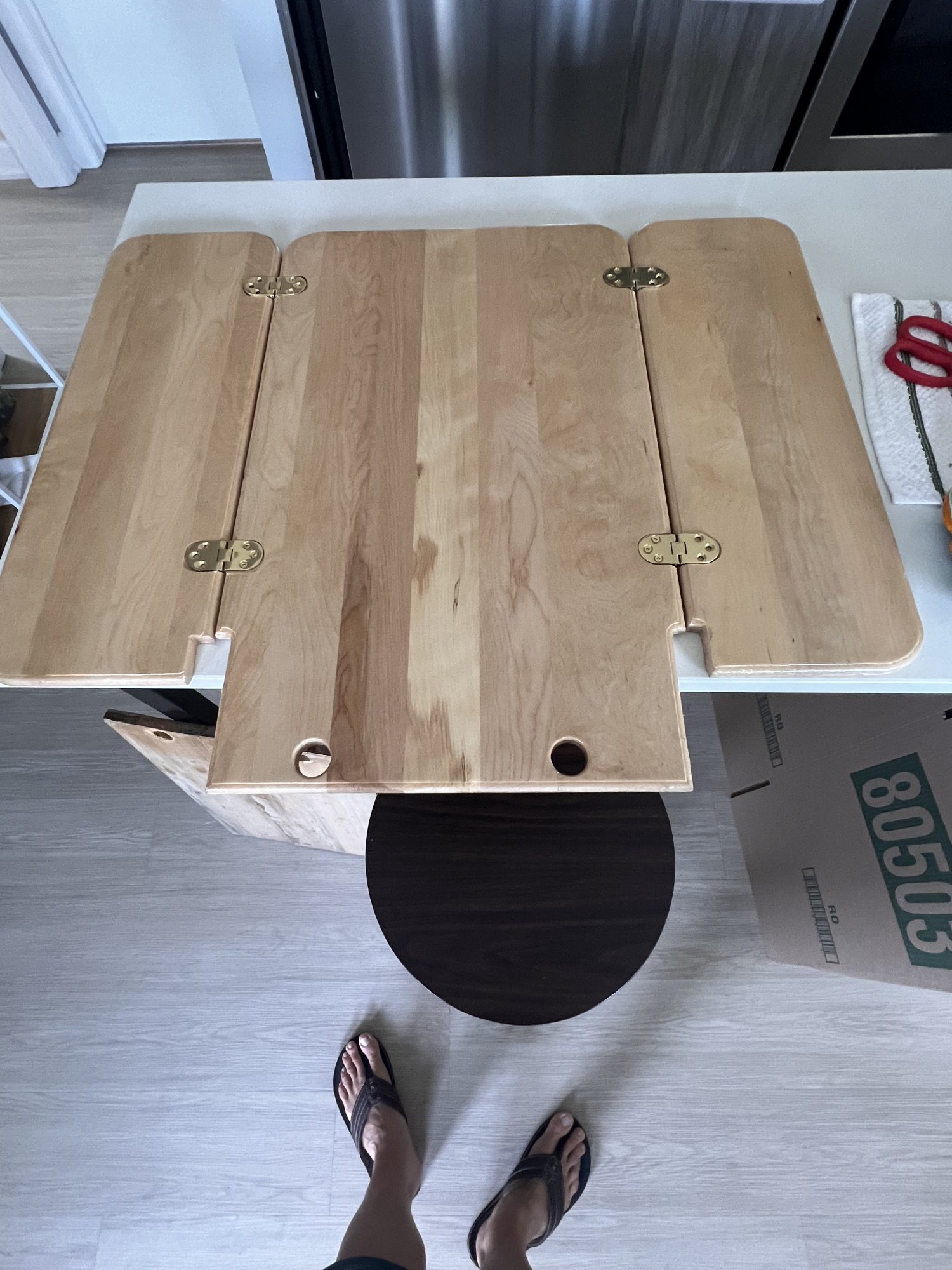

At the moment I’m using varnish.
Still need to pre drill some holes and add the screws
Nice. So, will it not fold down?
Reminds me, I need to get some varnish onto my cockpit table. A stitch in time saves nine, as they say!
