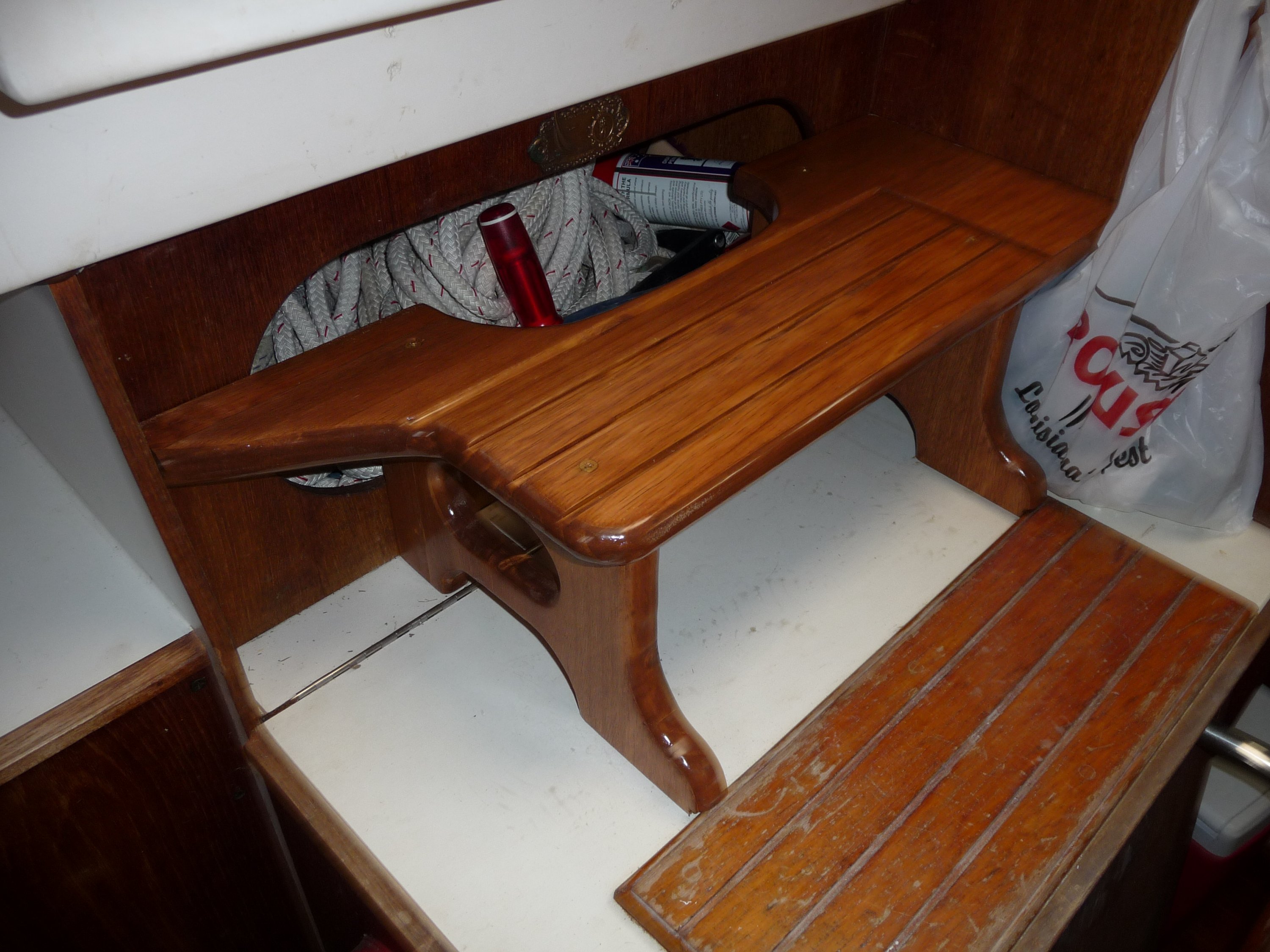

Depot or Lowes has already "bull nosed" oak step planks that work fine for steps in the cabin. You can use a router to make some parallel grooves for traction.. I made this one for my vertically challenged wife.. the Hunter 34 has a long step down there.. P1020352.JPG
