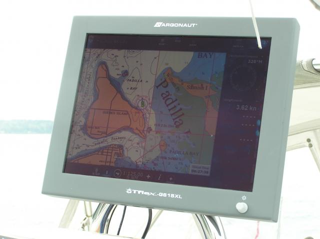

Jeez you could watch the game on that thing, what is it? I have a 3 pod now, with only 2 positions used, eventually the st60 wind will go in the blank center pos. I would have some real concerns with your panel mount in a heavy weather situation. I also like unobstructed views which is why I don't like dodgers.
What is in the far right pos now, is that not the 6002 already?

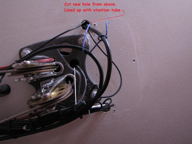

Note
I tried to pull the existing speed cable up thru port side stantion because the old unit was inop.
I could not move the cable up or down.
In fact I could not budge any of the cables.
Found out hours later that there was about 3 inches of solid silicone seal inside the port stantion tube and I could not remove it.
Also found about 1 inch of silicone seal in the hole going down to below.
Had to drill a hole thru deck in line with starboard stantion tube for any new wires.
Spent about four hours trying to remove silicone seal....before I came to my senses.

Paul, It is great seeing you go through all this pain so I don't have to. How did you figure out there was 3" of silicon in there? Is this standard (I am thinking of your other fun with the extra large pin on the wheel brake)? I am assuming you had to mark the pole, remove the whole thing and then drill. Ray

I used a snake from below deck and going up thru existing wire hole tried to push it thru and was blocked.
Went up on deck and tried the snake down thru existing wire hole in the stanchion tube and was blocked.
I unscewed the stanchion to deck collar fitting and found the problem with the silicone.
If you have to drill another hole let me know and I tell you how I did it.
