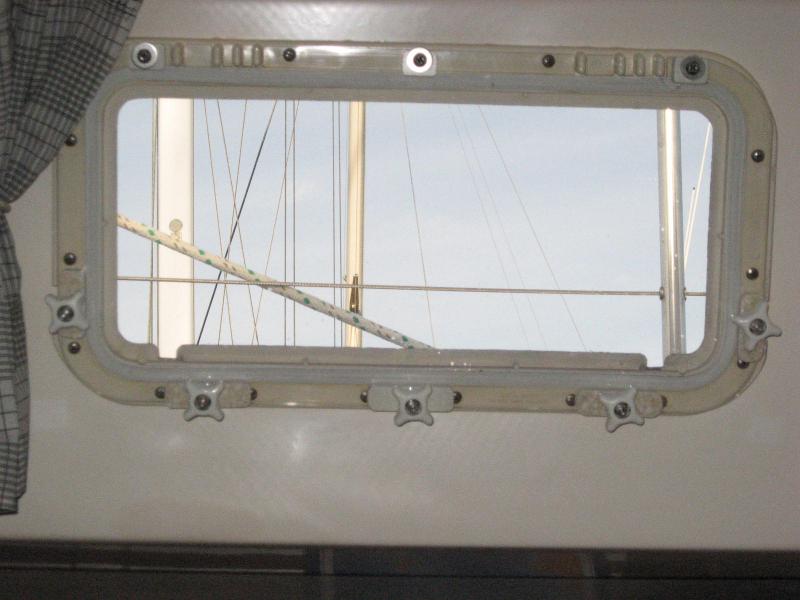

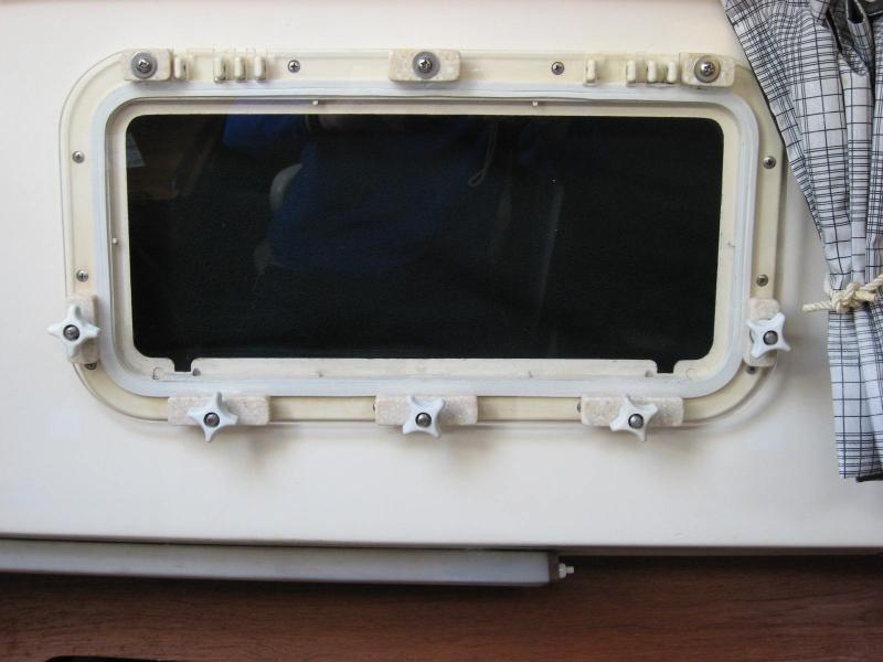

But since I have now completed my DIY alternative, I thought to post a couple of pictures. This project took a LOT of time to work out the design, fabricate, and install ... particularly since the band saw was at home and the port frame is attached to the boat. Even then, to get the right fit, I sometimes felt like a dentist who needs to slowly but surely grind away a bit at a time to get a new filling or crown to fit just right. (My grinding tool was a Dremel rather than a high speed water cooled diamond tooth drill.)
For the future, I can use the current plexiglass cuttings as templates. So doing new plexiglass will go much much faster.
My lenses do not swing open anymore, but they still use the existing dogs and frames. So removal is very quick.
After a couple rain storms -- no leaks.
My cost for the four port plexiglass, gasket material and some SS hardware was about $80 verses maybe about $220 including shipping for the real thing from SBO. I had miscellaneous stuff hanging around which would have required more $'s if I needed to buy. I chose clear plexiglass. Smoke colored plexiglass would have raised the cost to almost $100 vs SBO's $220. I estimate at least 40+ hours for my DIY project from trips to the plastics shop to clean-up. So guess my time was worth only $2-3 per hour -- with no benefits!

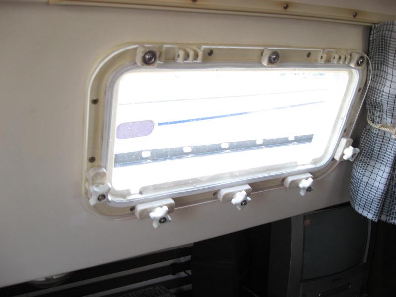

Very nice result Rardi. It would be helpful though if you could add a third picture, one of just the lens laying aside. I have trouble seeing the frame of the lense. I see that the hinges are gone but is the lense frame original?
Jun 21, 2007
2,118
Ed:
Maybe this view shows the plexiglass DIY lens better.
Yes, the frames are still original. I am hoping that the plastic doesn't get any more brittle than it already is.

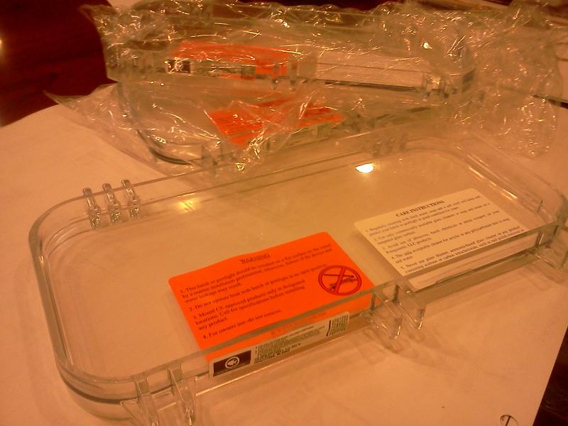

My new Grey Port lenses are here!!
My boat had 6 new large grey ports already when I purchased the boat, however my 4 smaller ones were yellow and had many cracks. The P.O. had glued contact paper over the lenses to afford some privacy and sun shade. Thanks to your postings I found them in the H.O store at a very reasonable price.
I ordered one ( 512 ) just to try it out and it fitted pecfectly so I ordered 3 more. Screw with butterfly nut was no problem. Had to build a small tool to push the other pin out. Also ordered several new knobs for the dogs. The new ones dont have a treaded brass insert as the old ones. (the plastic knob spins over the brass insert). My list is getting shorter:dance:

By your pictures, looks like the SBO port lenses are dead ringers for the original. Your new ones probably will outlast your ownership of the boat!
Yeah, bummer about the old dogs nuts with the brass inserts failing. Probably water over the dam at this point for you, but you probably encountered that removing the old knobs can be difficult. After threading on the original dogs, it seems that Gray "distressed" a bit of the thread at the very end of the bolt presumably so that the knobs couldn't fully un-threaded and maybe lost. On my project, I had to remove all of the knobs. The original ones (with the brass) felt like they would fail if I torqued too hard against the distressed threads on the bolt. So I had to grind off the distressed segment with a Dremel cut off wheel. Both to remove and then put the dogs on again. Took time, but it was the solution.
